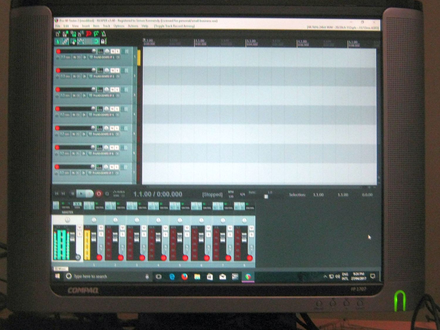

    I'll post a pic of the Compaq Presario PC shortly for you so you can see what it looks like, stay tuned.
    And here it is, the LCD Monitor,Keyboard, and Mouse you see in the pic are what I scored with the computer:
    I ended up going with my spare ATI Radeon HD 4870 512Mb Graphics card and installed it in the Compaq PC prior to taking the above pic.
