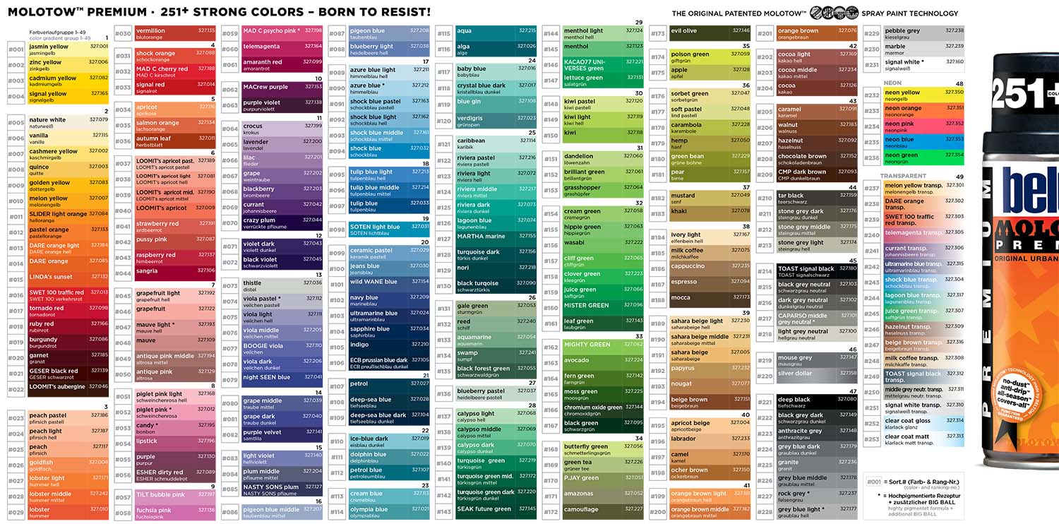

    Was thinking of a colour scheme for my 2nd guitar...a 60's tank cruised by me in Bentleigh.
    It was a 'salmon' colour from the same era as the FB Holden.
    Ironlak didn't have it in their range and discovered another brand aimed at the graffiti crowd.
    'Belton Molotow' range.
    Got it from a shop called 'Union Heights' in Chapel st. Windsor.
    They also carried 'Ironlak' and seem to stock a comprehensive range from the colour swatch.Click image for larger version.
Name:	Molotow Paint Swatch.jpg

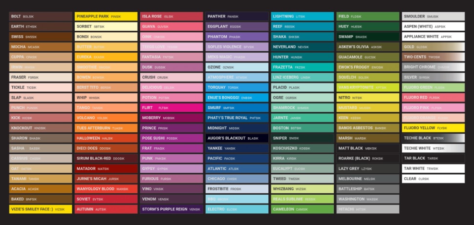

    Here's the Ironlak Colour swatchClick image for larger version.
Name:	Ironlak Colour Swatch.jpg

    Sure, I found out that Ironlak 'Frezzeta' doesn't go well with Feast Watson Wipe-on Poly.
    It dried but there was some areas of blistering and the whole thing peeled off like sunburnt skin.
    Took advice from the youtube 'Brad Angove's' view on using the same brand clear.
    Re-sprayed it with Ironlak clear acrylic and it's a winner.
    Feast Watson stuck to the Molotow quite O.K. though.
    cheers, Mark.
