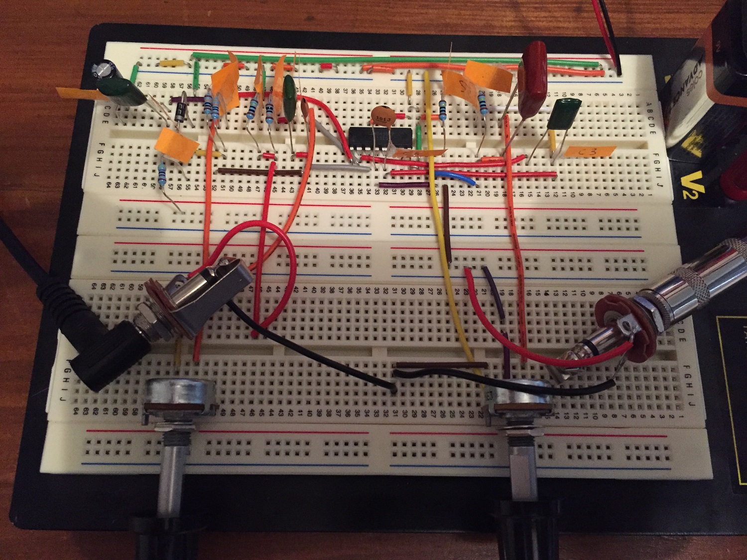

    Hey Guys.
    I am a novice pedal builder but have a burning desire to demystify the ever elusive guitar pedal.
    I have build a couple of basic boost and fizz pedals (I'll share when i have time), and now its time to up the stakes.

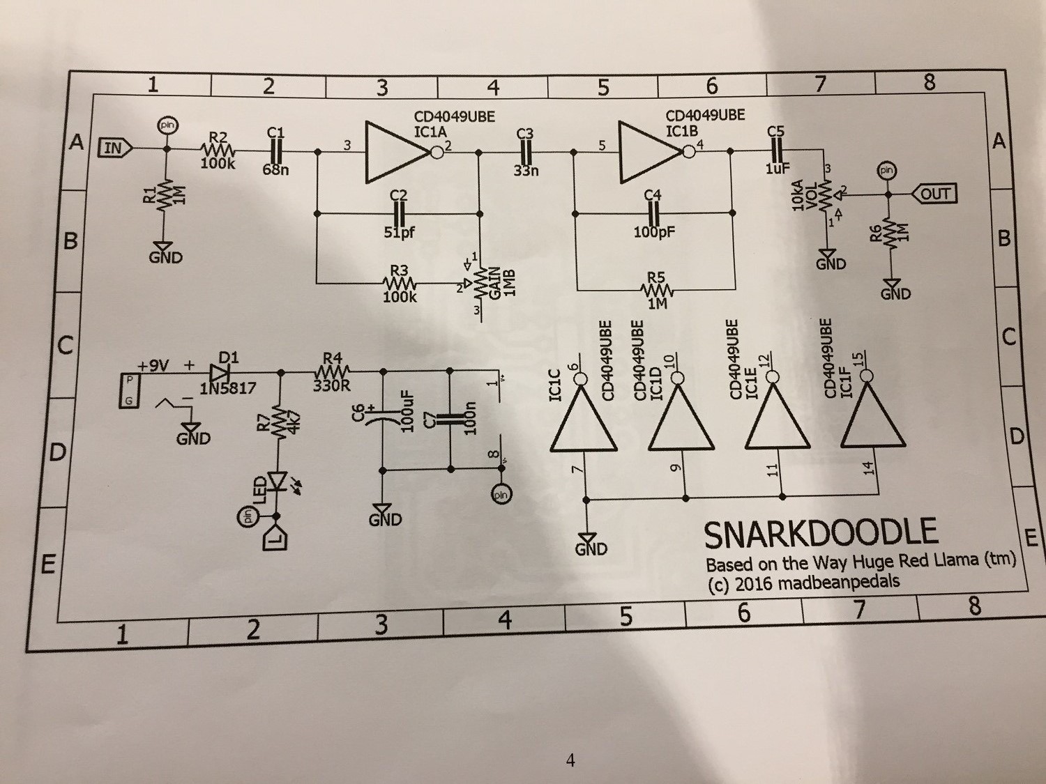

    This weekend I'm attempting to start my take on the Madbean Snarkdoodle (Overdrive Pedal). apparently its based on the Way Huge Red Llama.
    No, i am not ordering the PCB or any of the parts as a kit. I'm pointing this out of the ballpark and attempting to etch my own board and source all of the parts from my local Jaycar supplier.

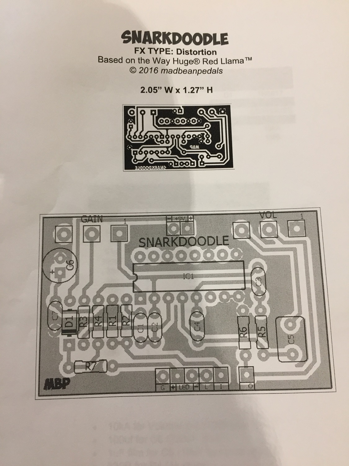

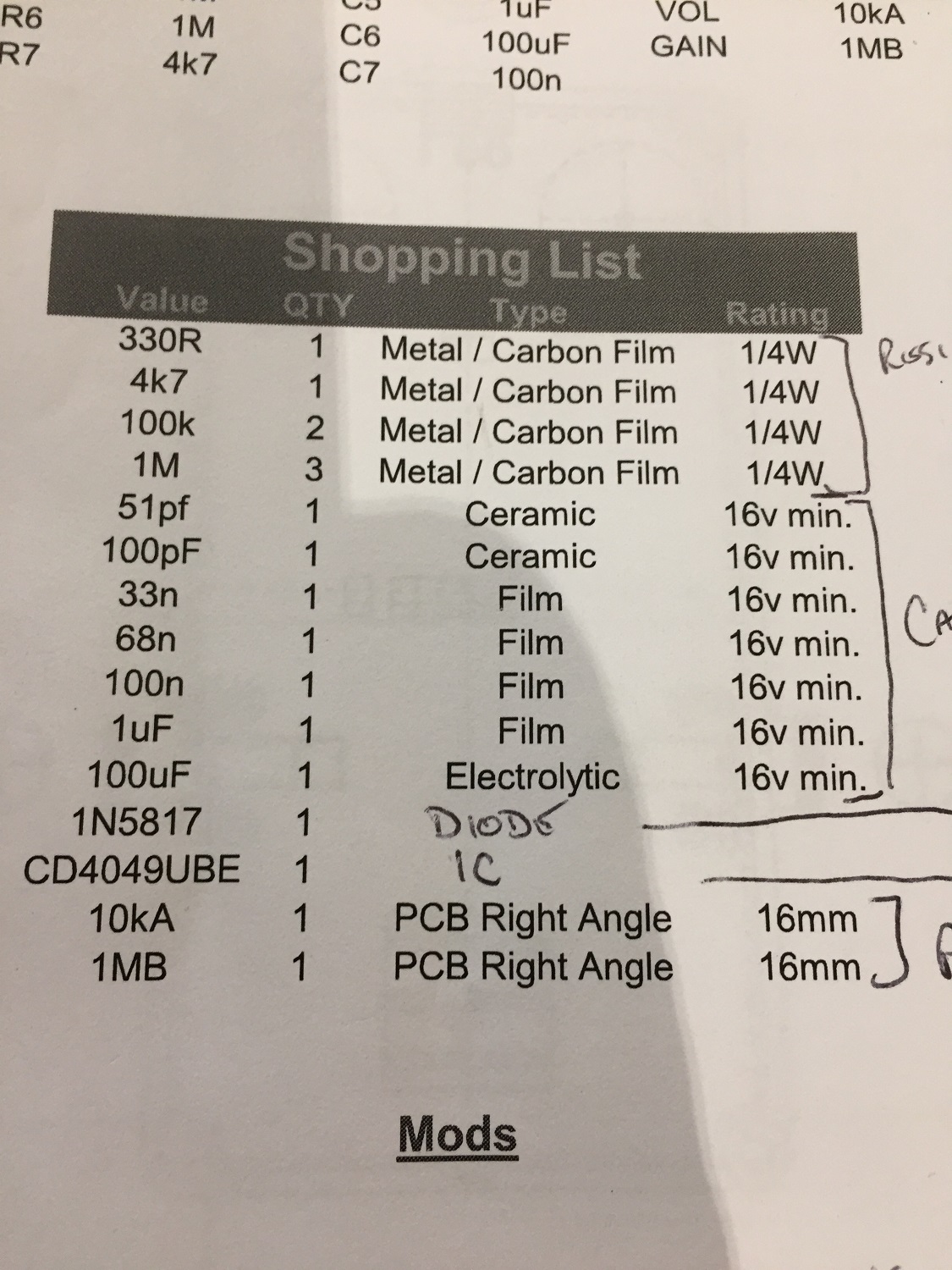

    The Build of Materials, Schematics and PCB layout can be easily downloaded from Madbeanpedals.com

    So printed the PCB layout onto magazine paper (found a use for 50million wife magazines!). I just had to tape paper on the top and sides so that it would go through the printer.

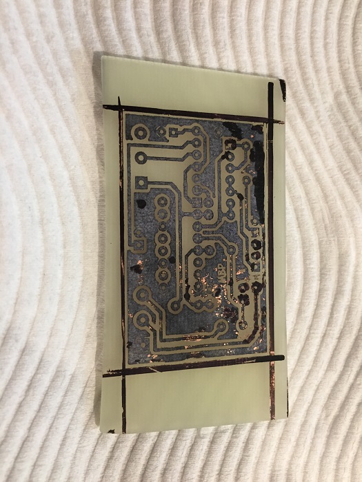

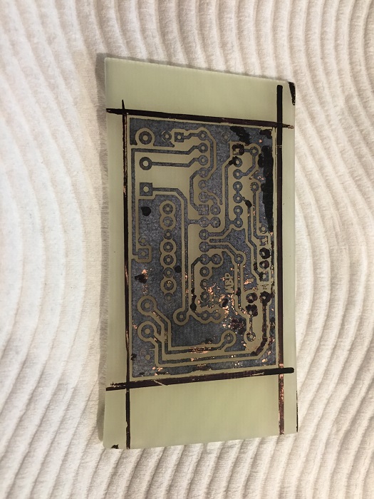

    Then using the wife's iron (ha ha chauvanist) I transferred the image onto copper electroplate. Then soaked and removed the magazine paper.....it came out a bit dodgy, so i had to fix it with marker.

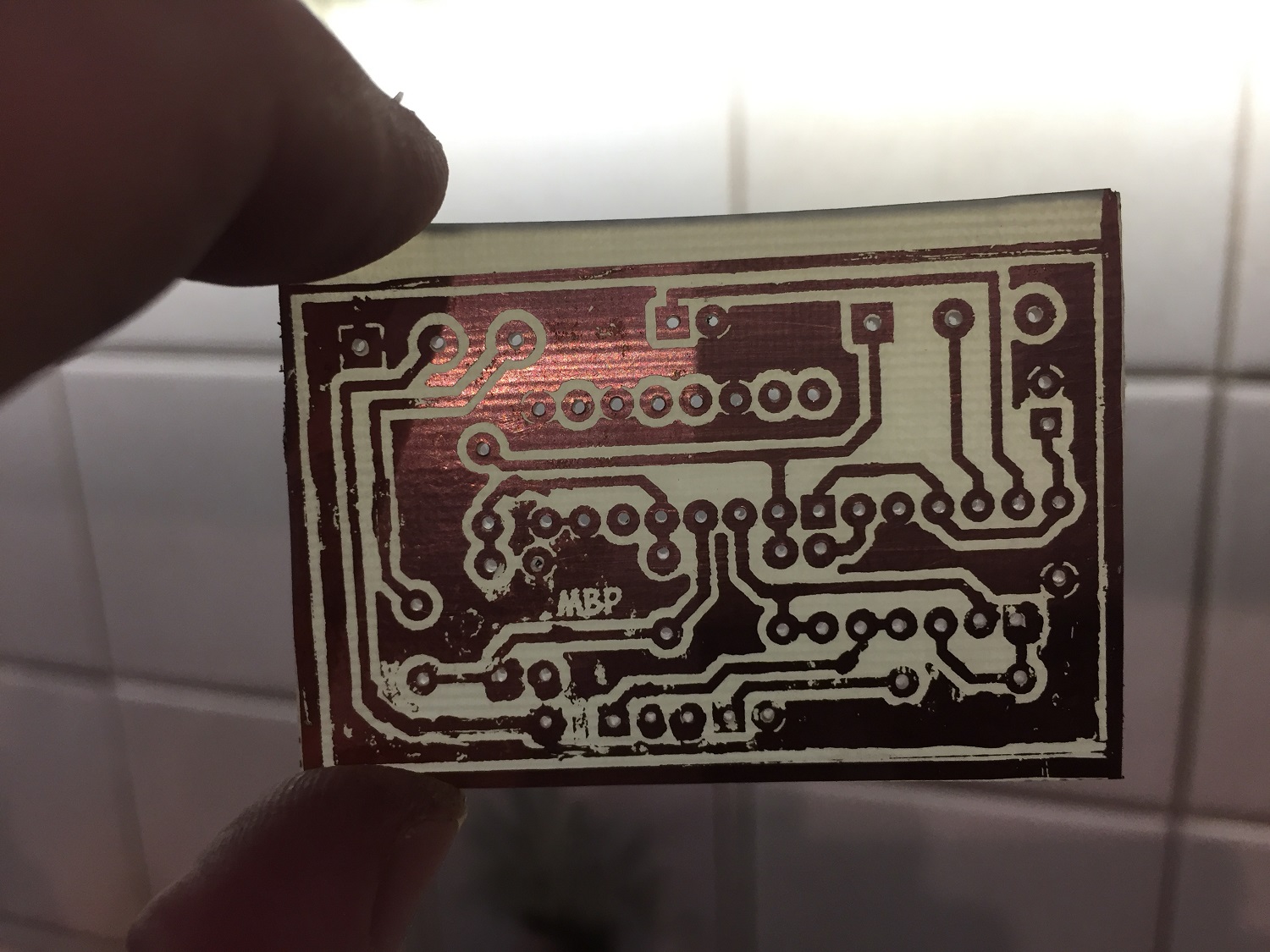

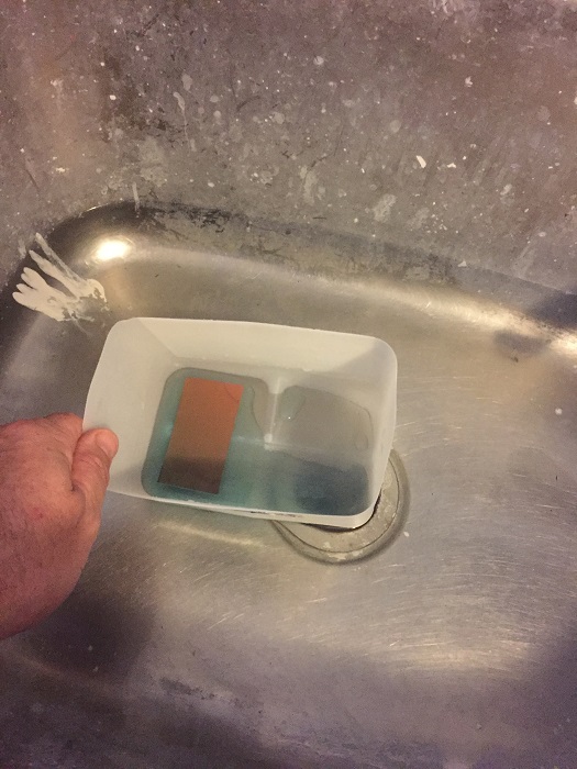

    Then, ammonium Persulfated off the copper and voila
ID:	18885Click image for larger version.

    Cleaned with Epoxy Thinner (its just brutal trying to clean with turps) and drilled.
