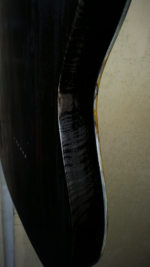

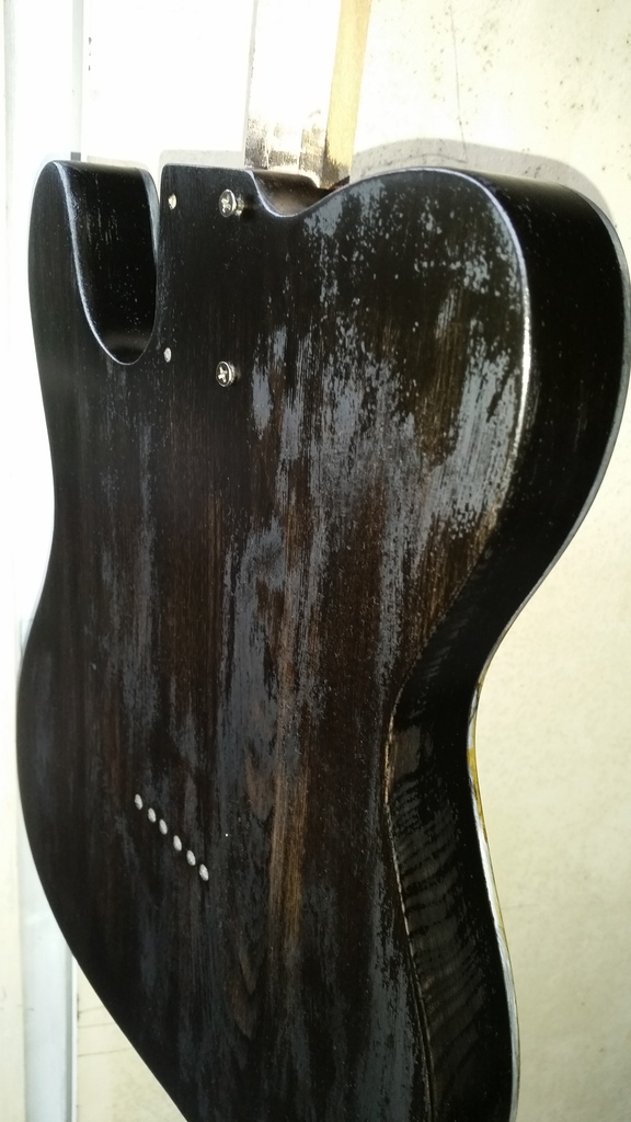

    More weirdness with the BS, this time the intensifier.
    After applying the intensifier around 10 yesterday morning it looked nice and glossy, still looked the same around 6 in the evening, but today it has developed a number of dull patches these are not in the same place or size as the previous ones so I doubt that it related to sap or moisture in the timber.
    Seems very strange because I didn't have the same issue with the CG stain and intensifier on the top.
    At least the BS is on solid timber so I can sand it right back if that is the recommendation, but if that is the case I would be worried about a reoccurrence.
    The alternative is to take it back and spray it with black acrylic.

    ...and that is completely different weirdness to the weirdness I had with the black stump.
    Possibly a job for DB? Was it a New batch of BS?
    Its pretty humid at the moment DK, thats usually the work of humidity plus a little too much intensifier. again, your not going for a glossy finish at the intensifier stage, so as long as you sand down any lumps and keep truckin' it should be fine.
