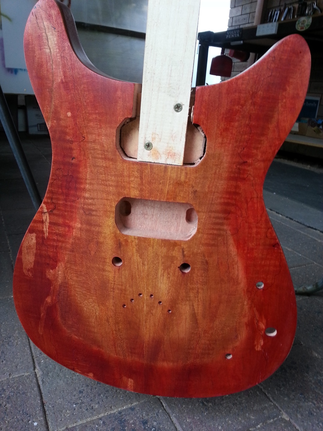

    Here's an older one as well. Haven't done a veneer guitar for a while.
    BP
    Oooh, that was a bad one, Brendan! Looks mainly like seepage through the veneer on that one.
