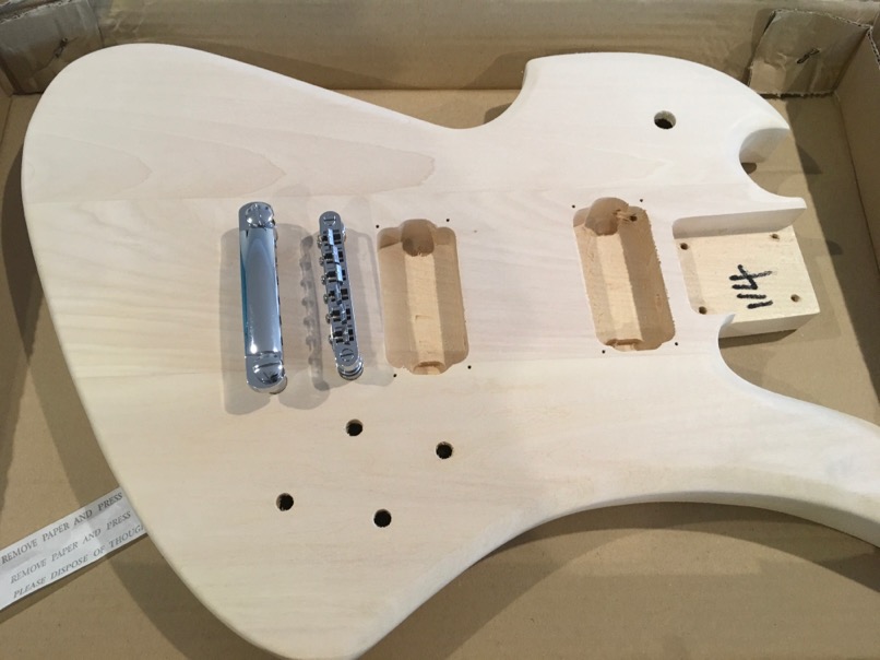

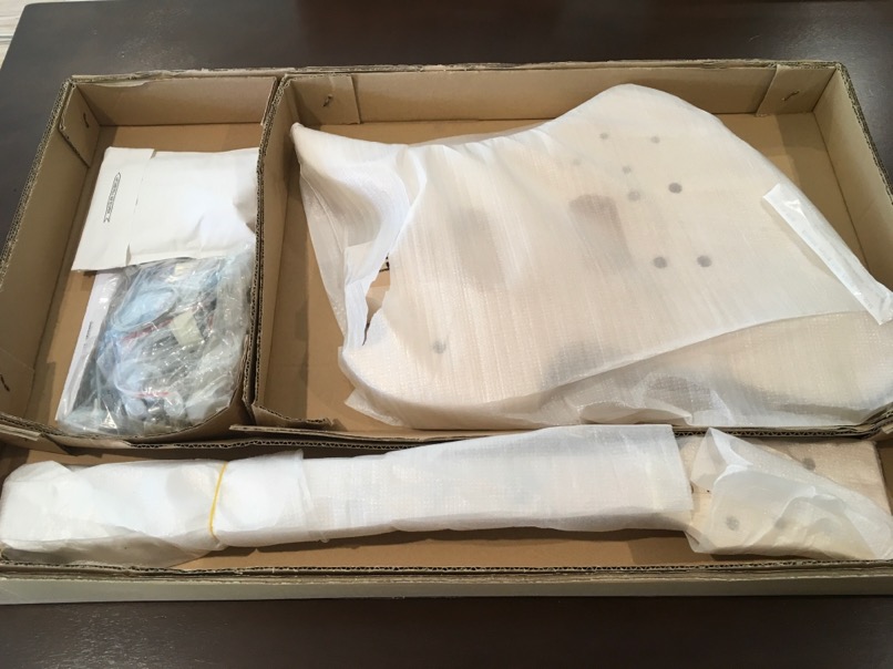

    My MB-1 showed up today so I'm keen to get stuck in.
    I was after a different looking guitar so picked the MB-1. I did plan on changing the shape by shortening the bottom horn and reshaping the top a bit but now I have it in my hands I think I'll leave it as it is.
    First go at this type of thing so it will be interesting to see how I go. I was planning on a satin black finish but I'm now considering a black stain and gloss finish, so I'll think that ever for a few days whilst I get my sanding on.
    Unopened box...

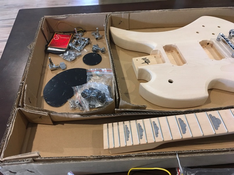

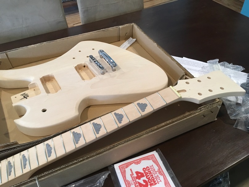

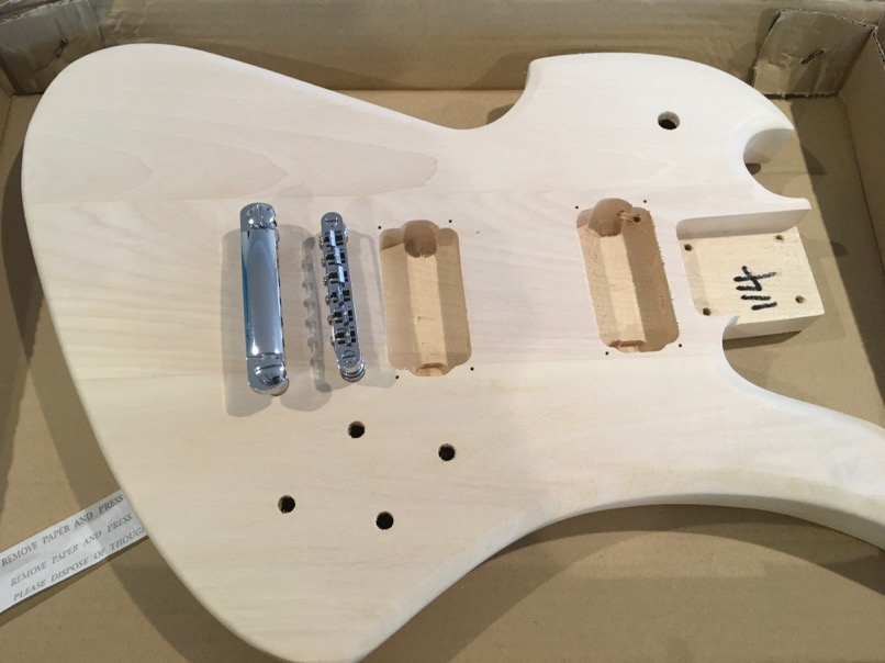

    First look...
    Edit: photos added

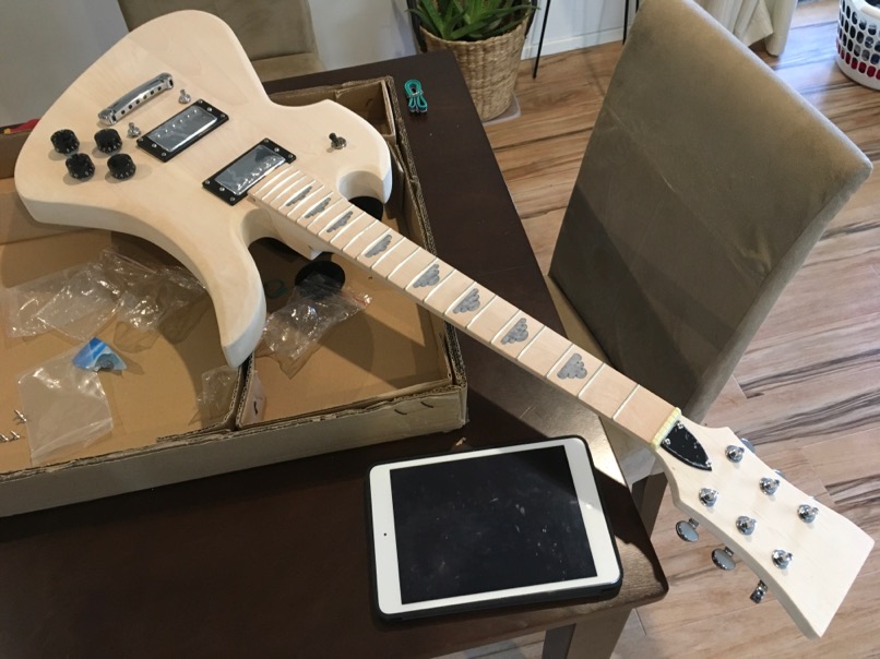

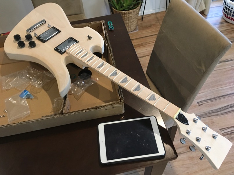

    How far do I need to take my mock up? Do I need to put a couple of strings on?

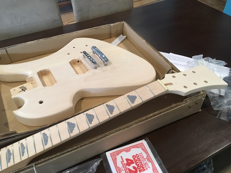

    How good are these fretboards as supplied. I like a pretty low action, can I get that with the neck as supplied or should I give that a seeing too before I get too much further?
    More questions, sorry!!
    The fret markers appear to be painted on. They look ok but I'm concerned they'll wear off. Should I sand them off and install plastic dots or similar?
    Cheers in advance, Robbo.
    Hey Robbo.
    The good news is you can set this one up however you like. if you want lower action, its not too hard to set it up that way, but probably concentrate on building it first.
    As its a bolt on neck, I would string up the high and low E strings and centre the neck before drilling the neck bolts. rather than putting the bushings in for the stoptail (you want to finish the body first) get some rubber tubing to hold the posts in place and put the stoptail on when doing the mock string up. Alternatively, you can finish the body and neck first then worry about drilling the neck holes when the bushings are in place.
    The mock build is just to check to see if you have all the essentially bits and bobs. and make sure everything fits.
    If you intend to do any modifications to the kit, my suggestion is to do that before finishing the body and neck.
    Good luck mate, good to have you with us
    I'd be surprised if the fret markers wouldn't be plastic inlays. They shouldn't wear off.
    Sometimes the frets on the kit may need a bit of work, just use a stanley knife blade as a fret rocker to check for any high or low spots.
    Hey Robbo, as Andy said. I've seen one of those necks and the fret markers are painted on. I would do as you suggested and sand them off and get some nice dot markers.
    You will need to fret level the neck so will need some tools for that if you want a low action but easily do-able
    Keep the questions coming, its the only way you will learn and less chance of making mistakes !
