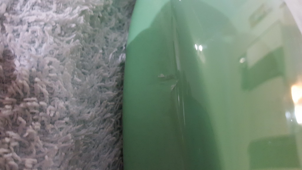

    So the package arrived on Friday. First thing I notice is that there is a small dent in the body on the edge just above where the strap button would go (bridge end). Damn. It's small and not very noticeable but my stupid OCD brain will hate that forever. Here's a shot.

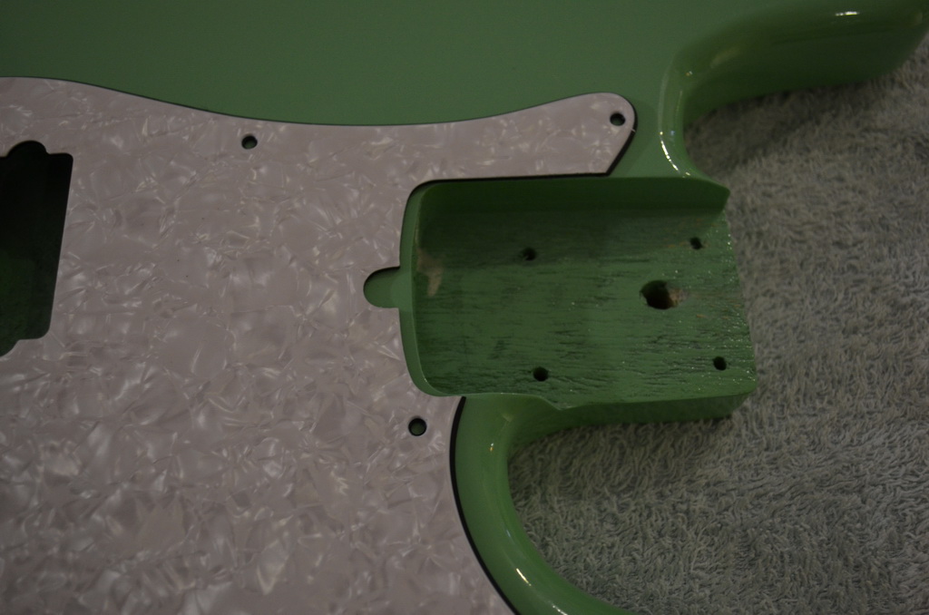

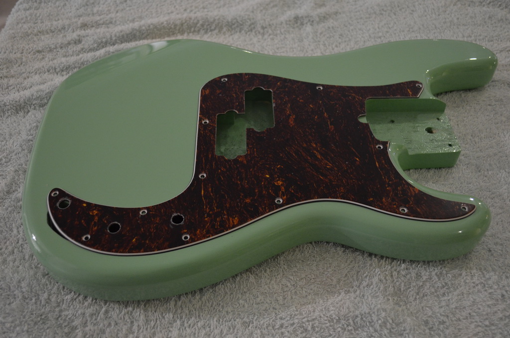

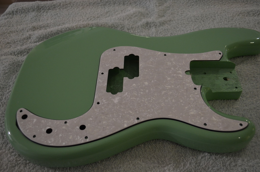

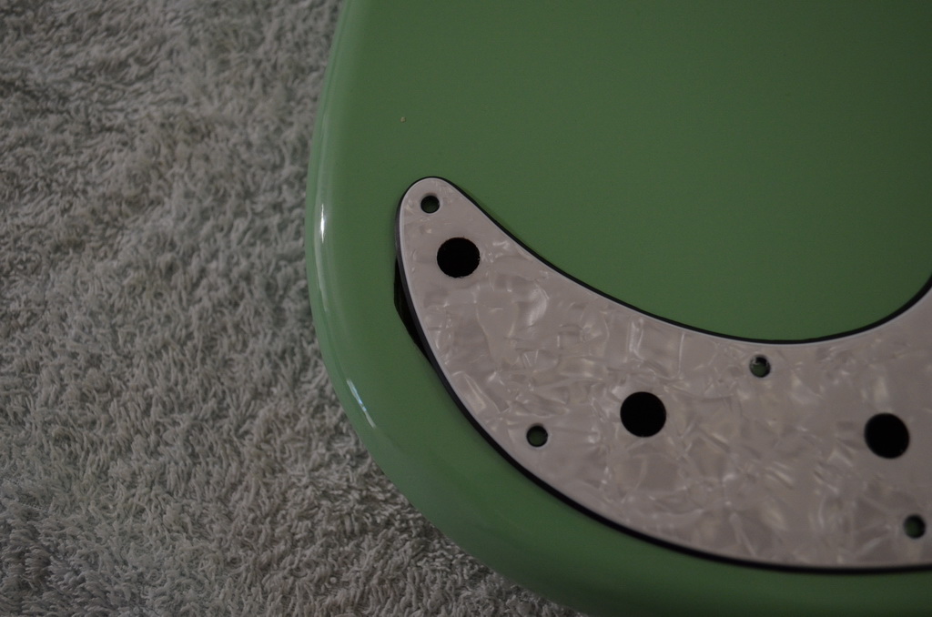

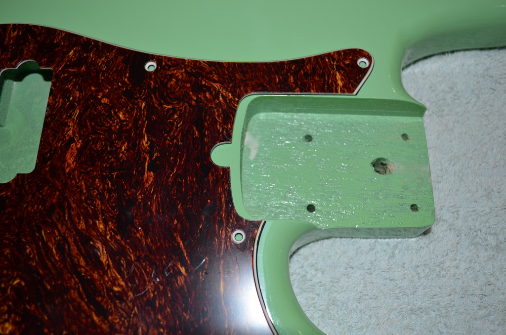

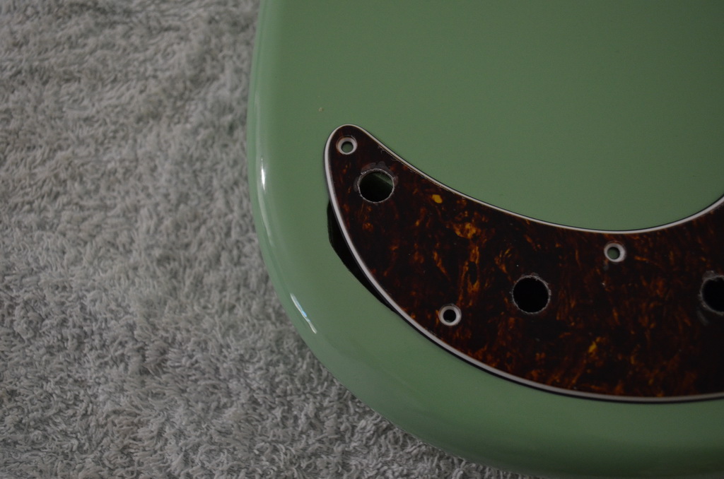

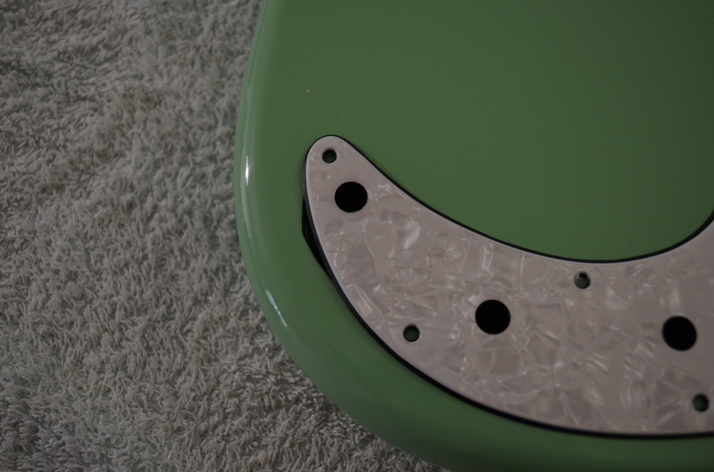

    Secondly, and this is the show stopper for me, is that neither of the two pick guards fit properly. That is, if I line them up so that it fits correctly around the neck pocket, the routed channel for the pots and output socket isn't covered. Yes indeed FFS.
    Here's a couple of shots:

    ...ok so here's a few more shots. As you can see, if I line up the pick guard so it fits over the routed channel, it's at best 3mm short of the neck pocket, which would look shite, IMO.

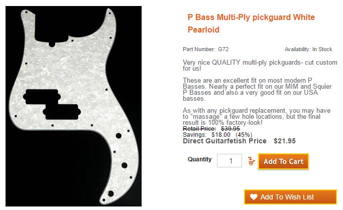

    Here's a snip from their website, the product entry for the pearloid pick guard. The one for the tortoise shell version says the same thing:
    It says that you may have to "massage" a few holes to get it to fit, but there's no way that either of these two can be "massaged" to fit.

    Just get a new pick guard. I'd write to them and show them the photos, they might refund you on the pickguards and tell you to keep them .

    One possible option with the dent (if the location and spacing works) is to fit two strap buttons on the end, at equal spacing either side of the centre line, with one button covering up the dent. It's sometimes done on purpose by makers to help the guitar stand to straight without falling over when not using a stand. I'm currently working on a friend's Taylor T5 Custom that's got two strap buttons fitted like this as standard.

    It is more likely to be a non-standard routed body than two non-standard scratchplates. I had a hard time making a standard scratchplate fit (what was supposed to be) a Mighty-Mite P-Bass body (from eBay), and had to stick some bits of wood in the control cavity for the scratchplate screws to screw into.

    So I sent them an email, stating the issues. Two different people replied. Regarding the pickguards, the first guy says that they're not intended for their bodies, but as replacements for genuine Fender P-bass. I replied and said that perhaps the product page should say that. Another guy replied, saying that if I juggle it around (his words) it might fit. The first guy replies again and says a similar thing. I replied again and said that the photos I'd sent sorta prove that no amount of "juggling" would make it fit.
    Regarding the ding, they were non-committal about how it might have happened. I did say that there was no damage to the shipping box, so it was probably like that when it left their shop. They initially offered 10% refund, upping it to 20% in a subsequent email even though I didn't ask for it. So on a 50 USD dollar body I got 10 back. About 13 AUD. Woo hoo. Better than a poke in the eye with a sharp stick. Just.

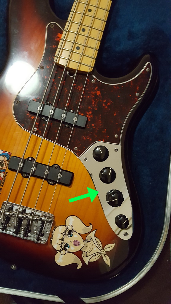

    The other thing I thought about was, instead of getting a custom pickguard made, use the one(s) I've got and convert it to a J-bass style. My J-bass has a metal "tail" (for want of a better term) where the knobs are. And a fair few other Fender models have a similar arrangment. The pickguard is in two parts, one plastic bit, one metal bit. So I thought of getting some brass plate, cutting the pickguard(s) and making a plate to fit over the route properly, and join them up. Only problems with that is 1) not much of a metal worker and 2) would have to get it chrome plated, which would probably cost a similar amount to getting a custom pickguard made.
