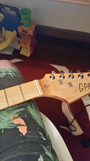

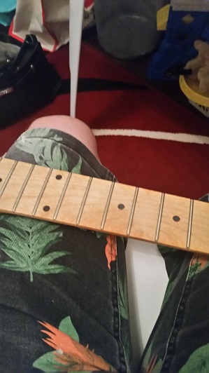

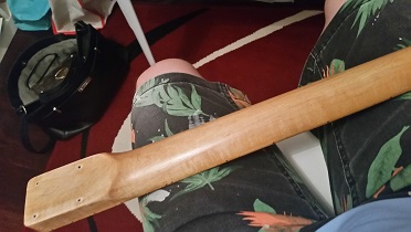

    Also if anyone can help me as to what to do with the neck?
    Feb 2017
    27
    Thanks for the advice Fretworn.
    Finally some photos:
    Feb 2017
    27

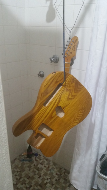

Name:	drying body & neck.jpg
    I learnt not to hang the body like this.

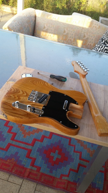

Name:	body assembly.jpg

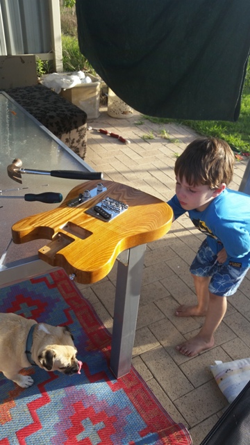

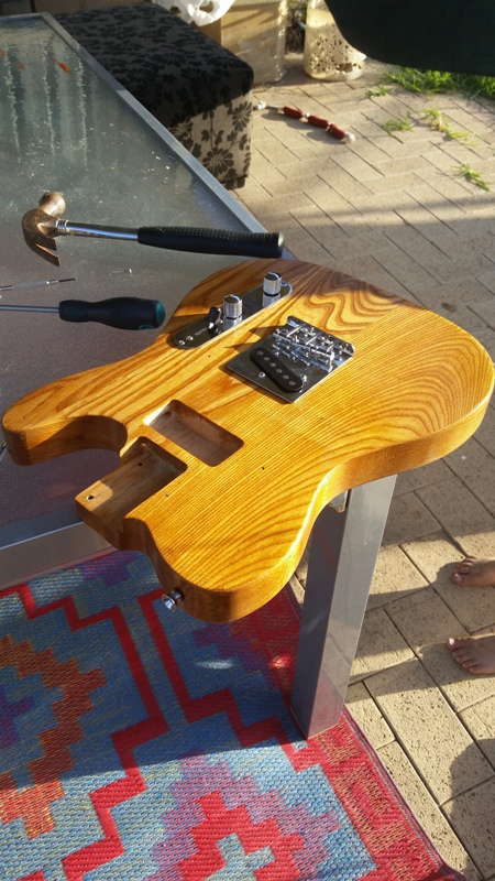

    I had helpers too:
Name:	guitar body with helpers.jpg
Name:	body with bridge.jpg

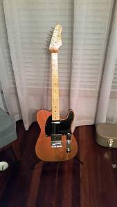

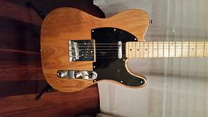

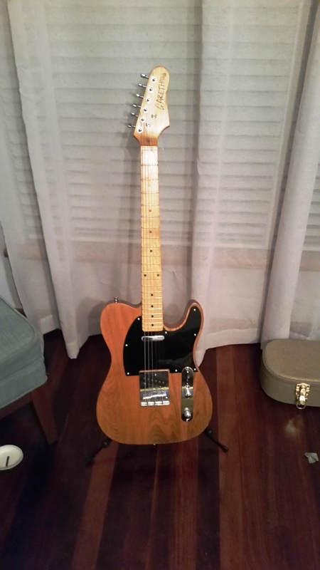

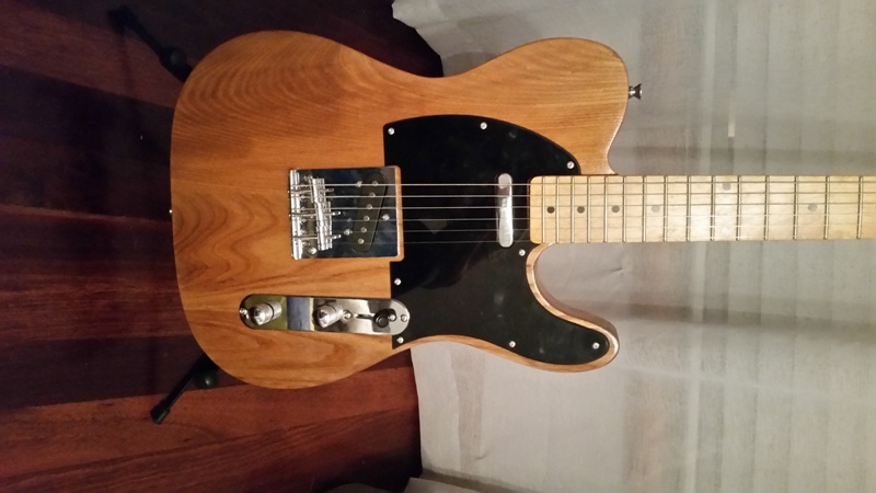

    So I still haven't finished the guitar, but about a week ago I got impatient and wanted to put it all together to have a look, before taking it apart again and continuing with the body and neck:
Name:	whole body strung up.jpg
Name:	Body strung up.jpg
