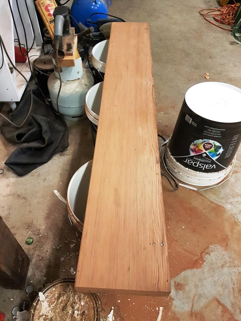

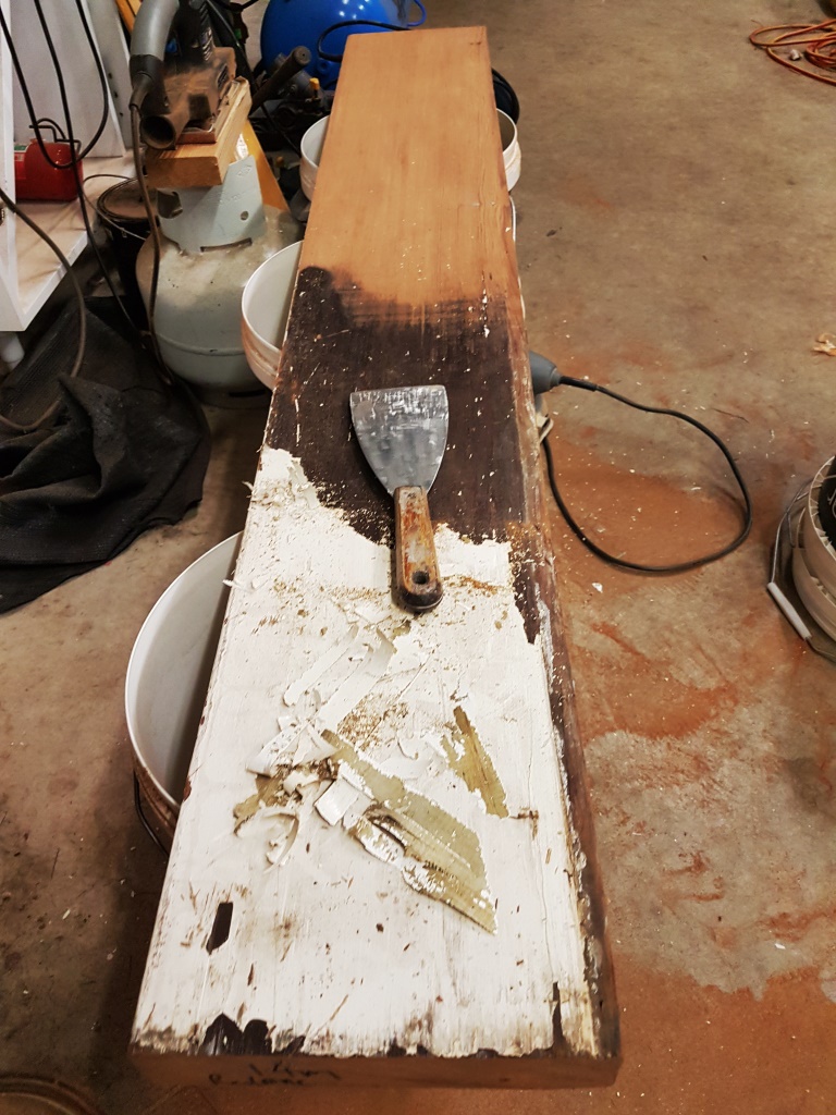

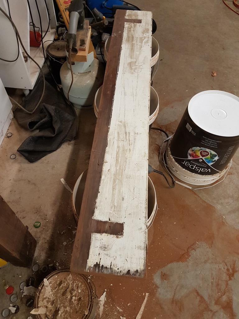

    Old Red Pine mantle piece from a salvage yard, approx 70 years old, covered in lead paint and shellac stain underneath.
    fortunately got hold of a power sander

    Hey Guvna that cleaned up nicely. Hope you were wearing a suitable dust mask, that lead paint can't be good to breath in the dust. Sometimes a heat gun and paint stripper might remove the paint quicker than sanding it.
    I've cleaned up similar looking pieces of timber covered in ugly paint found on verges.
    How thick is the slab ? Should be minimum 35mm to put a jack and control cavity in it

    Hi Wokkaboy,
    cheers for the safety message. Ive worked in the paint industry for over 30 years and have probally had my fair share of lead early on.
    always happy to answer any paint enquirys too, currently working in paint lab as a technician - commercial, indutrial, automotive,domestic
    anyways , slab is about 47mm thick, 200 wide and 1.4mtr long, so ill have to cut that down - extra length might allow for somthing fancy with the design
