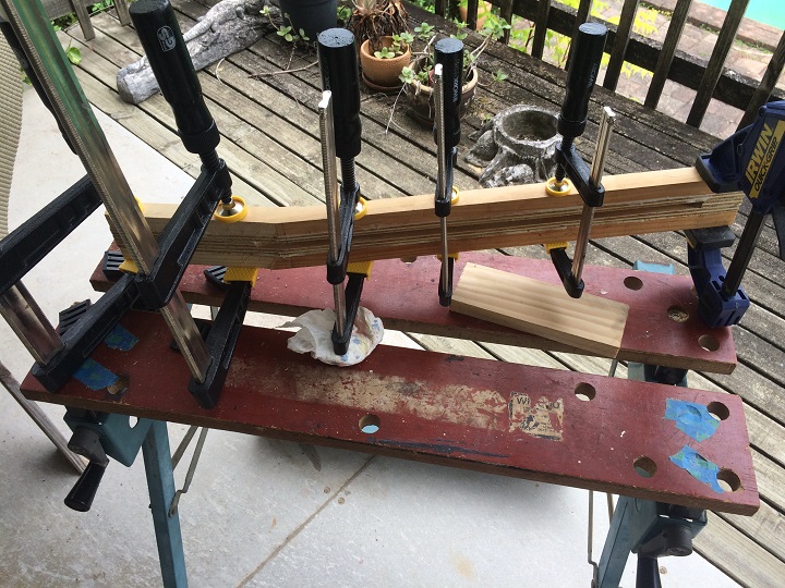

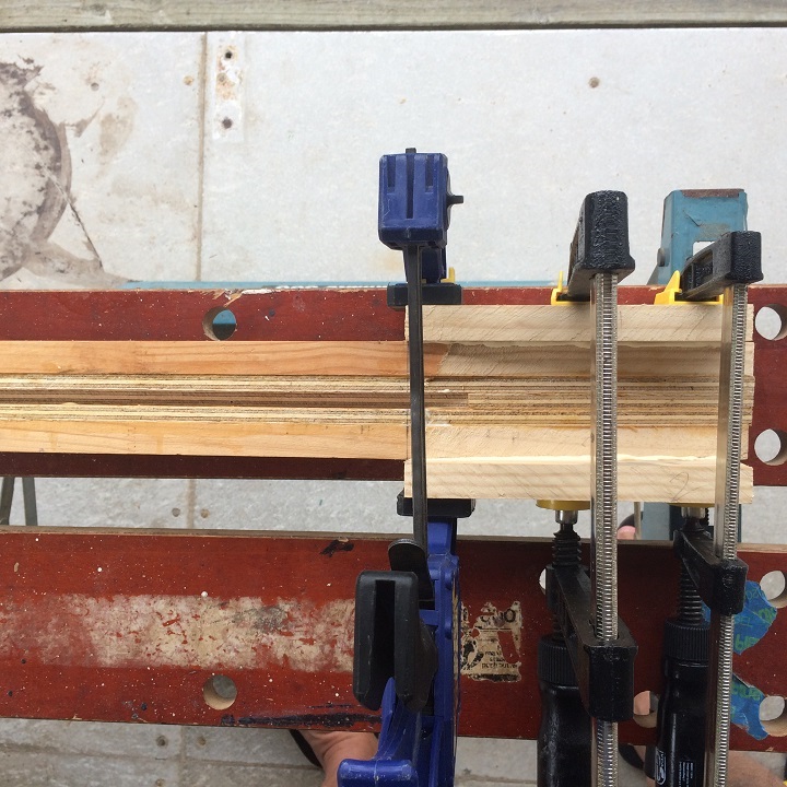

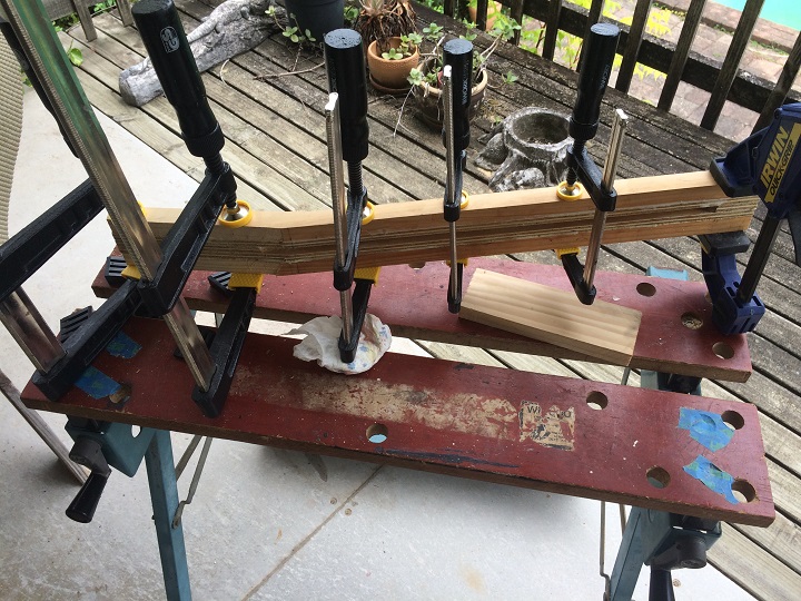

    Glue the lot together

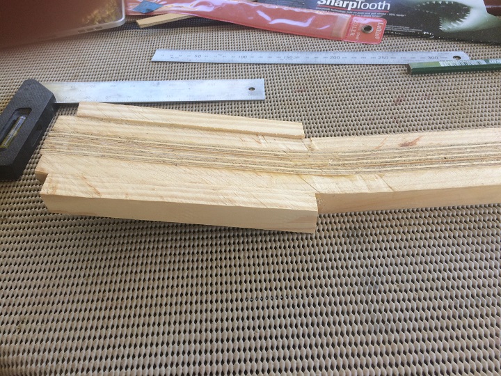

    Add Headstock wings
    And you end up with this monstrosity

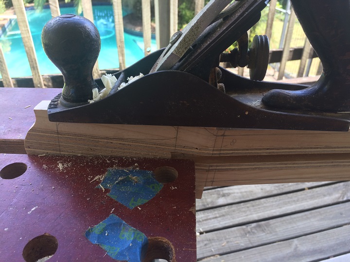

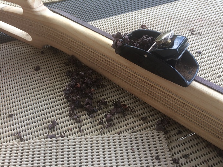

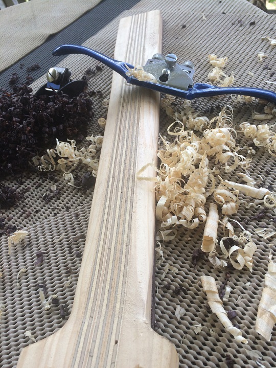

    After roughly shaping the headstock, I used a plane to shape and square the sides.

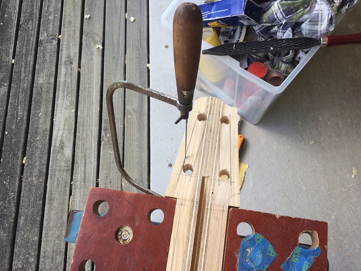

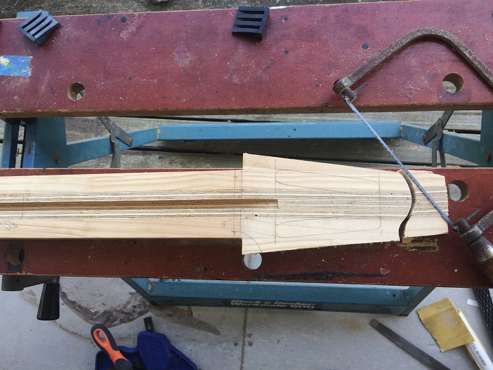

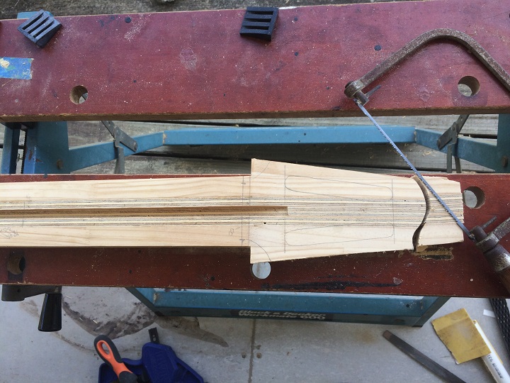

    Used coping saw to shape headstock

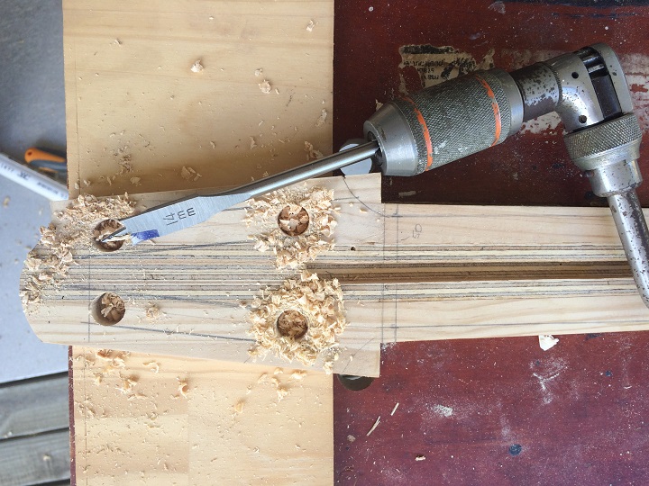

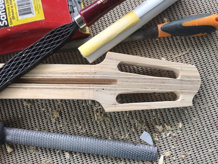

    Drilled starter holes for tuners
    Finishing off the tuner space.

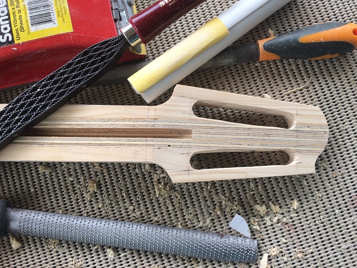

    So that's the Headstock roughly finished, showing some of the tools used.
    Next job will be to glue the fretboard on, and profile the neck. But that as they say, is a story for another time.

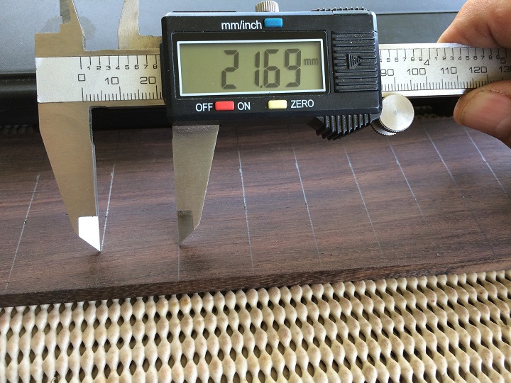

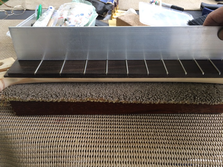

    Looking great Rob. As always, jealous of the skills man. I am interested in how you measure and cut the fret slots so if you could detail that part I would be very eager to read! Do you do it before or after the fretboard is radiused, and what do you measure with?

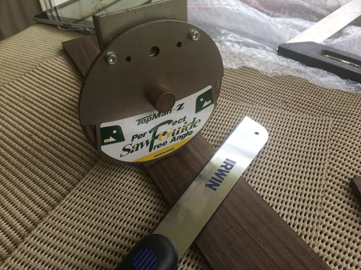

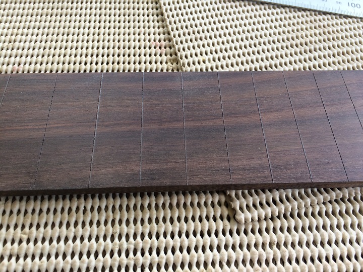

    For measurements I just used the fret position calculator here:
    https://www.stewmac.com/FretCalculator.html

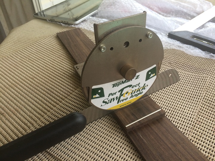

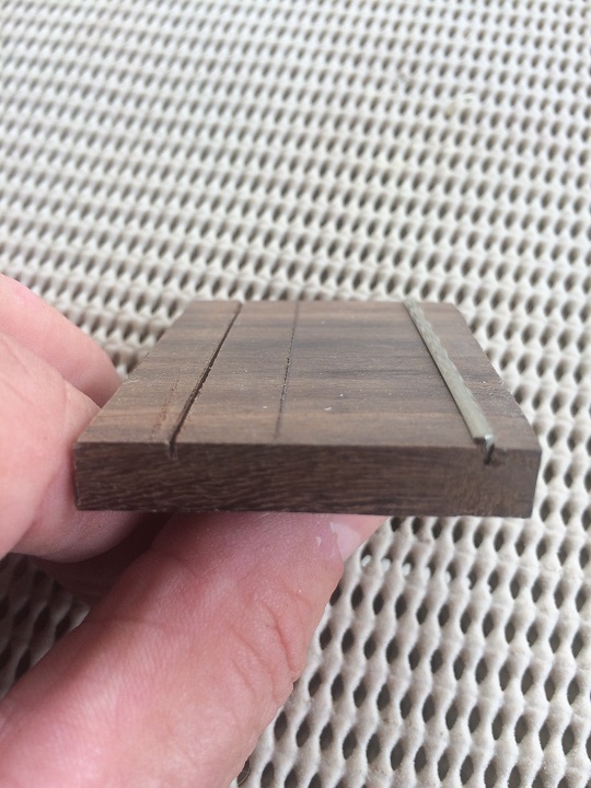

    I don’t own a fret slotting saw as they are too expensive but I did treat myself to one of these:
    http://www.irwin.com/tools/handsaws/dovetaildetail-saw
    I guessed it had a very fine blade as its described as a pull saw. I have tried it out on some scrap wood and I think it must just do the job.
    My bro-in-law gave me some tools he no longer needs and one was a kind of mitre jig. It looks pretty sturdy and accurate so I will be giving this a go. I'll post a pic later.
    Although the fretboard is very low quality wood it is dimensionally very square so I intend to measure and cut the slots before I do any shaping. I will just be using a rule and a try-square. I will have a centre line marked on the FB so I can line it up with the centre of the neck to keep it square then, when glued, trim the overlap to bring it back to the taper of the neck.
    Being based on a classical style guitar the FB will be flat with no radius.
