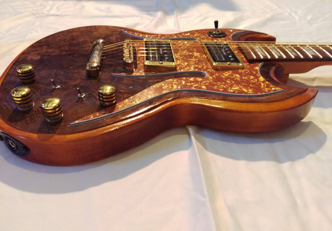

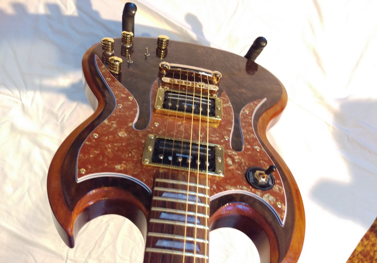

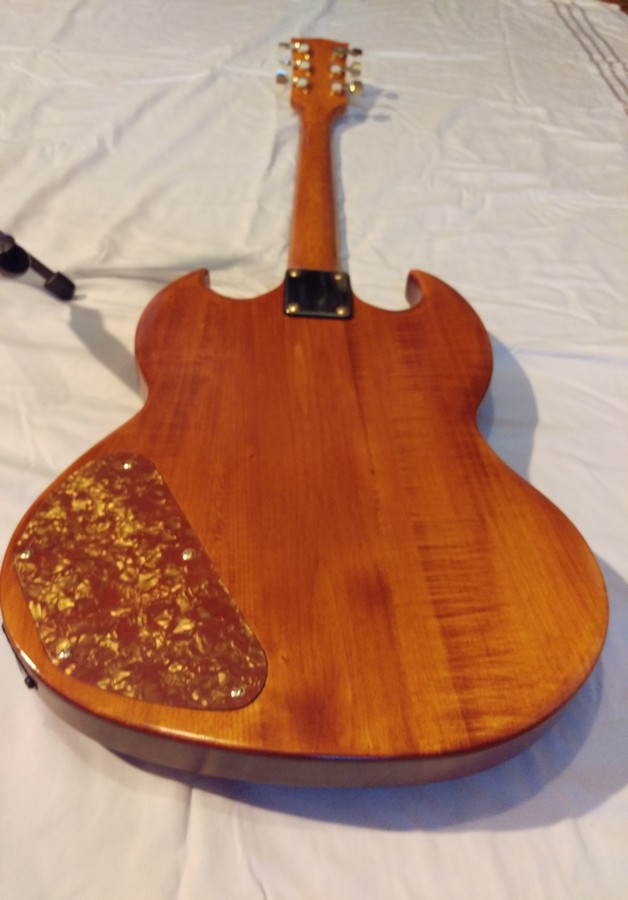

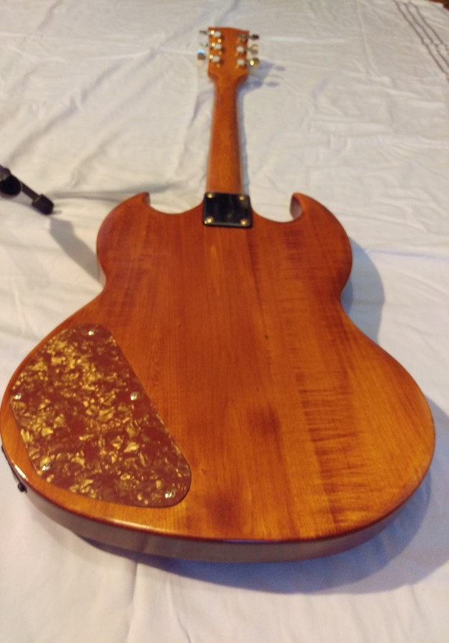

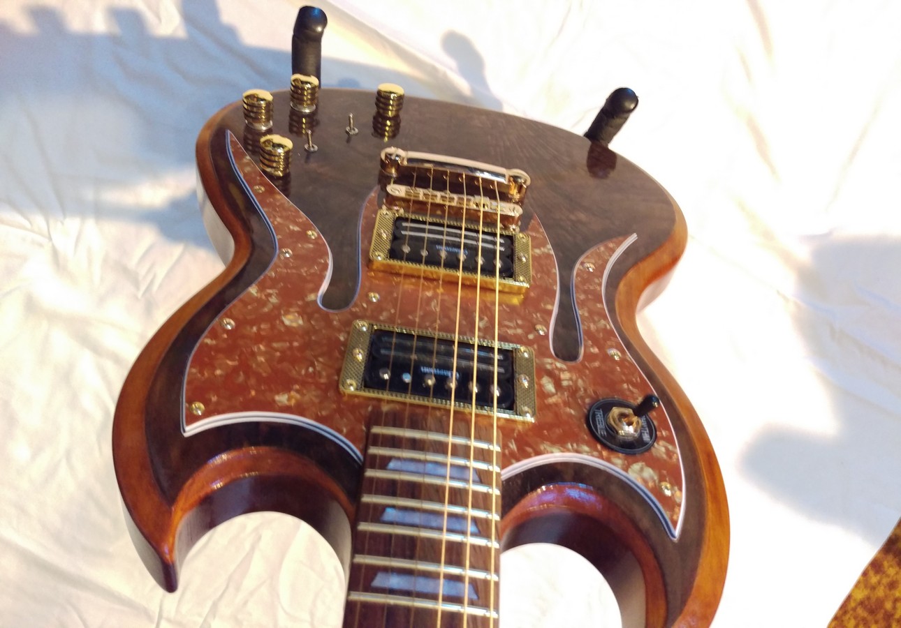

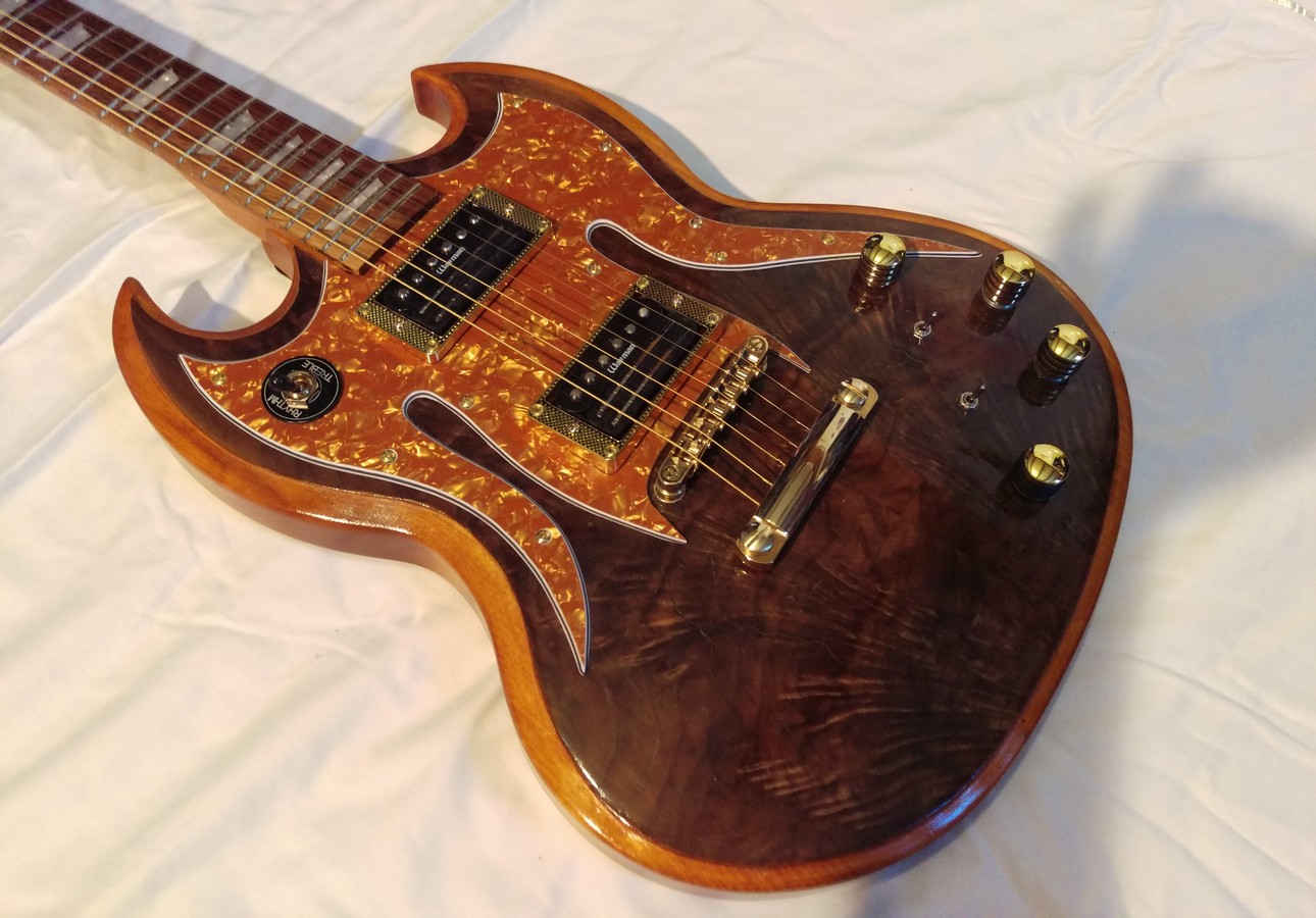

    Its finished

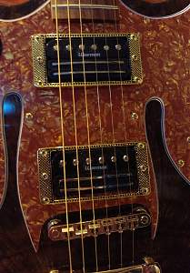

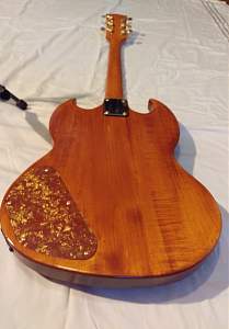

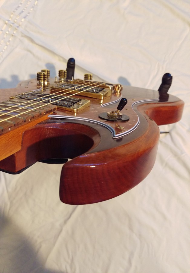

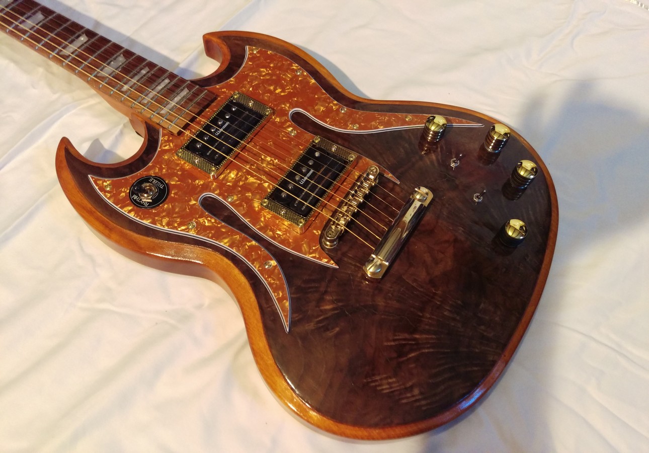

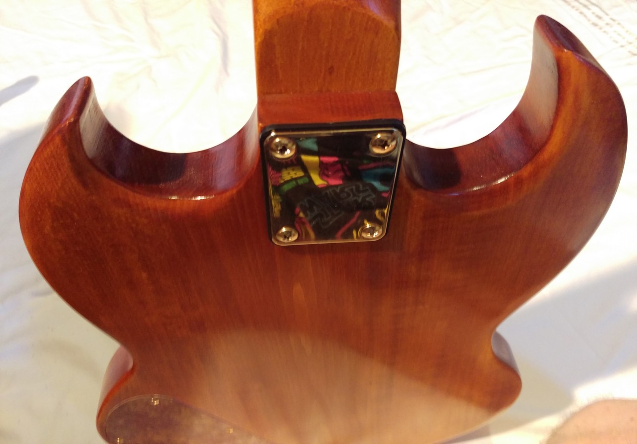

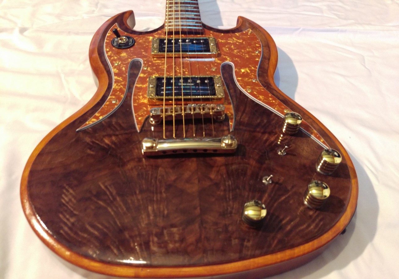

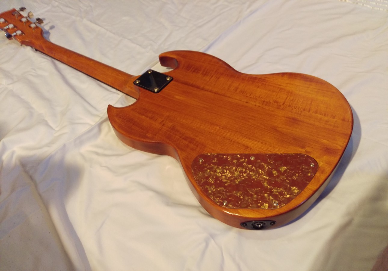

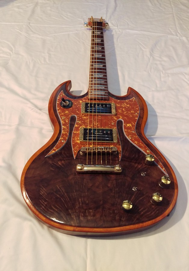

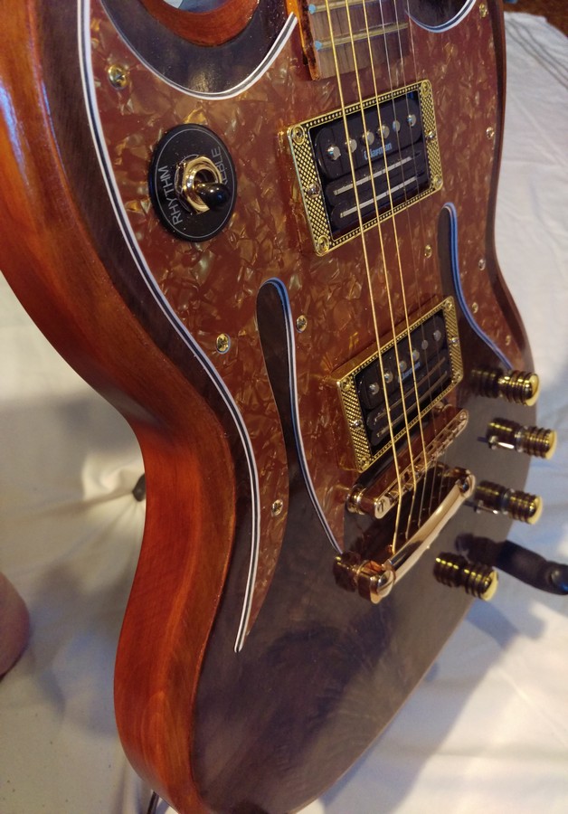

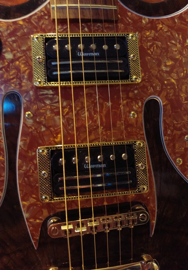

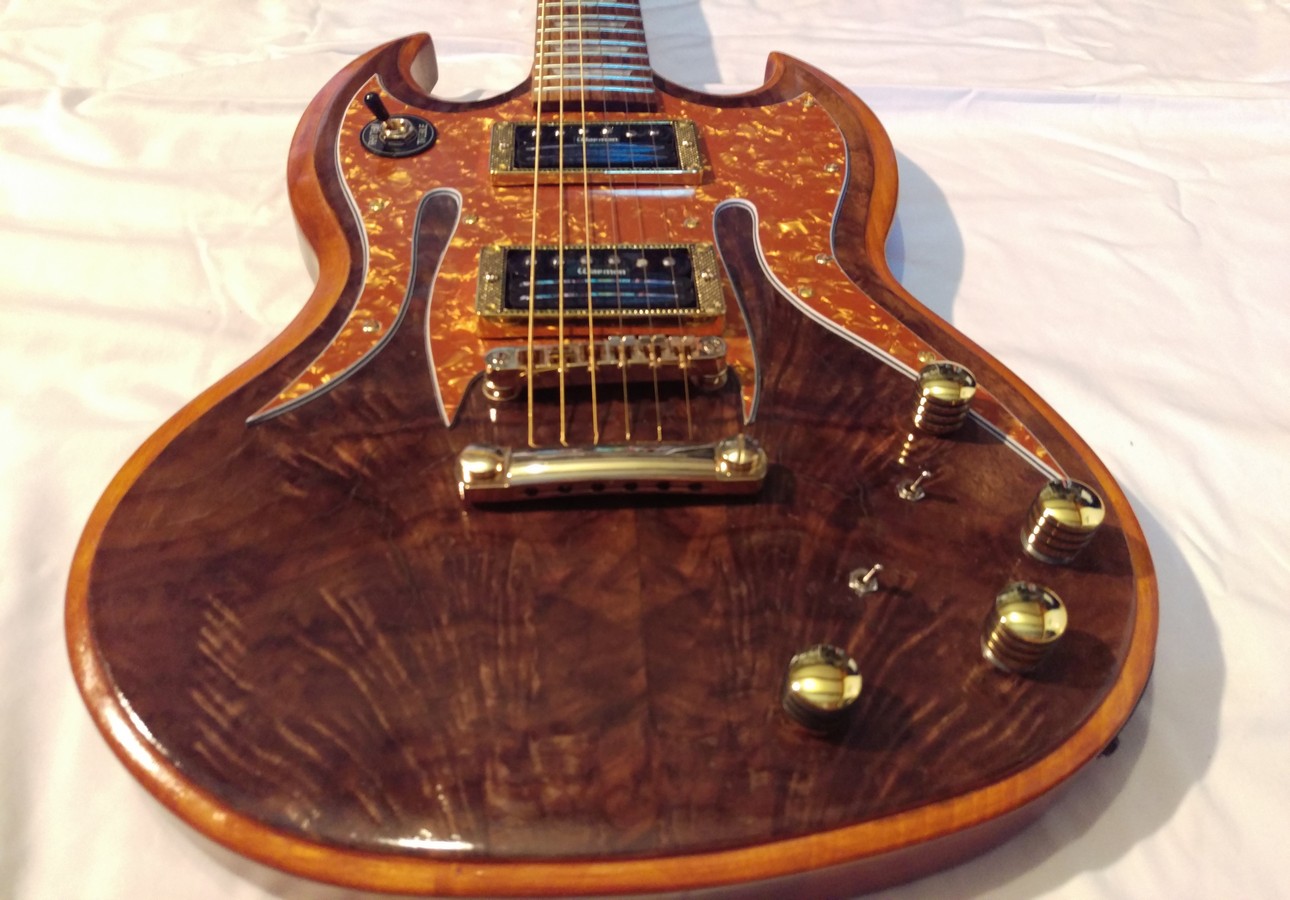

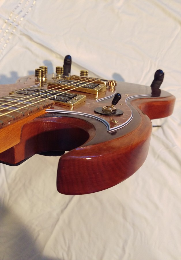

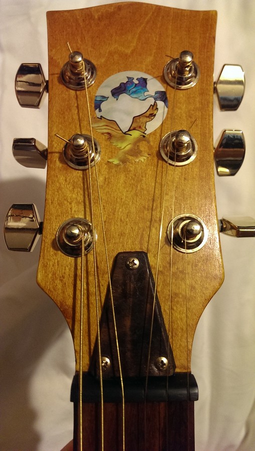

    Well here goes guys. My second guitar and enjoyed every minuite of it. Before i start i want to thank all the guys for their help from this community and to Adam (And Brendon of course)for making this possible.
    Rundown SG-2
    Body was beveled completely round to extenuate the already nice bevel.
    The top was veneered.
    The neck and body were stained with feast watson golden teak.
    The cap was clear wipe on poly, gloss as was the rest.
    Homemade pick-guard and rear cover plate..
    3 way switch was moved to mimic the Les Paul
    As was the mono plug socket.
    Standard switches were moved to accommodate the 3 way on-on-on mini switches
    Aftermarket gold and black switches used for vol. and tone.
    Brian May 24k gold plated strings.

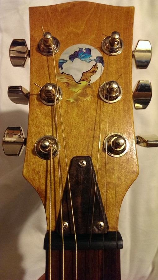

    Custom decal.
    Custom truss rod cover plate to match the walnut veneer
    Standard tuners.
    Replaced plastic nut with graphite one
    Electronics
    Aftermarket tri-rail Warman pickups and surrounds.
    Aftermarket 3 way mini switches that split the 3 way pickups.
    Custom wiring using braided wire.
    Replaced volume pots with CTS pots.
    Tone pots standard
    And amazingly everything works!!!! YAY... im stoked.. cheers guys.

    Wow, just beautiful mate
    Mentor vh2580's Avatar
    Cleveland Qld
    1,184
    Nitro that is classy as. Really looks like a boutique custom

    Thanks Tony, thats what i was aiming for, an antique, botique look, rough but glitzy.

    Nice work Nitro!!!

    Lovely, I really like the individuality of this guitar.....
