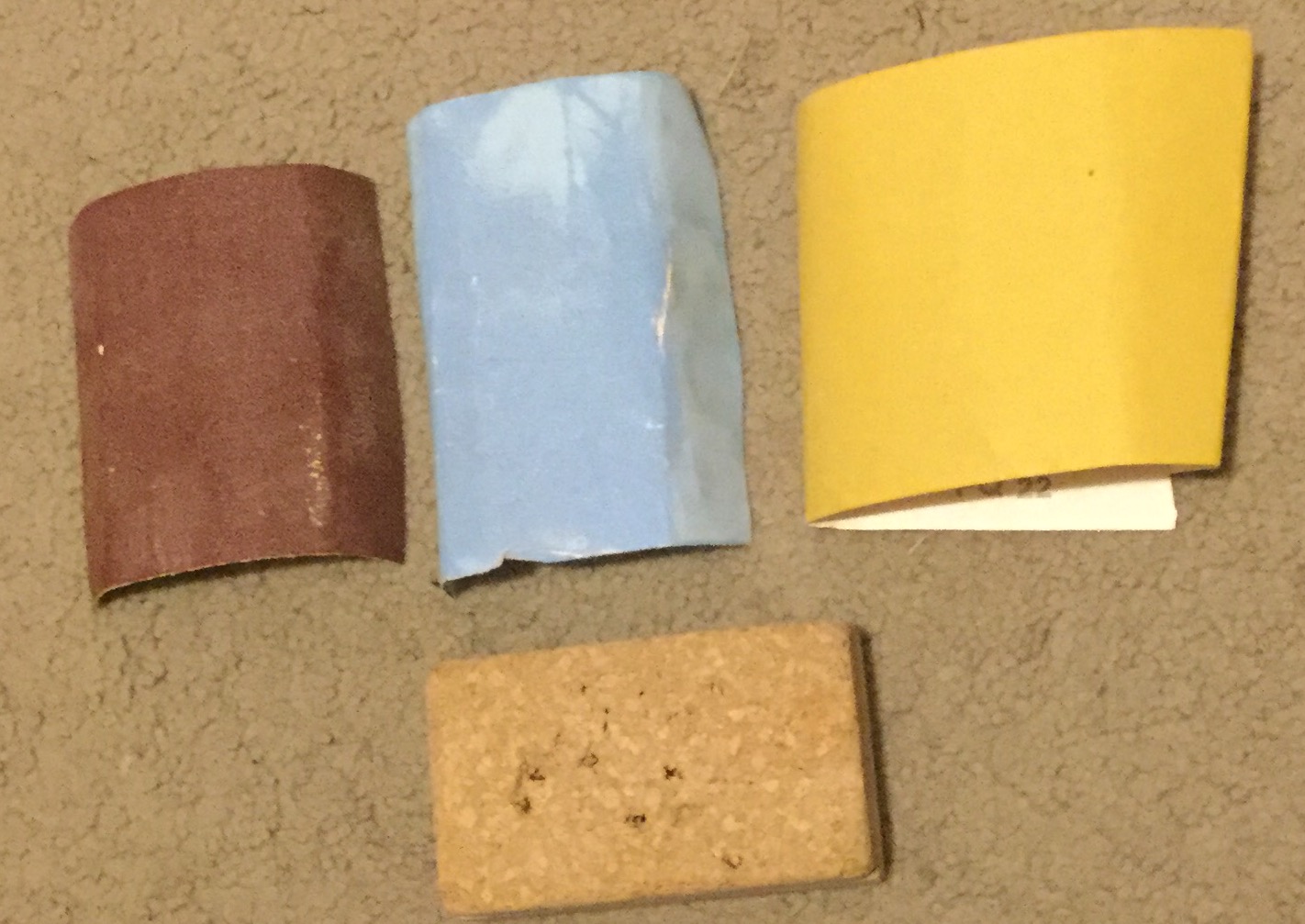

    I have finally managed to borrow some 80, 180 and 240 grit sandpaper from my schools tech shed plus a cork block (I will attach photos). Does anyone have any tips on sanding around the contours of the strat style body and sanding techniques, as the last thing I want is to mess up the guitar due to an avoidable error. Also, what would be the max grain to sand to while ensuring a good tooth for the lacquer to grip. Can't wait to get started!

    Hi George, hopefully you can get your hands on a bit more sandpaper than that shown in the photo? It is pretty cheap to buy per sheet at the Green Shed and reckon you need at least 1 x 80, 2 x 120, 2 x 180 & 2 x 240 - maybe 1 x 320 if you feel the need but 240 is usually plenty good enough. You should be able cut 3 pieces to then fold around the cork block from one sheet.
    80 grit can take lots off so take things easy as you only want to knock off the obvious rough bits. The machine marks from where the body was cut are best done with 120 in the direction of the grain, and once they have disappeared you can then revert to sanding in the direction of the contours.

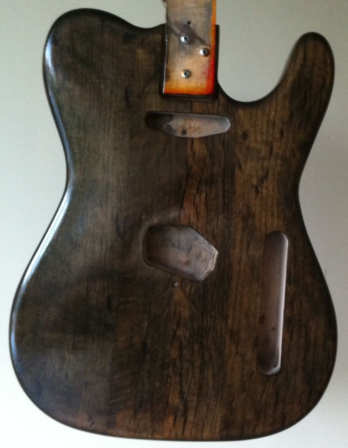

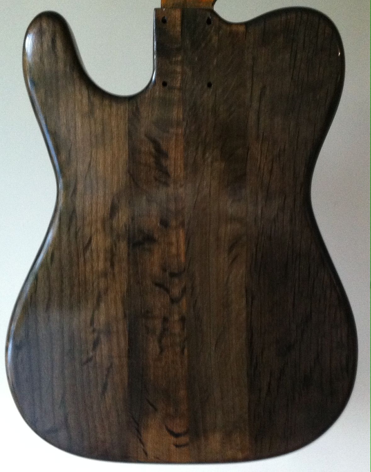

    I am presently on build # 5 and sanded up to 320 on #1 & #2, backed off to just 240 on #3 & # 4 and on latest one I stopped after a thorough job done over a few days with 120. It is a Tele where I have rounded the slab sided edges off similar to what you have on a Strat and that was all done using 120.
    Why did I stop after 120? To allow more stain to soak in.....400 is too much as the timber can end up polished and resistant to staining, 320 is almost as bad as 400, 240 is the sweet spot and particularly so on maple necks. As my latest build was experimental and using organic products I knew that the finish could be smoothed out later rather than overdoing the initial prep.
    Here is a couple of shots taken yesterday where the top coat was applied with wet & dry 600, then 1200 and now 2000 done over several sessions before moving on to the next finer grit.
