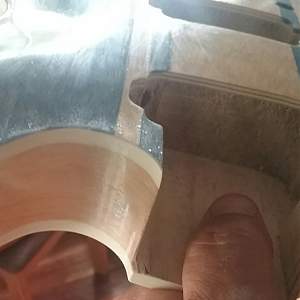

    Ive applied 3 coats of stain and 1 coat of intensifying over a 2 week period,everything was looking good. On thursday applied a finish coat after a light rub with some 600 grit, and left to dry, checked the next day and coating had blistered in different spots. So i have let it dry for 3 days and rubbed it back to smooth on those spots then steel wool 0000, wipe down with some gum turpentine and let dry. Did another coat this afternoon and its blistered again its like its not adhering to the intensifying coat. I did the neck coat at the same time and its fine.
    Any ideas of why, the humidity shouldnt cause this only slow the drying time
    Thanks

    Hi Adam, have you got a picture of the blisters you are talking about? Also is the DT bottle of final coat in a plastic see through bottle or a metal one?
ID:	17602 thanks for the help guys
    The dt bottle is metal, did the finish coats on the neck with neck finish at the same time and its come out perfect

    Its mostly around the edges and the pickup cavities

    Neck finish is a slightly different blend. In general i've had less issues with neck coats than body coats. Sounds like you have Dingotone MkII which is a bit more forgiving and no real need to ultra thin coats.
    These blisters are totally normal. I get them all the time. Once each final coat is cured, I just wet sand lightly (1500 grit or 200 grit) and in one direction to get it level before applying the next coat. Kinda feels like 1 step forward and 1/2 step back wards each coat, but you get that with any finish, even tru oil. Last coat you should allow at least 21 days curing time, then lightly wet sand to level and polish to your expected shine.
    As wazkelly said, we threw out the use of steel wool on DT due to adverse effects in the humidity.
    DT has no solvents to aid drying time so it just takes longer, as a general rule i leave it at least a week before wet sanding and applying the next coat. Humidity does make each coat take longer to cure...but you get there.
    Mate its looking really good. you should be proud

    Just had a close look under lights and can see scatches all over from the steel wool as well, bummer, going to have to get back to the intensifying coat. So the ideal conditions for DT are probably 30 days of the year on the east coast to get humidity and the right temps, is there any reason to not use the neck finish on the body?
