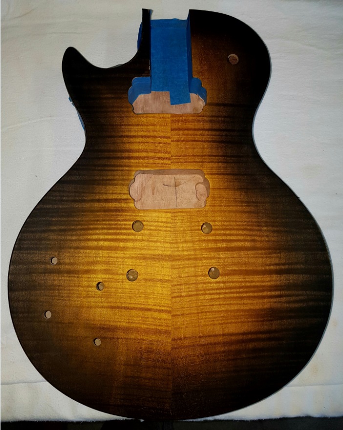

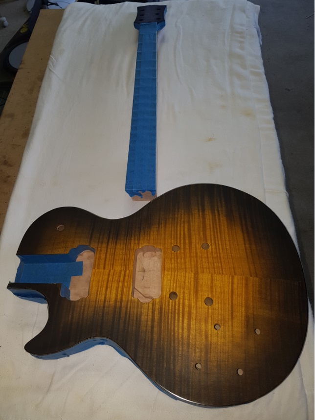

    Hi,
    I have made a start on my LP-1ML. At this stage I am looking to end up with a tobacco/desert burst with a almost natural back as its mahogany.
    The stains I have used were the Feast Watson 50 ml Proof tint bottles, Golden Teak and Japan Brown, I did use a little black stain right on the edge to help with the transition.
    The tobacco burst was a great option for this body due to an imperfection at the cutaway where the binding was not quite right, this is completely covered by the burst now. I have scraped the binding and set the neck, next I plan to grain fill the entire back of the guitar before finishing.
    I have used a traditional style head stock form and will be staining in the traditional black as per one of my other builds see photo.

  3. #2
    That burst is looking spectacular!
    Really really nice you've nailed the tobacco burst
    Sent from Lineage OS 14.1
    Mentor
    Jan 2013
    Talawa, Tasmania
    1,173
    That's sumptuous! Very well done indeed.
    Mentor Zandit75's Avatar
    May 2016
    Penguin, Tasmania
    1,617
    Beautiful looking burst!!
    Acoustics:
    Electrics:
    Builds in Progress:
    Mentor Kick's Avatar
    Feb 2017
    Amsterdam, The Netherlands
    823
    Awesome man!
    top burst DMartin, it looks strung up, can you please post some more pics of the finished axe ?
    Better enter March GOTM closes in just over a week !
    Brilliant work DMartin, looks like a lot of patience and finesse in that burst. Superb job.
    Love that burst, just beautiful.
