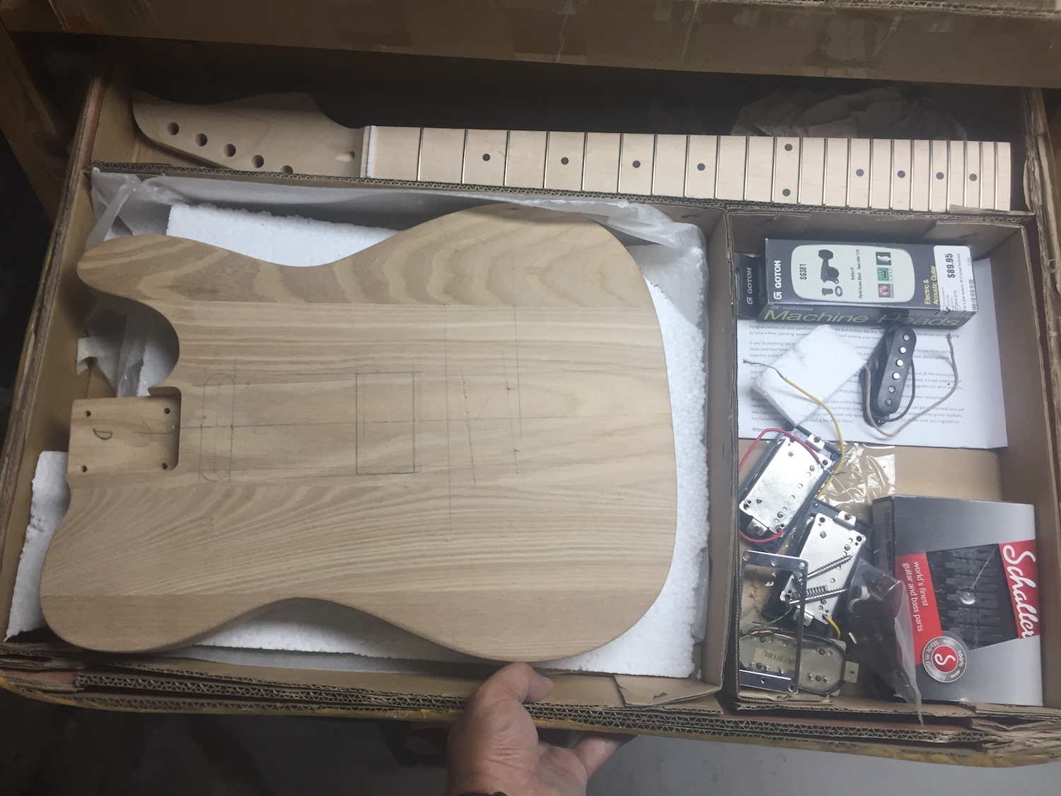

    nice looking kit Frankie, so is this a custom Pitbull kit ? only the neck pocket routed, did you shape the headstock ? looks great !
    Nice mix of hardware you have.
    Are you planning rear or front control cavity ?
    This was a the muffed custom thinline kit Ads threw on special a while back.
    Plan is, nude finish with clear DT
    Rear rout controls 1v, 1T with a push pull to split the bridge HB, three pos toggle.
    Rear rout pup cavities with adjustment from the back through a custom rear cover.
    Schaller Hannes 6 black bridge, string through body
    Gotoh black SG 381 tuning heads
    Graphtec nut
    SD Al Nico 2 SC and HB ( recycles from the FrankenWashie)
