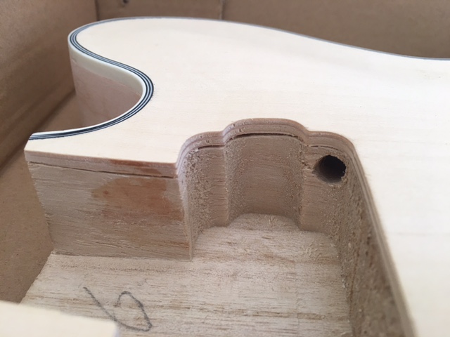

    Overall I am happy, as there appears to be no glaring issues/defects with the kit. There is a slight delamination of the top at the bottom side of the neck cavity, but this should easily be fixed when I glue the neck in place and in fact may help with reducing the visibility of the join, due to the slight flex now available in this area. Overall the neck fit is pretty good and with a little finessing, I should be able to get a very neat even join line, that will hopefully be almost invisible. Biggest issue is the back of the neck where it meets the body as the veneered layers of wood on the body are visible. If I can find some white/cream plastic sheet that matches the binding and trims, I will simply glue and shape a piece of this on to finish this area before staining and clear coating.

    Hey Roly, maybe the way I'm reading your description of the Neck issue, but that sounds like a problem that might need to be referred back to Adam. Post a pic when you get a chance to illustrate the issue.

    It's sounds bad, but I don't think it will be an issue. I will grab a pic tonight when I get home. If I put glue in the split and clamp the neck, I am pretty sure it will all go back to where it should be. You will see what I mean when I post a pic.
    This is the de-lamination.

    Just me but I'd glue and clamp the delamination before the neck went in, but take care of the top when clamping if you do
    It was clamped together before it came apart, so it really needs to be clamped together again. Just remember that the centre block isn't that wide (you may be able to use a torch and a small inspection mirror to check through the f-holes), so keep the clamp near the edge of the cavity. If you move the clamp too far away from the edge and the wood will pivot on the edge of the block and the gap at the cavity edge will open up even more. Definitely protect the top's finish with some soft wood blocks and some cloth first.
