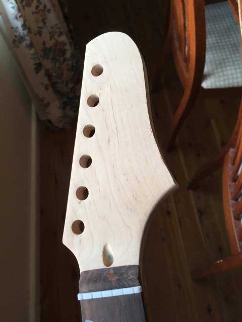

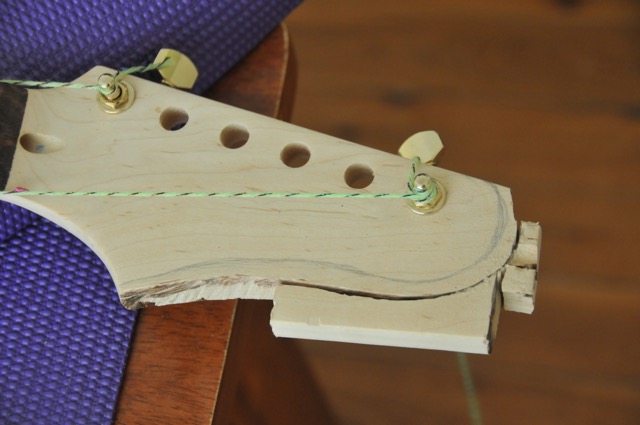

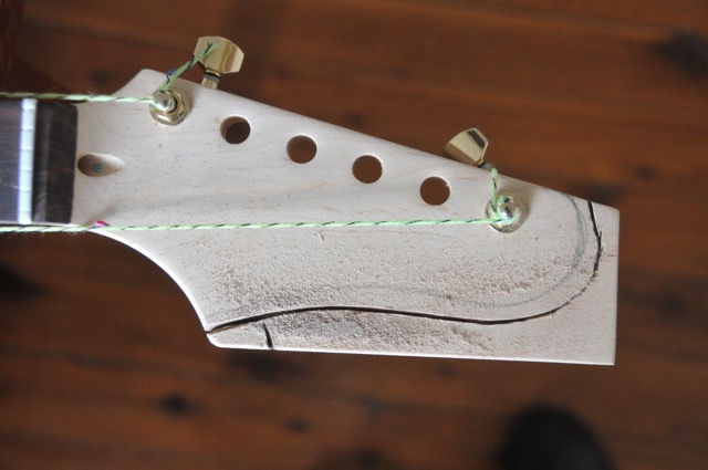

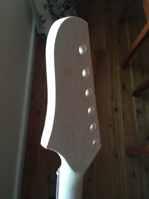

    Headstock
    Sawing, filing and sanding of the headstock.
    This is how it started

    After much sweating with a hand saw

    After filing and sanding
    I'll be away for a week, when I get back I'll get started with the sanding of the body.
    I was going to use Uluru red for the body and amber for the neck. I'm not sure whether I should also do the face of the headstock red or it would be a bit too much. Suggestions?
    Thanks
    Christian

    Nice work on the headstock Christian! My only tip would be that while basswood is soft enough to screw into without pilot holes (although I still do pre-drill), make sure you still put a dab of wax on the screws before finally screwing them in.
    As far as staining the headstock, I'm firmly in the school of keeping headstocks natural - but it's such a personal decision rather than a right or wrong thing. Go with what makes you happy!
    In Progress:
    Build #6 N1R "Semi-scratch" build
    Build #7 JZA-1 Baritone
    The Cavan Project
    The Magnificent Compaņeros
    I would use same colour that you use on the back of the neck in preference to body colour on headstock face.
