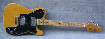

    It is a TL-1H
    https://www.pitbullguitars.com/shop/...ic-guitar-kit/
    going for this look
    but if it fails i would like to go Olympic white over the top of the tung oil
    Difficult look to capture using tung oil. That original Fender finish was a translucent near-white cream coloured coat, followed by several coats of 'clear' lacquer (which wasn't actually clear but slightly amber tinted) and which yellows with age. Modern imitations use a more creamy base coat and amber tinted top coats to recreate the aged look.
