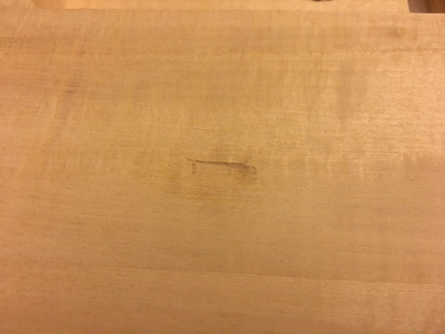

    Hi wokkaboy, probably my bad as I thought the black hardware was the machine heads etc not the dial and pickup covers. Anyway what is done is done.
    As for the dent, unfortunately they shop patched up the dent with some glue and a bit of dust so the old iron and dam cloth is not going to work. I was hoping that it was just dust so I could try that or even some aquadhere and sanding dust but to get it out was going to cause more damage.

    welcome Pat, you might find that a bit of a sanding fest lessens the look of the dent, you may still have some luck with steam.
    In the end, it's on the back...
    Also with some timbermate fill and more sanding, staining may hide it more as well.
    Good luck

    Thanks guys. Stan, other than their choice of glue/fill, the did get it smooth. So there's no 'gap' to get any fill in. The sanding is getting it down and I'm hoping I can feather it a bit with the stain to get it to blend in, but the glue line is always going to be there.
    Andy, getting as much fishing in now as I can! Storms don't help much. Where are you at?
    I think you've done as good as you can then mate, however some "goof off" my get rid of any surface glue, ive not tried it, but others here have had good results when used on excess glue that has been on their kits on arrival
