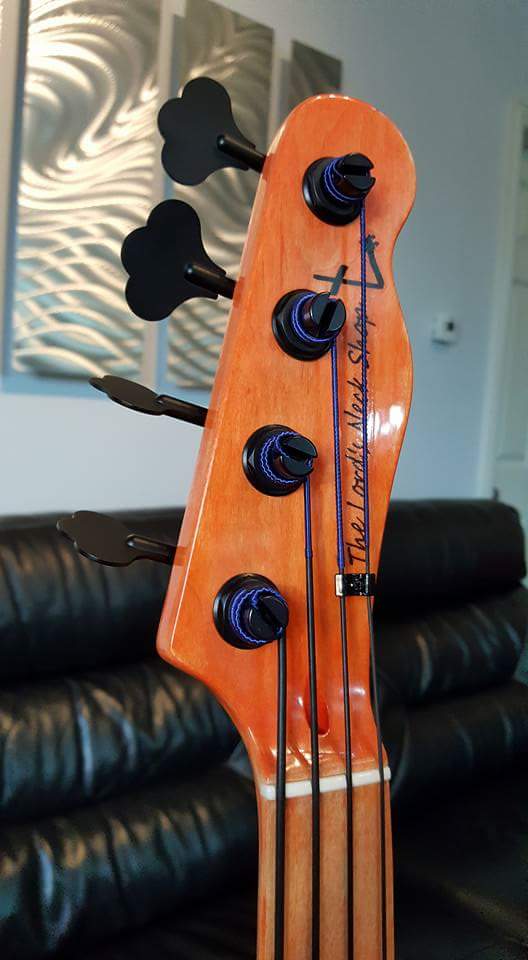

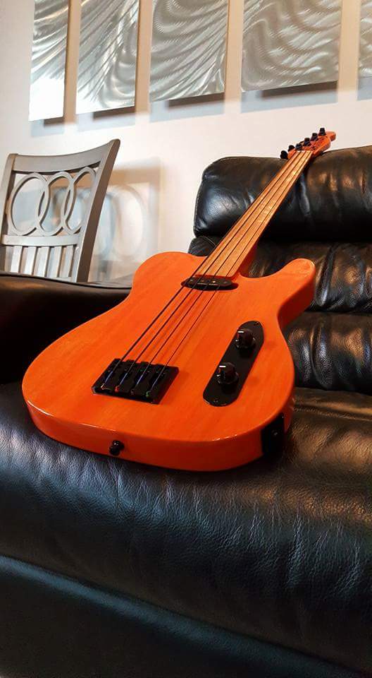

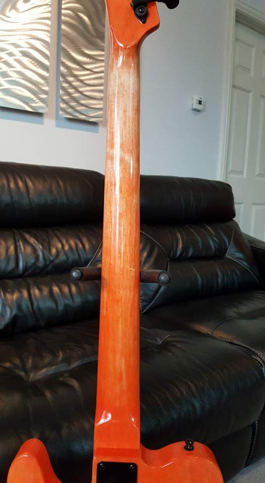

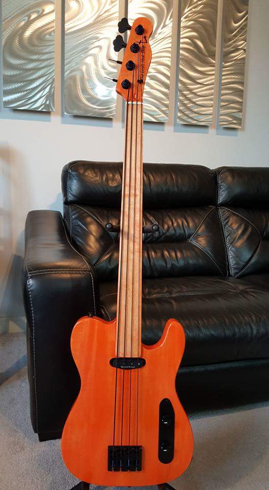

    Here is my maiden Pitbullguitars Guitar build!

    nice build Allcanbeforgiven, never seen this kit was it a custom order ? Looks very cool with the black hardware. And fretless !
    Did you have to put dot markers on the side of the fingerboard ?
    what's the stain Dingotone Bushfire sunrise? Very simple with the one neck pickup. Presume controls are volume and tone ?
    What an awesome Tele bass, great job
    Sent from my Moto G (4) using Tapatalk
    Different, simple, I like it! Great job!
    Wow, simple, slick and cool
    Wow. That is one funky looking bass. 100% agree with simple, slick and cool but RED hot!!!!!!
    Great job, hope you've put it in the GotM thread...
    Blacklick, Ohio USA
    5
    It came with simple side dots, I left them there. Sometimes I put plastic side dots in.
    Blacklick, Ohio USA
