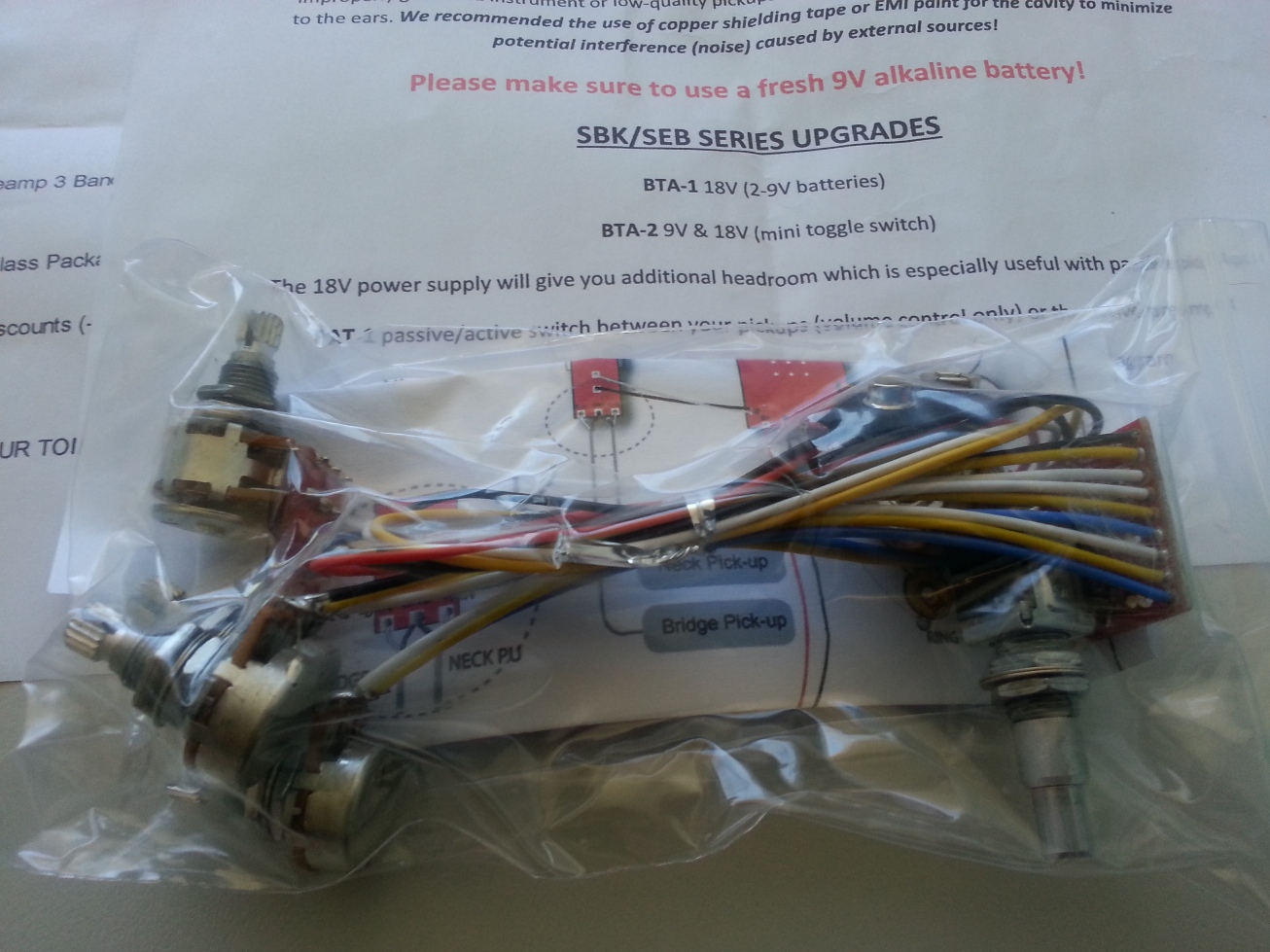

    Attached is a pic of the IB-6S this was a mock test to see if it fit. I managed to leave the battery in the control cavity held it with some tape and foam padding. Main issue to check is the height of the circuit boards on the pre-amp pots and they don't touch the cavity cover.
    Also attached a pic of the pre-amp when it arrived in the post.

Name:	2014-01-22 09.14.33 preamp kit arrived resize.jpg
