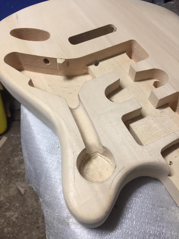

    Wow, time flies and not much progress (happy new year all!) – although I did cut some bits off the body, 'cos that's what I do! I’m still at the 40 grit and rasp stage of body mods, but it’s a start.
Name:	Initial reshaping 020117.jpg
    The biggest challenge at the moment is what to do with the pickguard. As mentioned I can’t use a standard strat one as I’m only using two pickups, and I’m also thinking about filling in the jack rout and plugging in through the pickguard. I didn’t particularly enjoy making a new one for the last build, so I’m looking for a different approach. I also want to paint over the pickguard (I’ve now decided the body won’t be just a single solid colour) but I’m concerned about how the paint will take to the plastic of the guard. One option at this point is to get a very thin veneer and epoxy it to the standard pickguard. That way I’ll cover off the two challenges: paint will now go on to wood, and I’ll also be about to cover up the standard strat routs and holes in the pickguard that I won’t be using. I think it'll work but I'm still trying to dream up a different approach...
    Anyway, that’s where I’m at … and with any luck I’ll nail a couple of steps over the next week before heading back to work.

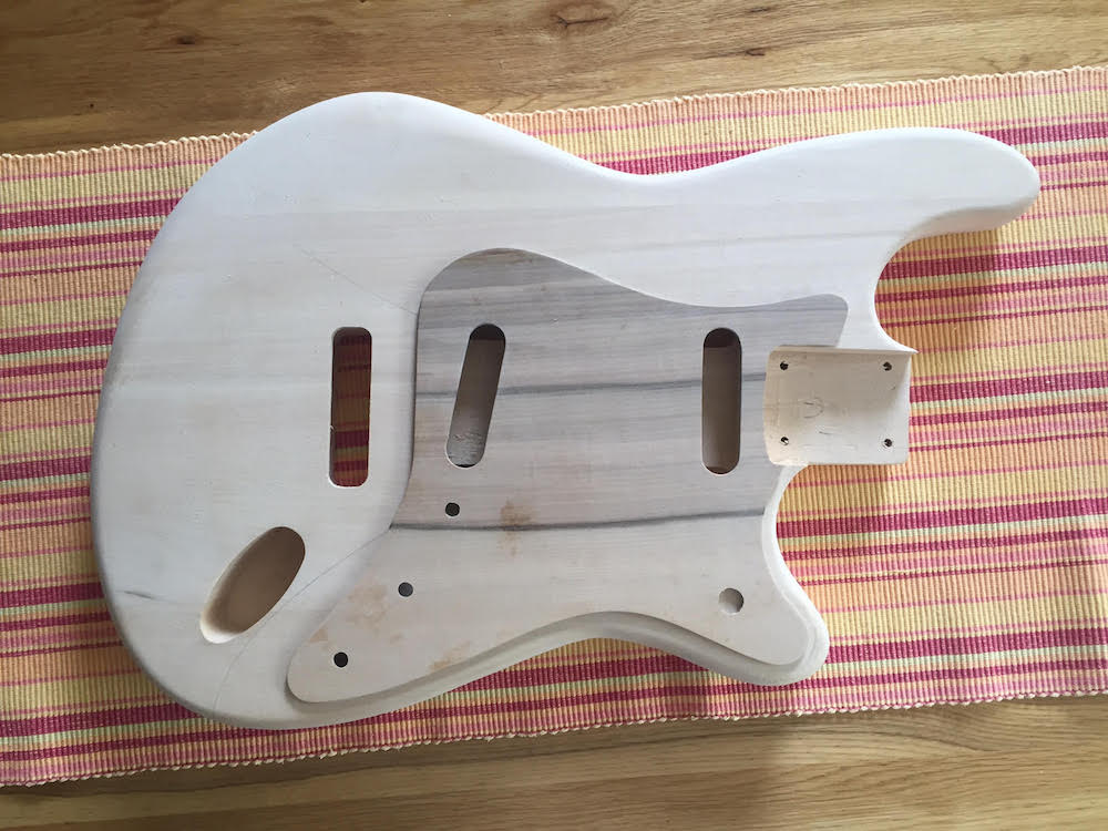

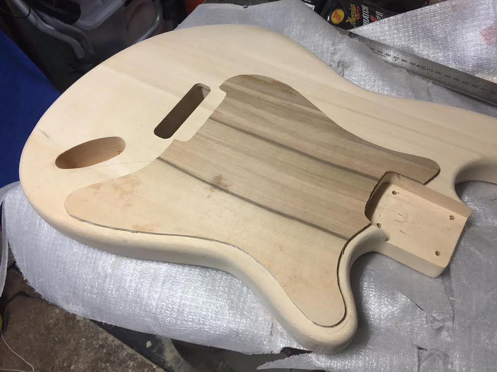

    I decided to stop over-thinking the pickguard thing and just do what I'd originally thought of - the veneer option. The veneer came from a sample pack I think I bought at a woodworking show many years ago. Of the dozen or so in the pack, some were a bit wavy, so I chose the cleanest and flattest one for the job. It looks like Tassie Blackbutt a bit.
Name:	030117 pickguard A.jpg
ID:	16137Click image for larger version.
Name:	030117 pickguard B.jpg
    Some 5min epoxy seems to have worked well, and I've done a very preliminary rough shaping. The veneer is only 1mm thick, so when I bevel the edge you'll still see the white/black/white edge of the original but that should work in okay with the paint scheme. In some ways it's a pity to cover that nice veneer with paint, but I'm sticking to my plan. I'll let it dry properly overnight before doing any more tidying up around the edges and doing a bit of scraping on the surface to clear off the excess epoxy that somehow magically found it's way there.
    Next step is to finally decide whether to fill in the jack cavity, and then do the routing near the lower horn for the pickup selector switch.
