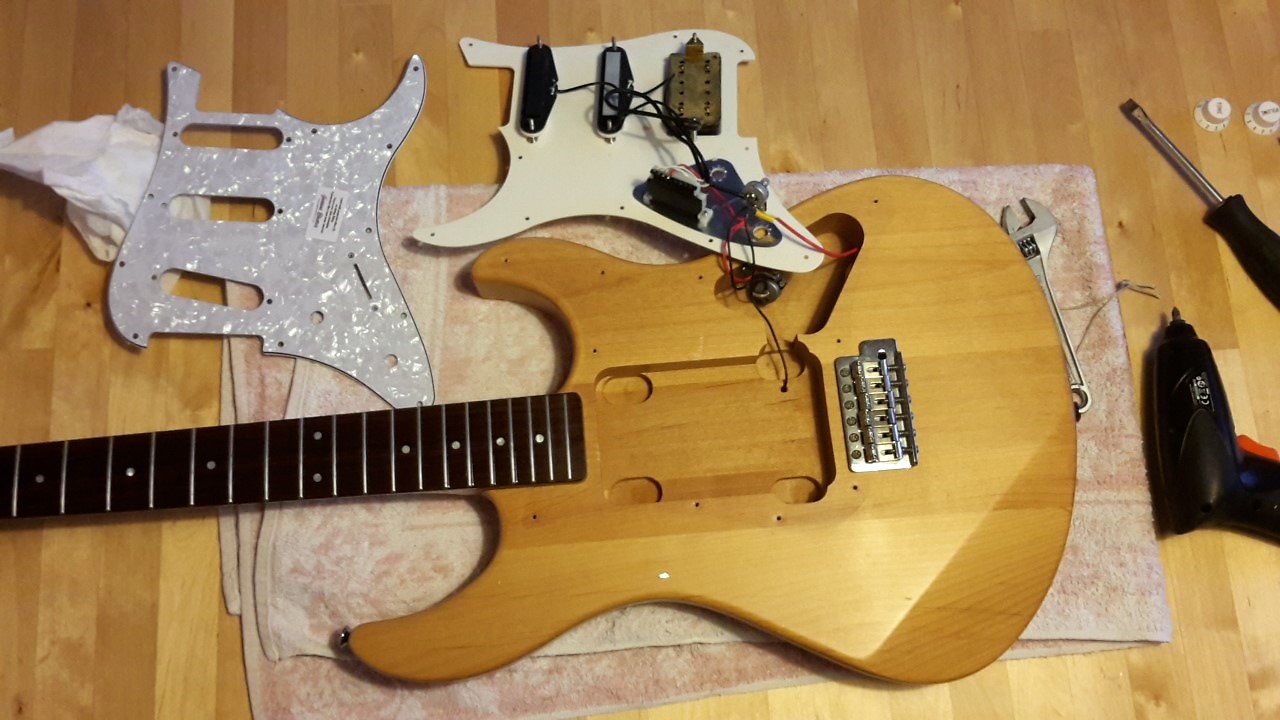

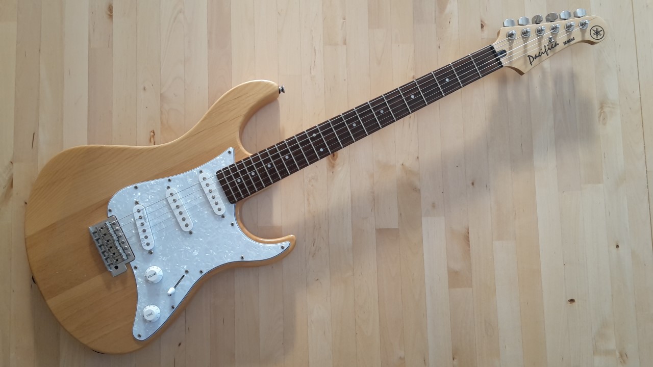

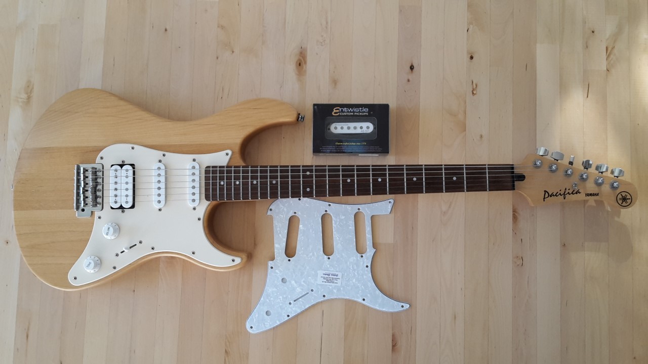

    I've had this Yamaha Pacifica 112 for years. A great go to $150 pawn shop guitar, but I always hated the sound of the bridge humbucker and wished for more traditional single coil. Recently spotted on the web some replacement guards in a SSS configuration, for a measly $24 shipped from the UK. Always wanted a pearloid version as well, so I ordered. Couldn't decide to bite the bullet on a full set of toneriders or hold back on the cash outlay. $s won and I just bought a single Entwistle from Pitbull.
    Put it together yesterday and I'm very happy with the visual improvement. The bridge pick-up sounds great and what I was hoping for. The split position combining the bridge and stock middle coil isn't working so happily, more on that later.

    Thanks for all the comments and ideas guys. While I love the "big name" guitars and have owned examples of most of them at some point (far beyond my actual paying abilities), the Pacifica is an amazing guitar for the money and my intended use for it.
    The problem with this new setup is the bridge and middle sound, and I'm a big fan and using of the "2&4" position sound when playing clean, which is most of the time. Currently the output just drops away and sounds like the guitar is unplugged, but still "out of phase". The new bridge pickup sounds great, but does have a lower output and markedly different sound to the stock middle and neck.
    At this point I'm considering getting the matching Entwistle middle & neck pickups for $72 or stretching for a full set of Toneriders for $140. I'm really after that vintage clean '57-'62 Strat sound. Any opinions on the two brands compared, considering the $ difference on a budget guitar?
    Of course the next consideration is the replacement of the switch, pots and capacitors
    So, the 4 position middle & neck is OK, but 2 pos bridge & middle is too low output and out of phase sounding? Have you tried reversing the connections on the bridge pup?
