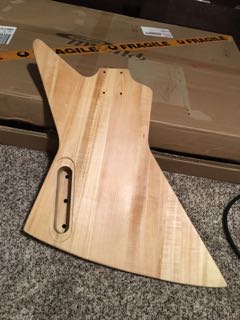

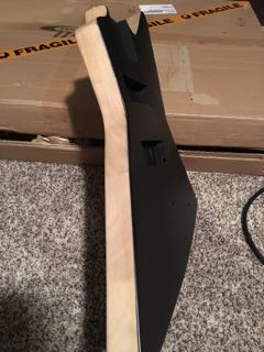

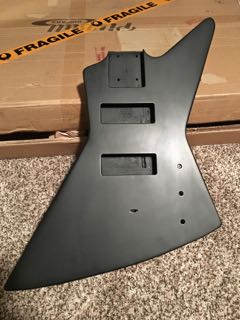

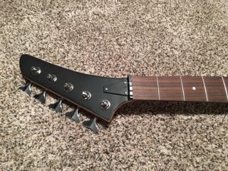

    I'm not sure if I'm doing this correctly but here is the start of our build diary. My son wanted a flat black look with just the top of the body and head painted leaving the rest natural. We did a mock up and it looks pretty cool with the chrome accessories. I'll post photos as we go.

    Hey Fellowsoldier, you're doing just fine. I like your young man's vision for this EX, its very clean and very simple.
    It all looks great so far. What treatment are you going to do for the back?
    Curious vision of an EX, with the convination of Black and natural finish. The result must be cool.
    Looking great so far! Really digging the colour combo. Should look amazing, especially if the natural part is gloss. Watching your build diary with interest!

    That will look great! You could just seal the timber with gun oil or similar......
    Good work so far. You'll really need to treat the 'natural' wood in some way to help protect it, otherwise its going to look rather dirty in a very short time. Also, it really needs protecting from moisture and the worst excesses of high and low humidity. If you don't, a simple spilled drink could stain the wood and also cause it to swell up.
    So I'd suggest a clear flat lacquer finish or some form of gun stock oil (e.g. Tru-Oil) as Andyxlh suggested.
    Of course you may have already been going down this route, it's hard to tell from the photos, but you did mention only painting the front faces.

    Looking good and also curious to know what you have planned for the sides and back where there is plenty of nice grain happening.
    The standard kit supplied truss rod covers look a bit out of place of these radical shapes and substitutes can be easily found on the net or eBay. Also, keep an eye out on the upper frets as once you have flattened the deck hopefully that will eliminate any buzzing in the upper registers, at least that was the culprit on mine.

    Thanks for the feedback everyone. My son doesn't want a "shiny" look so we're trying to avoid finishes that would give that appearance. I put one coat of Watco Danish oil, Natural, on the back, neck and head. After that dried I took some fine steel wool and gave it a good rub down. I'm not real sure how many more coats I'll put on, probably just one more.
    My son chose the paint scheme after looking at photos online of other instruments. I'm a fan of the simplistic look, plus he's not really into the flashy look of things.
