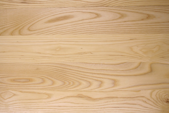

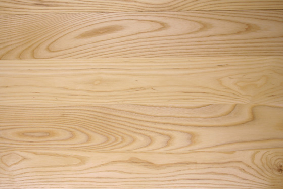

    All good, found it - http://www.buildyourownguitar.com.au...ead.php?t=4323 - very cool distressed look. I really like Arzi's Barncaster in this month's GOTM too. It's not quite what I'm shooting for though. Rather than going for clapped out and ancient, I just want it to look like woodgrain in black and white:
