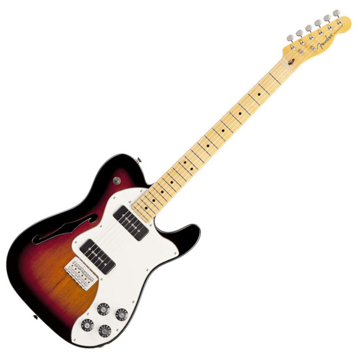

    6) You'll need a custom pickguard in order to cover the bridge pickup routing hole. It's very unlikely (because of the original slanted pickup rout) that you'd be able to rout out the bridge pickup cavity so that you could fit a dogear p-90 with none of the routing showing. (You could knock up a paper template from a dimension drawing to check). So you'd need something more like this, but modified to fit a standard silver Tele control plate:
    So it's not going to be easy. You could just fit a dog-ear or soapbar P90 in the neck position and leave the bridge as standard (or look for a P-90 style Tele bridge pickup - though they won't be cheap).
