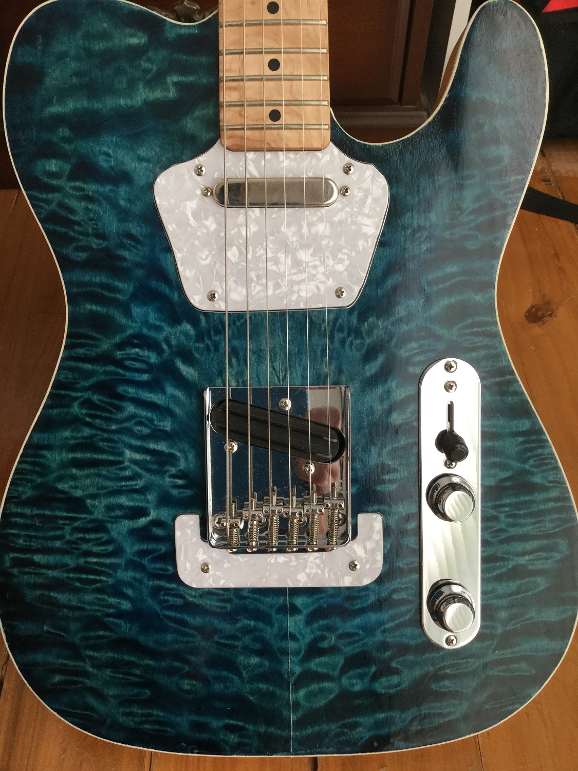

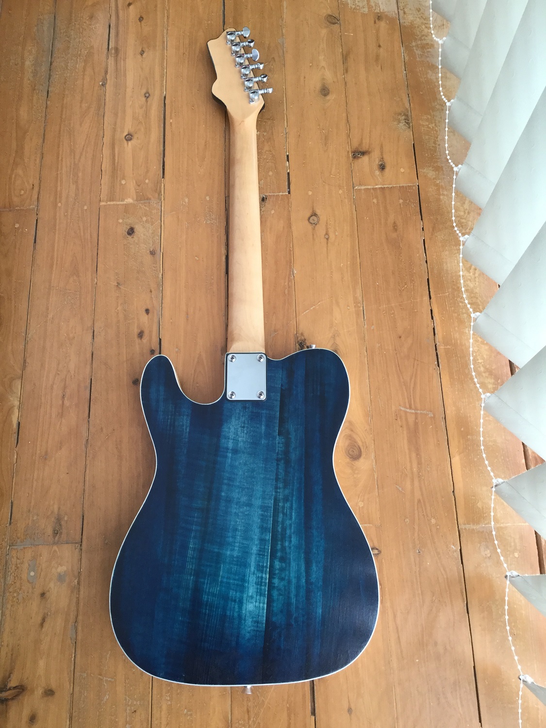

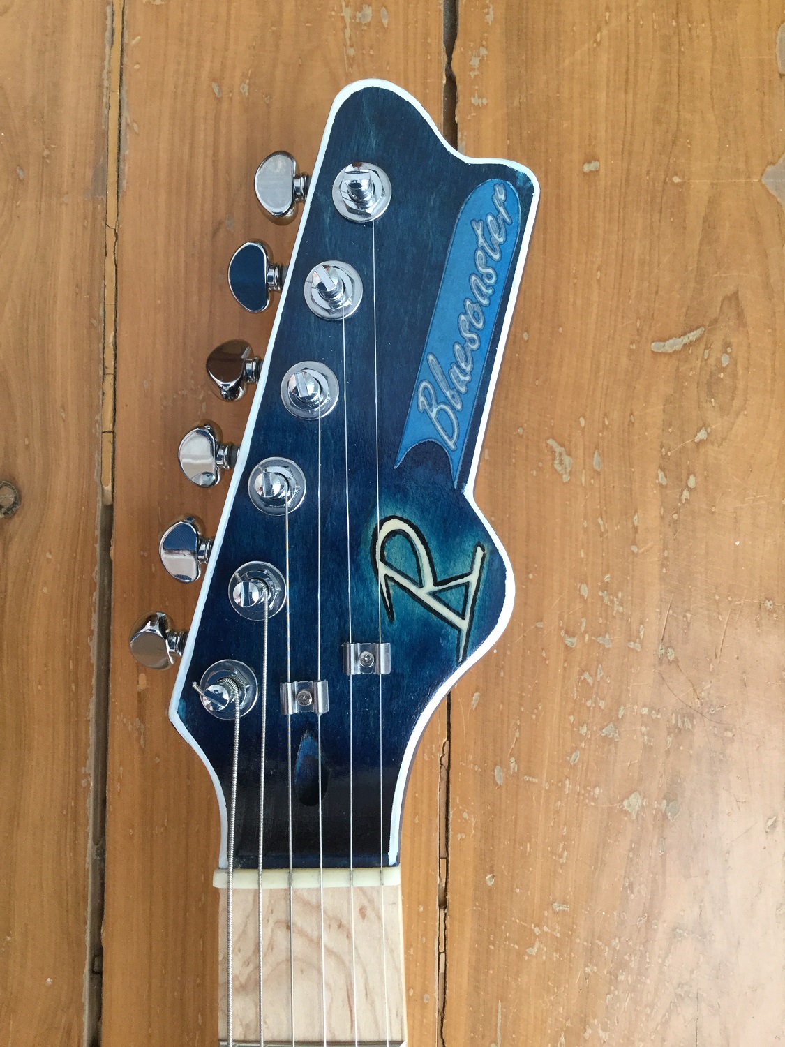

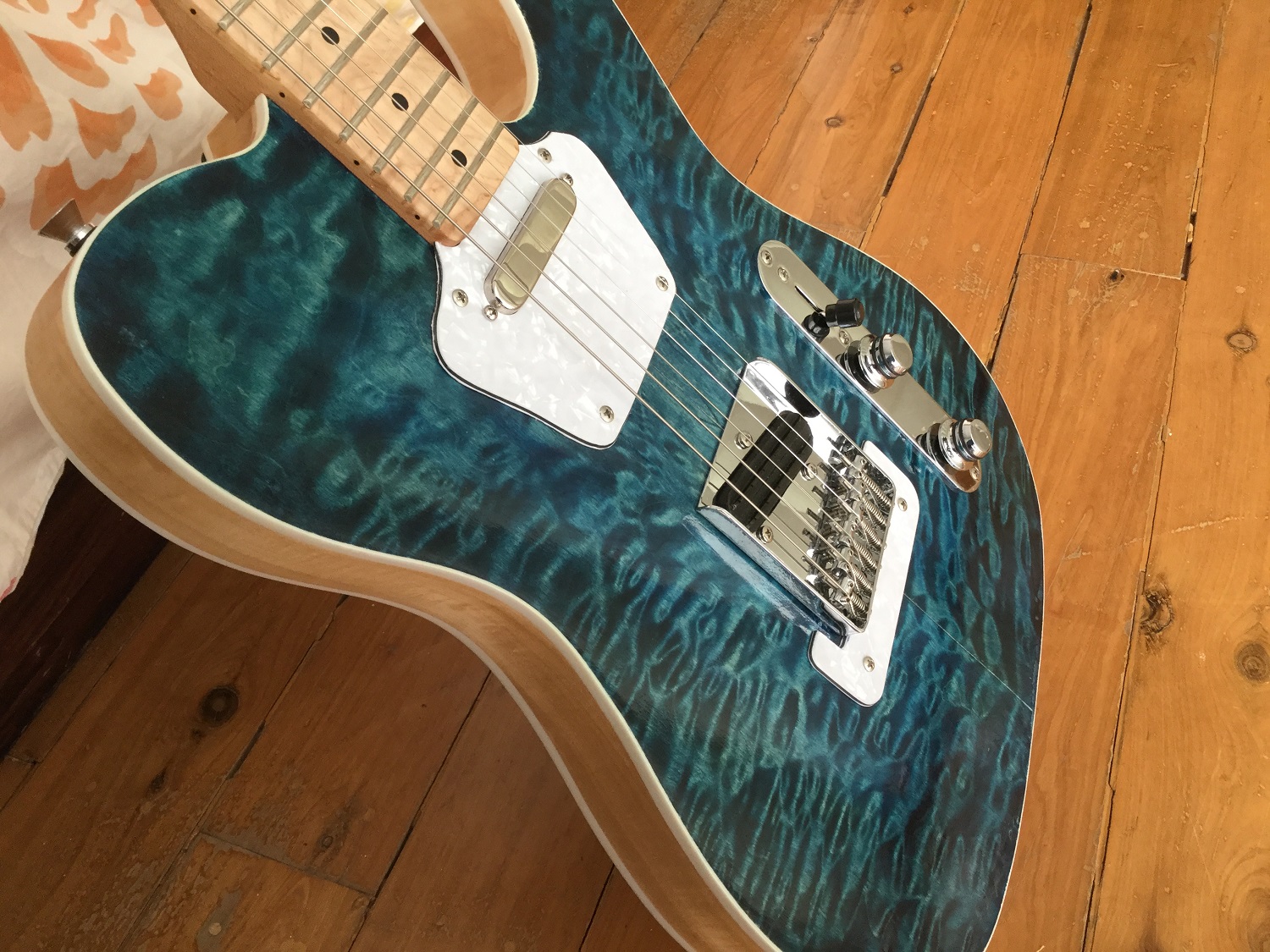

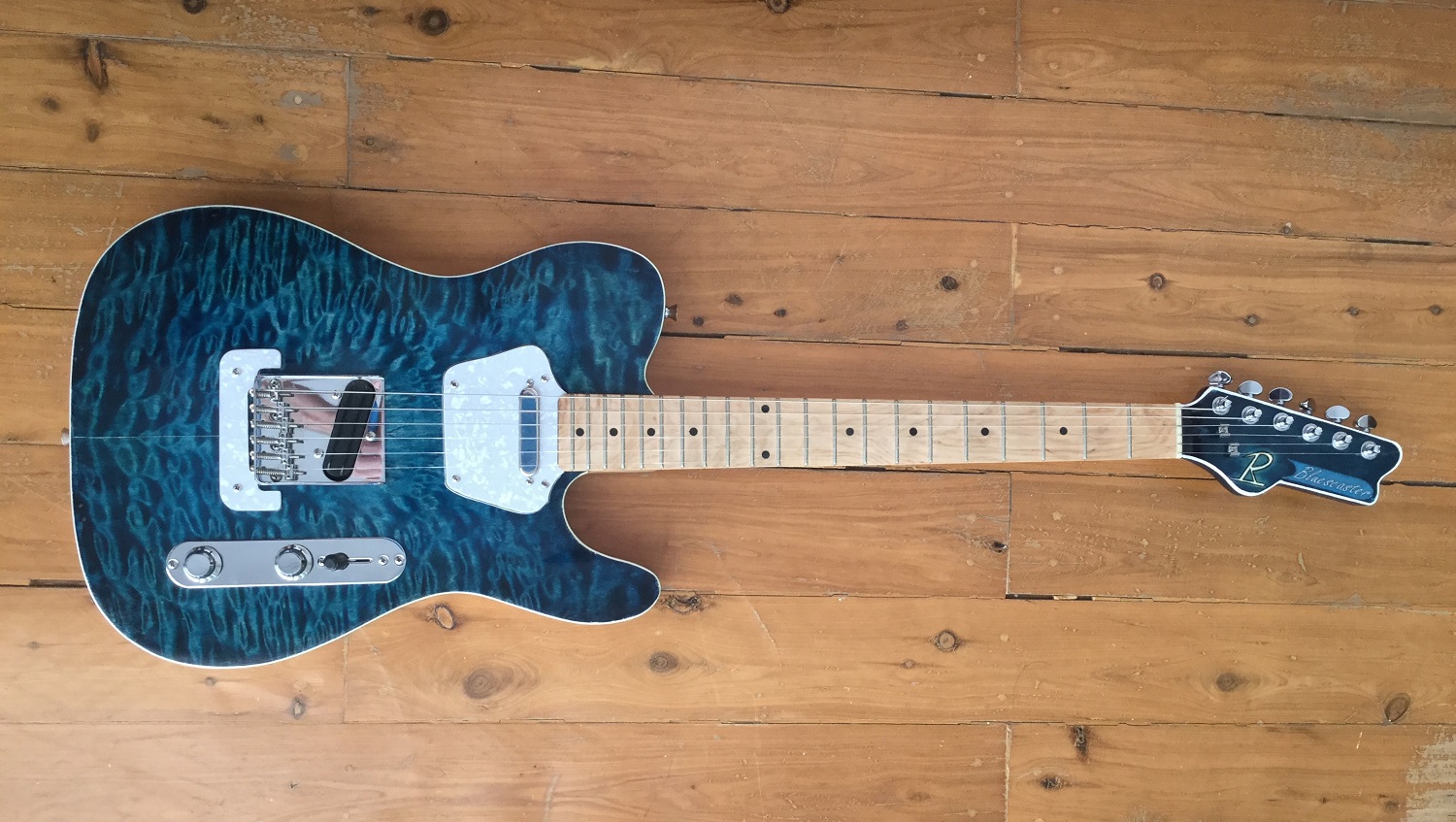

    So here's my first PBG build.
    Completed with Tonerider Hot Classic neck p/up, Kent Armstrong Dual Rail bridge p/up in an aftermarket modern bridge, Dingo bone nut, Grover Mini Locker tuners, Dingo Clear neck finish and Tru-Oil on the body and head stock (just love that stuff!). Body was done with a light black wash, a blue burst then finally scraped the bindings. About 14 coats of Tru-Oil with plenty on light sanding to level between coats (6 coats on the back, sides and head stock) then finish with fine liquid car polish and a coat of wax. Plenty of work but a satisfying outcome. Love the Tonerider pickups too. Plenty of grunt with enough spank thrown in for a hot Tele sound at a good price to boot! Enjoy.

    Very cool ILR, great scratchplate idea and love he binding on the headstock.

    Love the colour and figuring on this one, ILR. I don't normally go for greens or blues over natural grain - but I get a really pleasant bluejeans vibe from it. Are the pickguards your own design? They're minimal, but add a good colour contrast. Nice job.

    Thanks G-Axe. Yes, my own design. I wanted to show off the veneer as mush as possible, so I went looking at retro and art deco designs for inspiration. I tried to keep in style with the body shape.
    Thanks Andy.

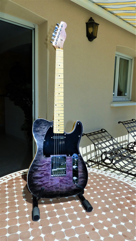

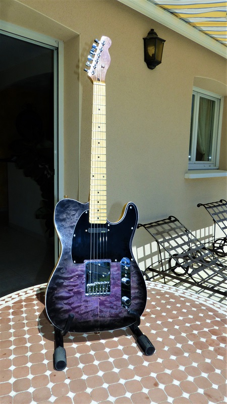

    Beautiful guitar ILR
    Good job and nices ideas for building
    This is mine , I finished it yesterday
    EMG Pickups , Kluxon Bridge and Shaller tuners

    Nice, love the colour scheme and quilt
  12. #9

    JJGeodus...c'est tres cool

    Yours is very beautiful and especially atypical
    The cut pickgard is a very good idea and emphasize the body.
    Congratulation !
