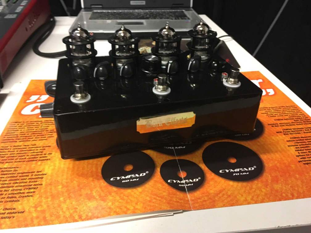

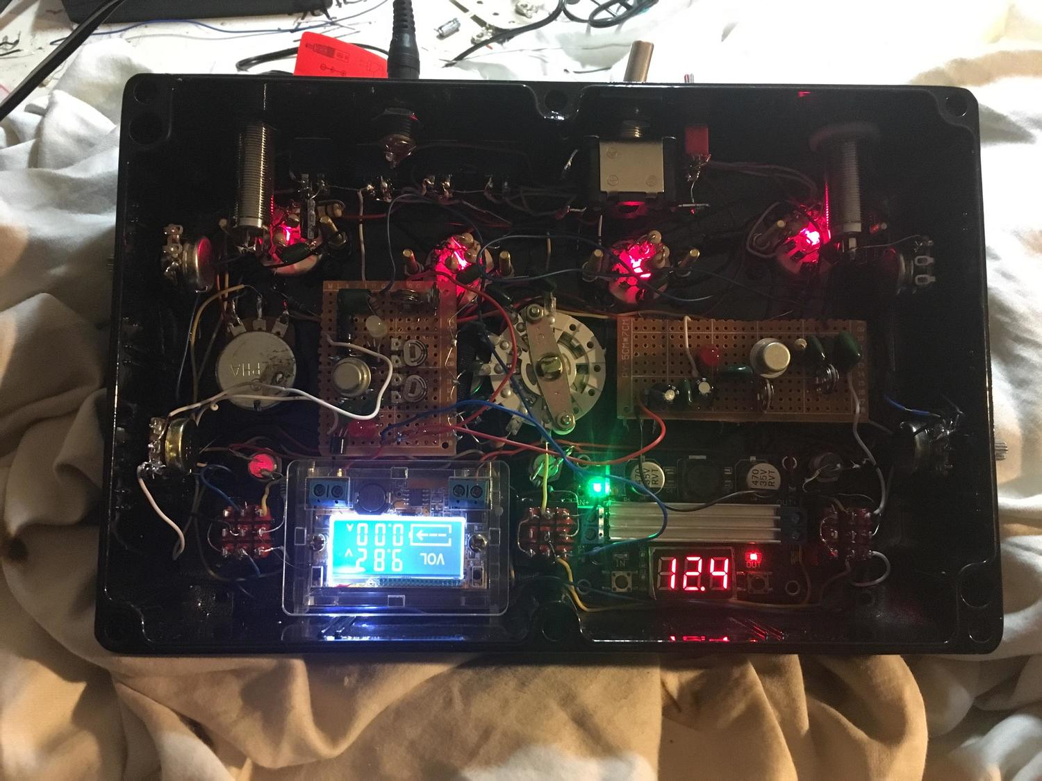

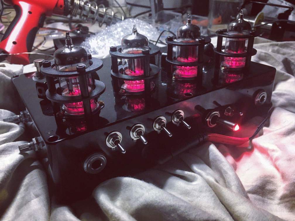

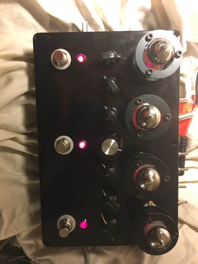

    I presume the pictures are of the prototype? It's obviously a voltage-starved tube design (with Behringer style 'glow' LEDs), which avoids the safety issues surrounding mixing normal tube voltages with normal electronic circuit voltages, but doesn't get the best sound out of the tubes.
    Obviously it's a 'none more black' concept for the control panel, but it really would benefit from some readable labels for the knobs and foot-switches. If I was buying one I'd like to see proper PCBs in production models rather than the prototype board used here, and I'd also like to see a much taller protection arrangement for the tubes. At present there's nothing to stop anyone putting their foot on the top of one and crushing it, or dropping something on it to the same effect. You really don't want broken glass everywhere as well as a defunct pedal. It's not an audiophile hi-fi amp that's going to be sitting on a shelf so that you can get away with such rudimentary protection. It's designed to go on the floor, and on a darkened stage, anyone could stand or trip over it.
    Not at all sure why it's got a number of display boards inside, where no-one will see them. Again, this may be just the prototype, but if it's for 'tweakability' purposes, then maybe using a larger box, mounting them on the side and bringing any adjustment pots there as well would be a better solution. Asking untrained people to mess around on live pedal with screwdrivers is always asking for trouble IMO.
    If it sounds wonderful, then great! But even so, there are issues that should be addressed before there's an accident and the designer gets sued.
    All you questions answered Simon
    Hi Simon firstly thanks for all your useful input it's greatly appreciated, firstly yes it is a voltage starved set of 12ua7's and yes this helps with the safety issues and I'm afraid you will NEVER see a PCB in one of the these they are not mass production pedals and EVERY SINGLE PEDAL is different in its own right. the finished pedals ARE MARKED, you will also never see taller protective cages for the valves. And if using switches is difficult for a person, and they lack the co-ordination to avoid standing on the valves or dropping things on them perhaps they would be better suited to something like a boss pedal, or maybe just the channel changer on their amp. You know something simple...
    I also like colours however the people who have requested them so far have opted for black and being eager to please I provide the colour they want...
    And onto the "DISPLAY BOARDS " lol, well they aren't actually displayed boards Simon, they are linear power regulation and voltage steppers, they are inside because although quite pretty, they are not to be tampered with, people like pretty things Simon,.. and if it's on the outside or anywhere they can adjust them easily they may just destroy the pedal! as a matter of fact any person adjusting the voltages would have to be mildly retarded.. if you think you know better than the person who made it, then go for it but as I CLEARLY STATE during the process of all sales the tampering of any part of the insides of any of these pedals immediately voids the two year warranty, as I'im afraid it's a case of tampering at own risk and I would instantly know what has been adjusted, and yes we are insured up the ass just in case someone feels the need to pump 12v massive through themselves!!! yep Simon even the people who know all there is to know, can still break things they don't truly understand, and yes Simon I'm sure we will encounter all kinds of issues in time, but I'm sure we will overcome them with due diligence and perseverance. Once again thankyou for your input and we'll be sure to take everything you've stated into account,
    These pedals aren't for everyone...
    I NEVER intended them to be, if it's not your thing or you want pcb or you don't like point to point or even if the inherent unpredictably of germanium parts worries you, I would consider buying something like a DIGITECH modelling pedal or maybe BOSS hey why not get a fancy BUTLER valve pedal,
    I'm sure anyone with your list of concerns would be much better suited to a ever so sturdy and impregnable FOOLPROOF pedal, yep mate I'd say that's your best bet,... leave all that nasty custom stuff to the silly buggers who like something different, maybe you should start making them yourself... that's probably the best way to go....
    cheers and once again I can't thank you enough for your insights cheers mate
    Hi Simon

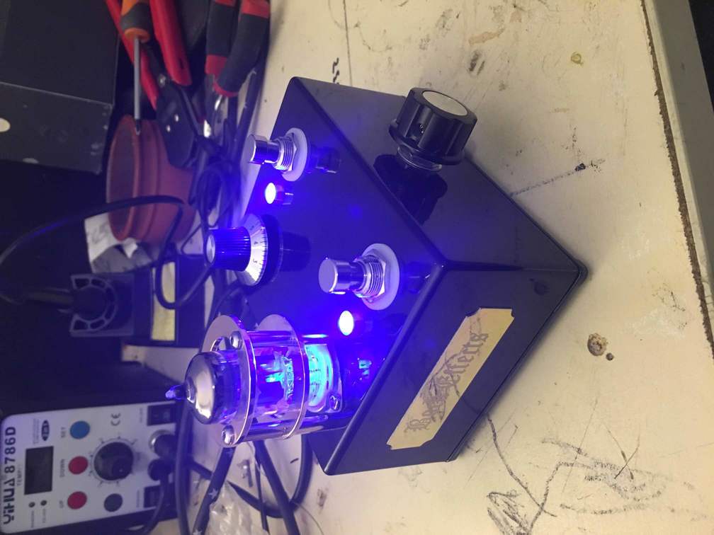

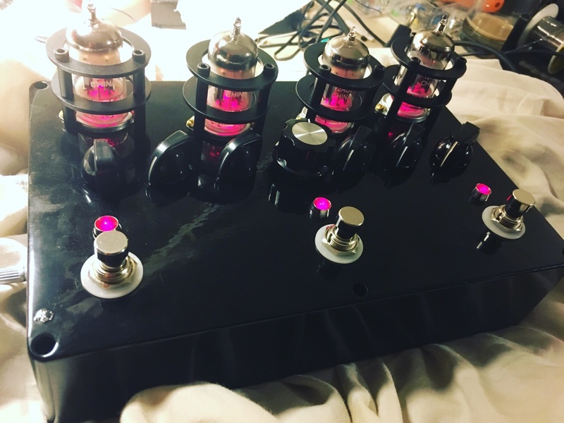

    Yes, the pictures are of the prototype, but the completed project is well under way. Trintin builds these by hand so it's not his intention to mass produce these and hence my excitement to share what he has done. He "tunes" each one by "ear" which is really cool.
    Trinton has figured a way to technically get over four hundred possible options from the one pedal Sounds silly right?? But it's actually just a matter of putting everything in its place and making every aspect switchable diodes valves input capacities circuits etc etc every aspect has been carefully planned. He spent almost 2 years developing these pedals. There are 4 different options.
    Some more photo's below.
