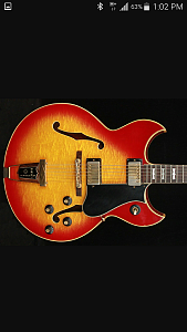

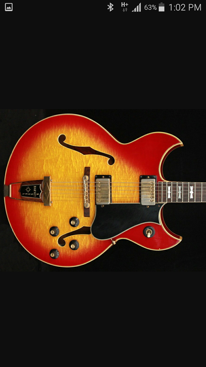

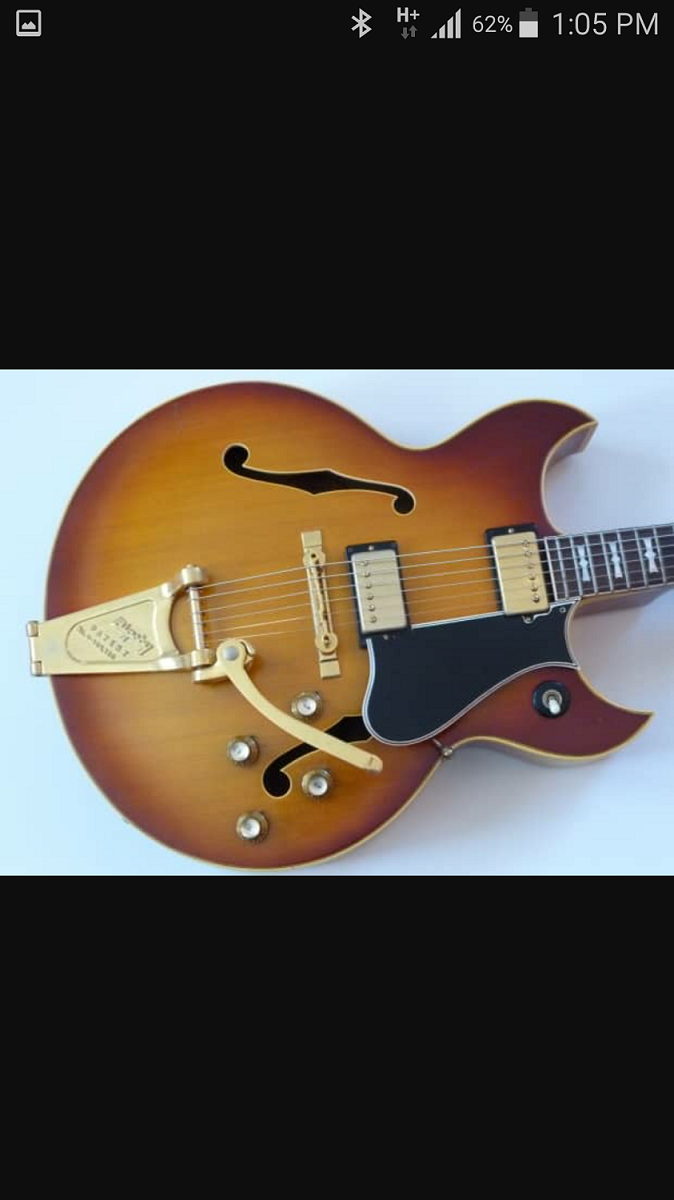

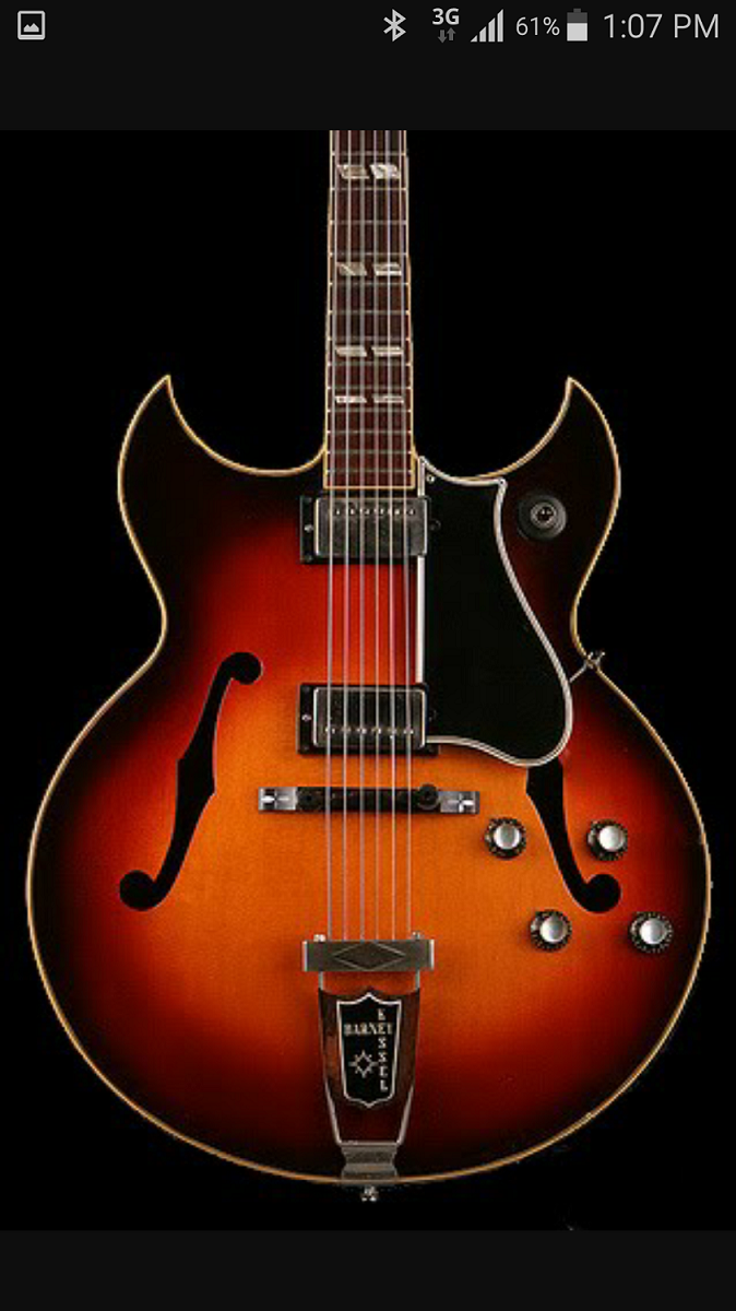

    Here's a couple of pics, sorry I didn't crop my phone screen off.

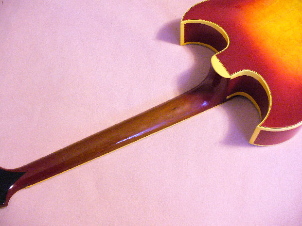

    A Gibson Barney Kessel model (later modified to become the Trini Lopez model as well). Made between 1961 and 1972.

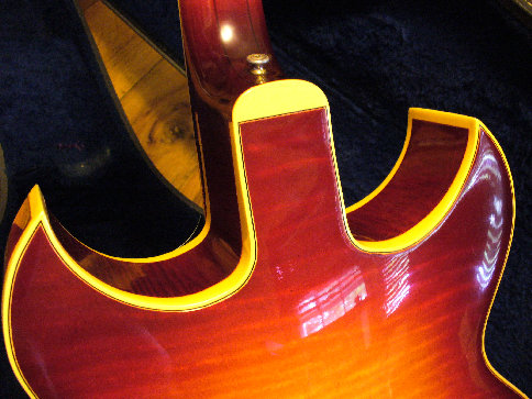

    That neck joint detail is very different from a standard ES-3, so the neck would have to be a new neck as well. There also seems to be variations on the neck joint on Gibson models from different years. The length of the body extension out to the heel seems to vary by around 30mm or so. Here's the long one:
    The longer ones probably have a more stable neck but the thick heel then negates the benefit of the double cutaway for high fret access. The long neck heel seems to have been used between 61-64 (which also generally have laminates spruce tops, rather than the later maple) and these first models seem to be the most prized models today.

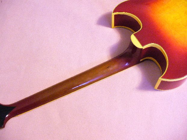

    Here's the shorter neck joint:
    For the short version, the neck would probably have to have a tenon that slipped under the neck pickup position to give sufficient strength - another change from the ES-3 neck.
