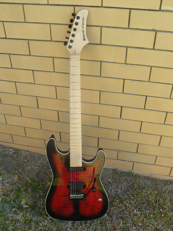

    Just a heads up on stamp pad inks as I did a fair bit of experimenting on builds 3 & 4 and found the stock standard colours were quite dull and lifeless. Black is OK and wiped off would give a really cool grey wash effect that you could darken up with subsequent applications. The Red looks washed out already and to the point where red food colouring had more depth and vibrance hence why I went with a blend of fountain pen ink and color tone cherry red stain. For the Blue, stamp pad ink was just the wrong shade for me and looked even more duller than the red. Mind you I was tempted to use fountain pen ink as the blue comes in 2 colours, one is basically blue and the other is blue black and lends itself to a more sultry look. As I was chasing aqua or turquoise ended up settling on diluted Cyan ink jet ink on the Tele. If you are chasing a truly dark black would recommend going straight for the ink jet ink as they seem to have a thicker viscosity, not by much, but when compared to ink pad stuff which is just like coloured water.
    Not sure how FW stuff would go on top of inks as their composition tends to lean more towards water based than oil based. Would suggest leaving things to dry and cure for at least 7-10 days and brush on the 1st top coat as ragging with dilute part of the ink stain coat and drag it all over the place.
    the red ink I used on the community build was 2 coats of undiluted, that was pretty intense. They were inks from U-Beaut.
