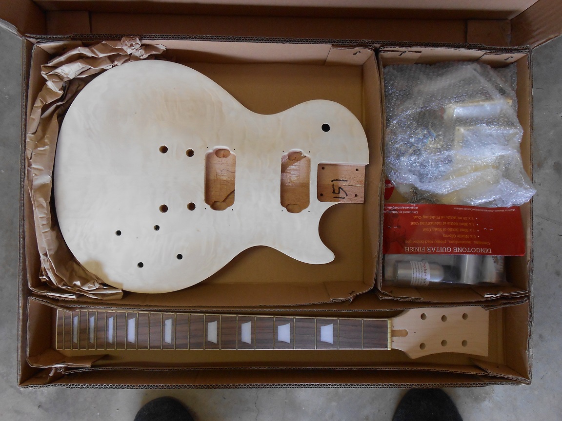

    Unpacked my birthday surprise and found this much to my delight
    I am very happy with finish as there are no blemishes and little glue. As it is my first build I am thinking of going stock standard as in the box. I guess I can upgrade the electronics later if necessary. Still to decide on colour but Dingotone options look good.

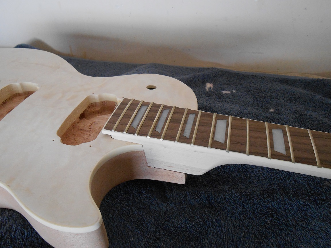

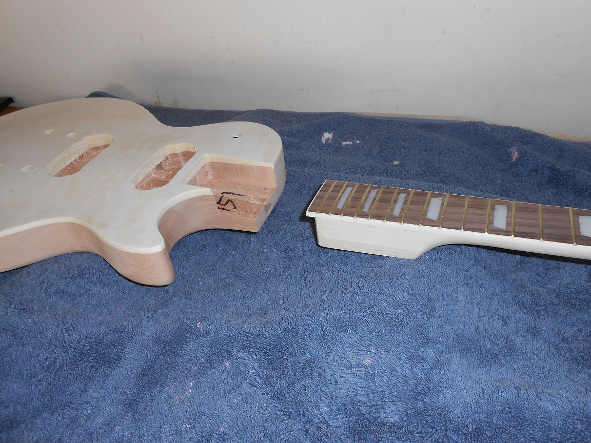

    I started my mock build and step 1 was to put the neck in the body.

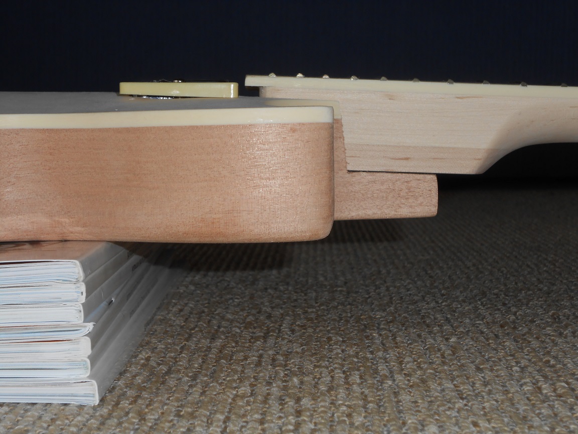

    WHOOPS!! ALREADY??

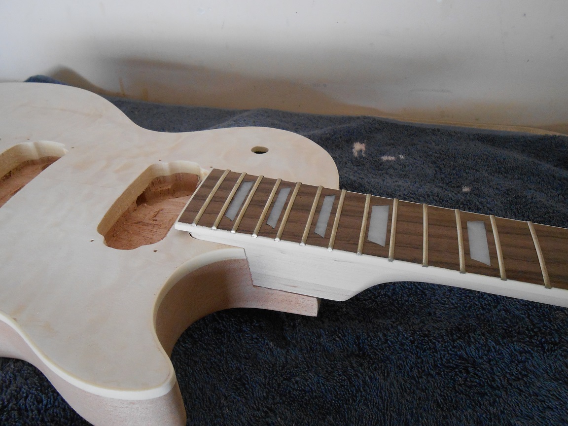

    The fret board is not sitting on the body. It is up 4 mm. Does that mean enough would has not been taken of the neck or out of the neck slot. Or does a scratch pad go between. There i3 no scratch pad in the box.

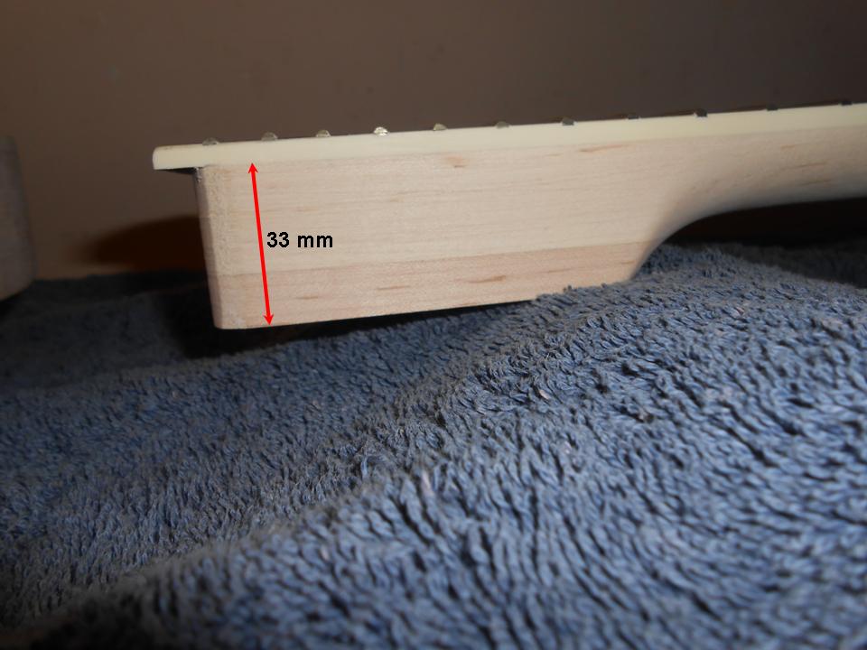

    Dimensions in next post

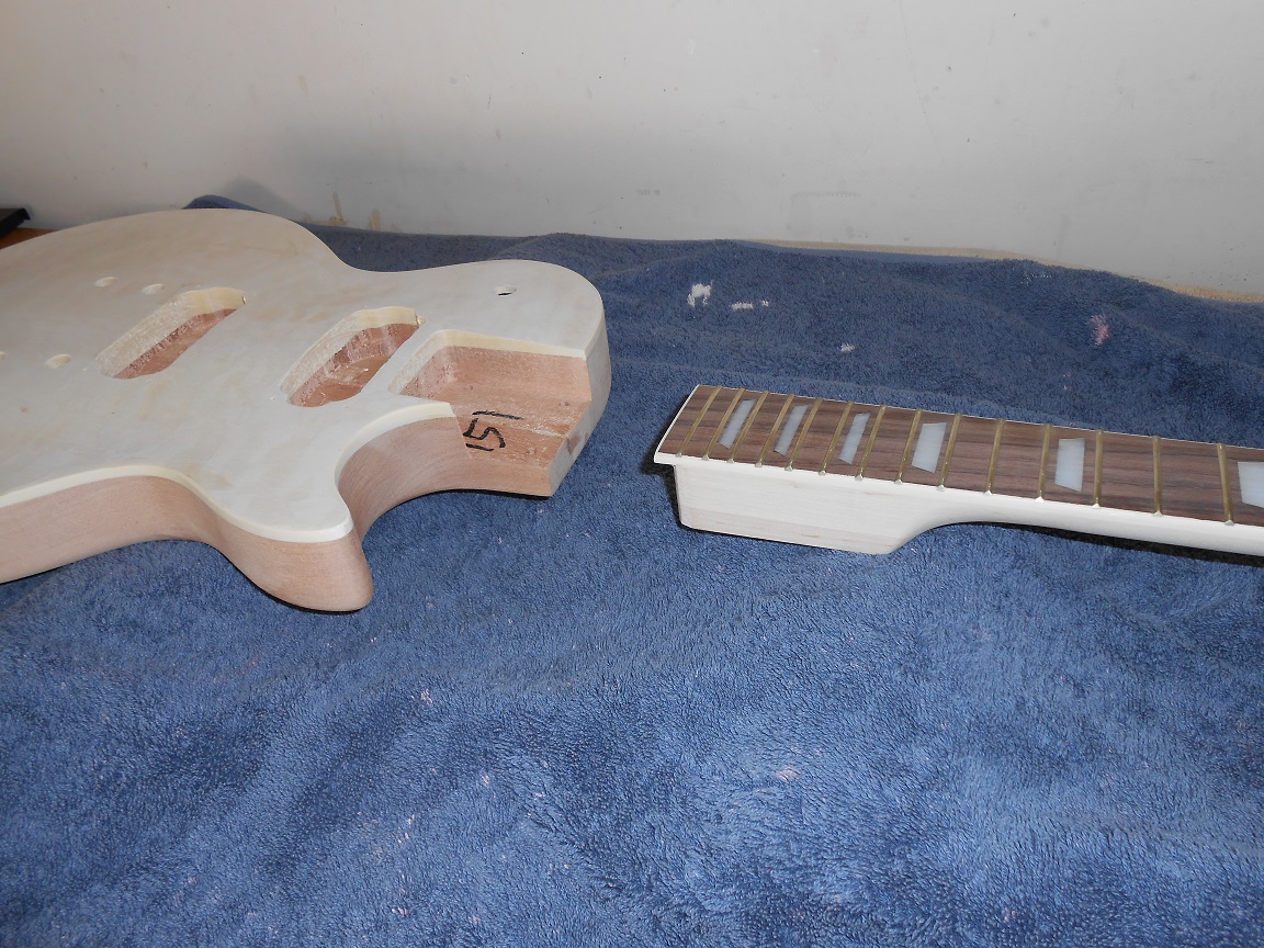

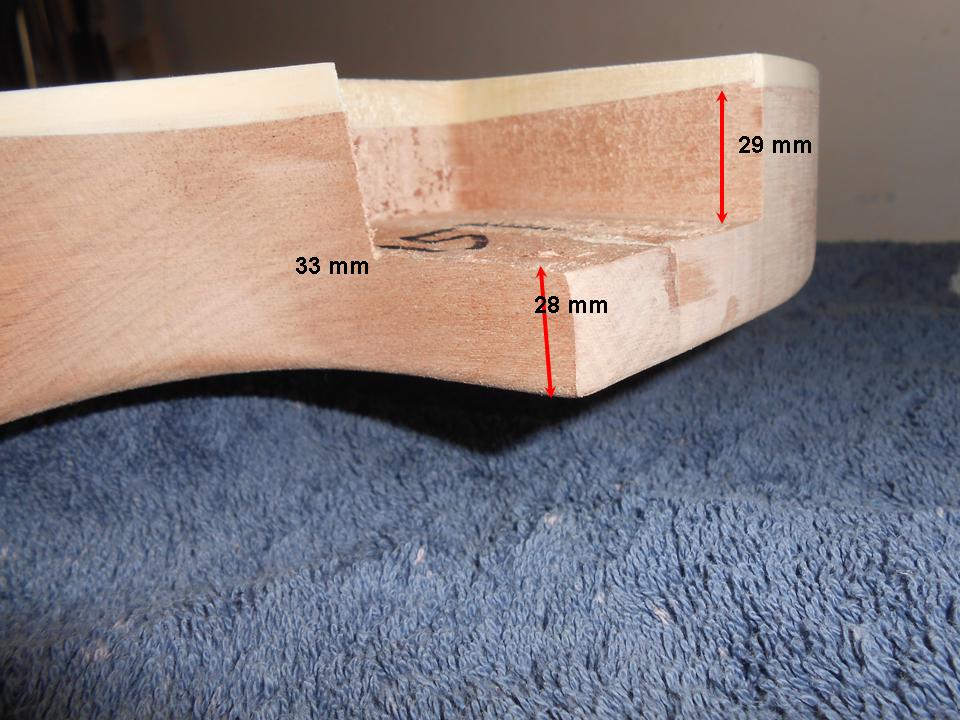

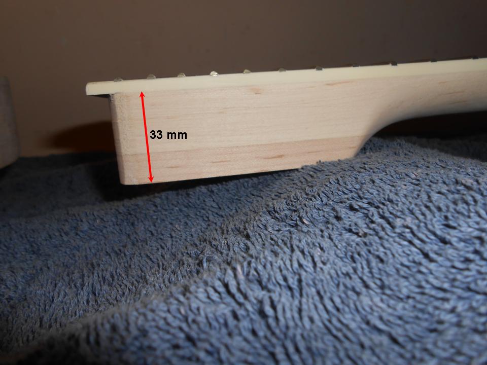

    Dimensions

    Hi Greg nice looking kit. The neck looks ok, the fingerboard will sit about 4mm above the body. There should be a break angle on the neck about 3 or 4 degrees to compensate for the height of the tune o matic bridge.
    If you want a pickguard email Adam will send you one if it didn't come with the kit. Personally I wouldn't want to hide that quilted maple !

    Looks like mine. I sanded the heel down so the neck fit. I did it SLOWLY THOUGH. On the base of the heel with a block. Sits much better now. Have a lookat my link in the sig. I had same issues.

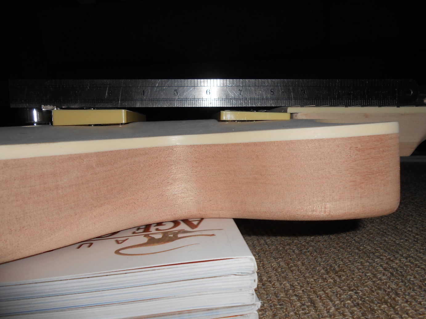

    I have just done a rough measurement of gaps between the strings and pickups
    The neck pickup will be 5.5 mm to the strings. The bridge pickup will be 2mm to the strings.
