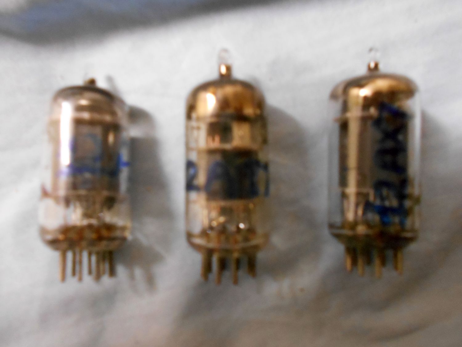

    Following on from my last post, I thought that I would post a pic of some Valves which are commonly used as Preamp Valves in Valve Guitar Amps, so here you go:

    On the left is a 12AU7A, it produces the lowest gain of the three Valves you see in the pic, the 12AU7 Datasheet gives a figure for gain-factor of 19, so theoretically, the output signal is 19 times bigger than the signal at the input, next is the Valve in the middle and it is a 12AT7 with a gain-factor of 60, i.e. output signal is 60 times bigger than the input, and the Valve on the right is a 12AX7 with a gain-factor of 100, i.e. output signal is 100 times bigger than the input.
    Personally, I haven't actually come across a Guitar Amp that uses a 12AU7A Valve in it's preamp, but I think the closest would probably be an original Fender Bassman (the yellow tweed model from the 50's) it used a 12AY7, which has a similar gain-factor as compared with the 12AU7A (they both have the same pin-out), on the other hand, the 12AT7 was used a lot in Fender amps as a Reverb Driver Valve, the Fender Twin Reverb is a classic example, and finally the 12AX7 was used a lot in the early Marshall Amps due to their high gain-factor of 100, the 12AX7 was also used in the Fender Twin Reverb, but Fender used the 7025, which is the lower-noise version of the 12AX7, you will also see a Valve called an ECC83 used in Marshall amps too, this is the British/European equivalent of the 12AX7, with the same technical specs, the 12AU7, 12AY7, 12AT7, 12AX7, 7025, and the ECC83 all have the same pinouts (the way the internal elements are connected to the Valve Base pins), and is as follows:
    If you look at the base of the Valve with the pins facing towards you, you will notice that there is gap where a pin should be, the left-most pin to the gap is pin one, and the pins are numbered in a clockwise direction from pin one, each pin serves the following function:
    Pin 1, Plate of Triode 1.
    Pin 2, Control-Grid of Triode 1.
    Pin 3, Cathode of Triode 1.
    Pin 4, Heater Filament.
    Pin 5, Heater Filament.
    Pin 6, Plate of Triode 2.
    Pin 7, Control-Grid of Triode 2.
    Pin 8, Cathode of Triode 2.
    Pin 9, Heater Centre-Tap Common.
    Incidentally, because these Valves have two-identical Triodes within the glass envelope, they are all known as Twin-Triode Valves.

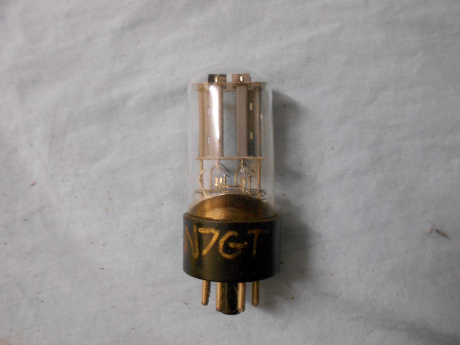

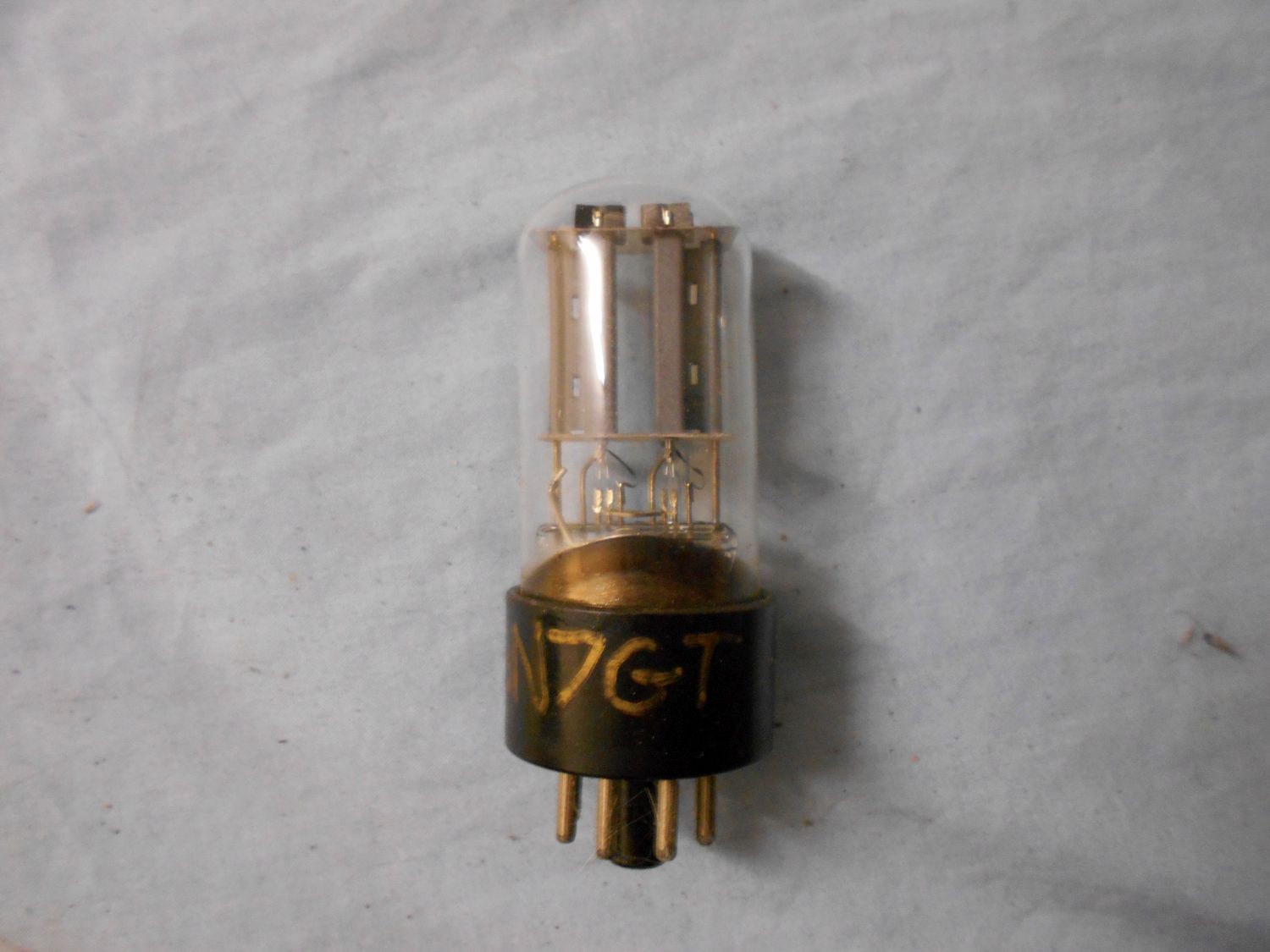

    Here's a pic of a larger Twin-Triode Valve, called a 6SN7GT, it uses what's called an Octal-Base (8-Pins), from looking at the data sheet, it has a gain-factor of 70 for each Triode, i.e. the output is 70 times larger than the input, they can be used as a preamp Valve or as a Power-Valve, I have actually built a working Valve amp that used one of these as a Power-Valve so it does work:

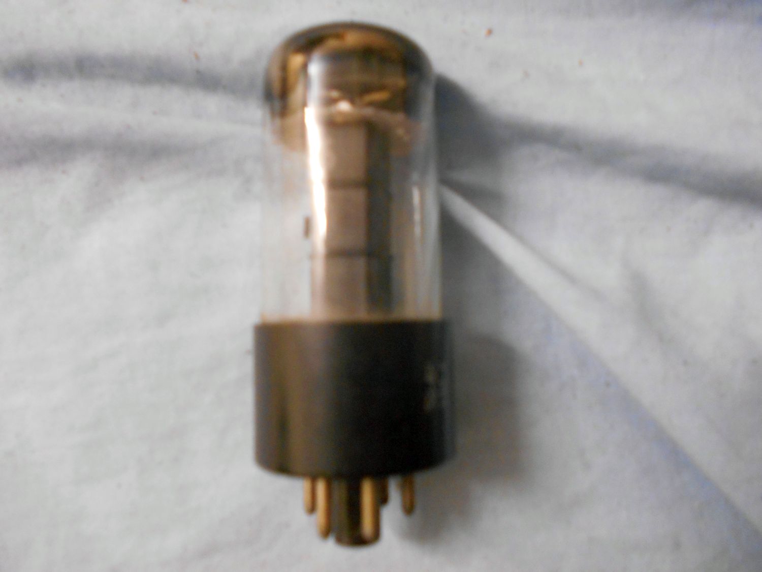

    Here, we will take a look at some commonly used Power Valves:
    Firstly, here's a 6V6GT Valve which is used in some Fender amps, you could think of it as a lower-powered version of the 6L6 which is also used in Fender Amps:

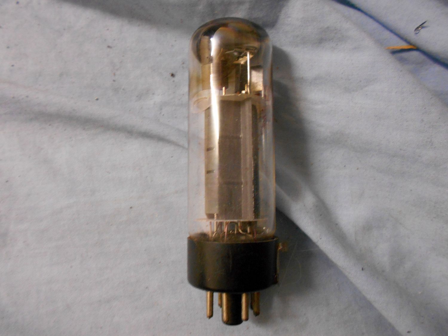

    Next is an EL34 Valve, these are commonly used in most Marshall amps:

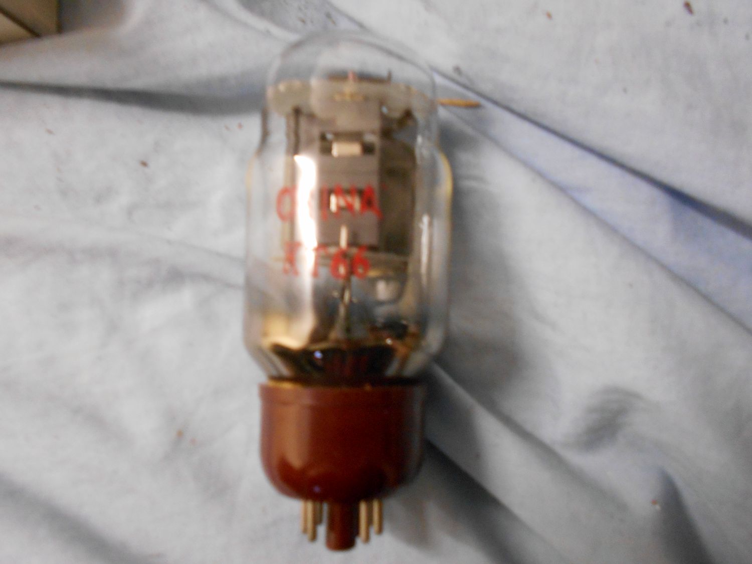

    And finally here's a KT66 Valve, these are apparently very similar to the 6L6, the KT66 was used in the Marshall Bluesbreaker Combo Amp, made famous by Eric Clapton during his tenure as a guitarist in John Mayall's Bluesbreaker band:

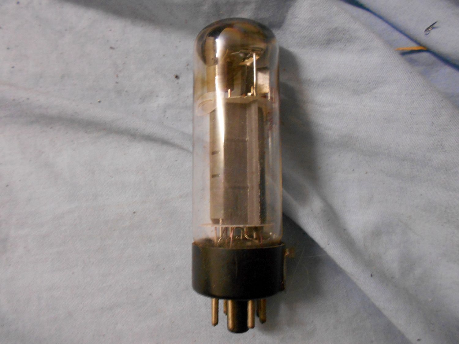

    Unfortunately, I don't happen to have an EL84 Valve in amongst my stash of Valves, so if anyone can chime-in and post a pic of one, feel free to do so.

    I'll post a pic of an EL84 tommorow, unless someone beats me to it. I THINK one of my Orange amps has EL84's.
    The Fender Bassman was is also very popular for blues harp.
