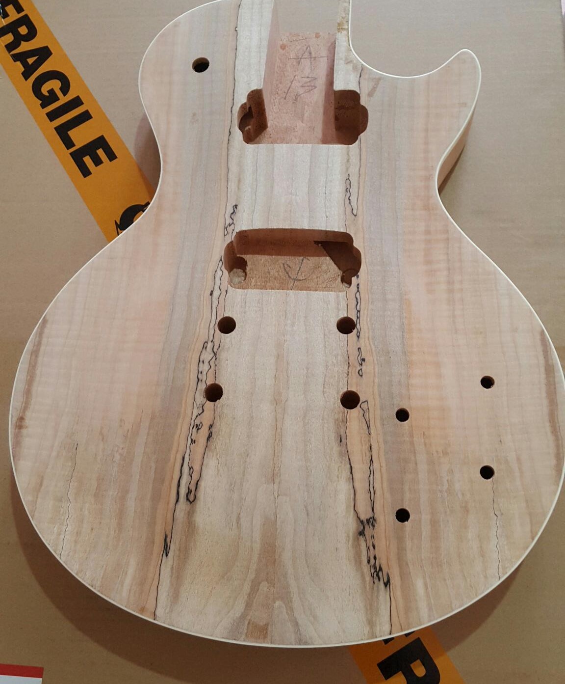

    How awesome to get some replies to help me out. Im even more keen now.
    so, my very first step
    1) is the mock build and check it out especially for neck straightness etc
    2) wipe over with water or Gum terps for any possible glue marks or stains.
    3) Give the whole body and neck and head a light sand with 300-400 grit.
    4) whilst waiting for my stain to arrive, should i think about a black stain to highlight the wood grain, then sand back before the red dingotone?
    photo soon.

    Quote Originally Posted by josh View Post
Name:	guitar top (2).jpeg
    MMM, Spalty goodness.....You have my envy young man. That is a very fortunate alignment of spalt lines to neck/bridge hardware, quite cool really.
    If you want to grain pop, you can do a wipe down with a black stain, leave it a bit and then wipe down with a heavily dampened rag to remove the excess stain. I would probably want to shy away from sanding back.
    Another technique some have used is to get a hold of Ebony coloured Timbermate wood filler, take small scoop of it and pop it in a plastic container and add water then work it until its like a slurry, think thick soup consistency. you mask off the sides and the binding and then you work this slurry onto the face of the guitar. It will dry out ash grey fairly quickly. Leave it maybe a half a day or overnight and then sand back to the wood (but don't go too far, you're only trying to take off the timbermate). This should both fill the grain of the maple and highlight the spalt and any flame you have in the grain.
    You can also use this to fill the grain on the back and sides.

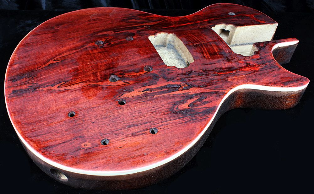

Name:	red guitar.jpg
    Will the dingo tone Karijini Red make the black pot like this picture or should i use the timbermate ebony filler first to enhance the grain?

    I don't know what the Karijini Red will do over spalt, but on my quilted top it didn't make anything as dark as in that picture.
    Timbermate is like magic though. I used it for the first time a couple of weeks ago, and it sands off with a very light touch, so I reckon you'd be fine if you were careful. You want to tape off everything you don't want timbermate on first, and you almost certainly want to get some kind of face mask because it sands into a super fine dust that'll get everywhere.
    Hopefully someone else can let you know if there are any tricks to using it on spalted maple, but here's the progression on my ash bass from untouched > timbermate on and mostly dry > timbermate sanded off.
