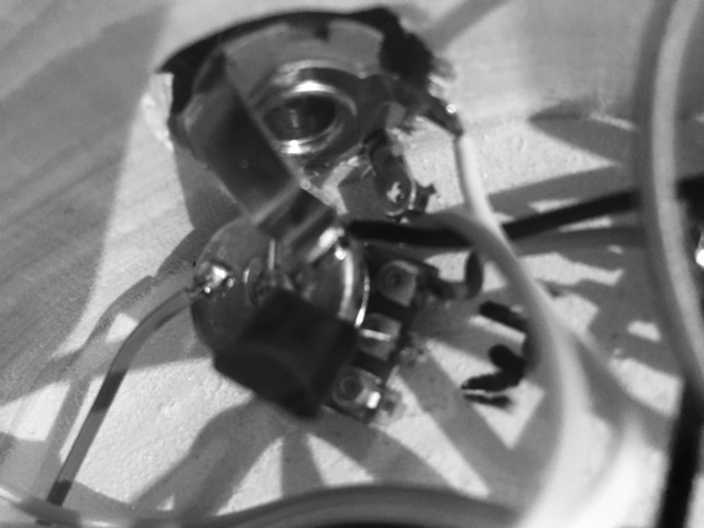

    The jack hole in the SGD-612 probably needs to be moved from the factory settings.
    As you can see from the position, the jack, when inserted, shorts out on the back of the pot.

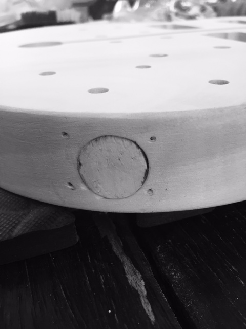

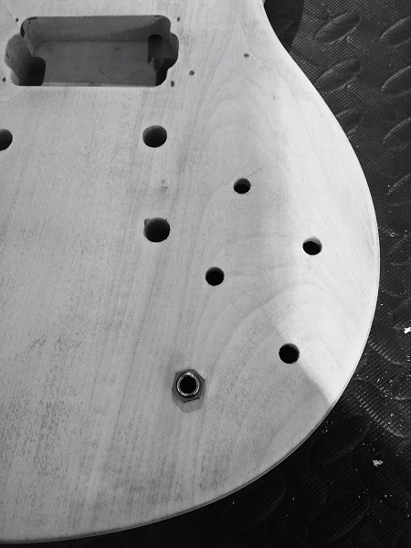

    I plugged my hole, and drilled another one on the top of the body. Its heaps better there.

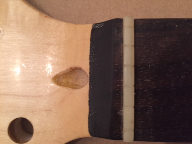

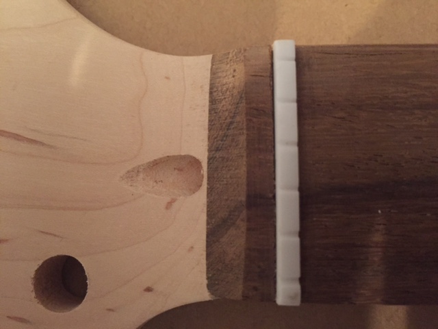

    If I had to be really picky......the kick ramp (ie where the headstock meets the fret board) on the ST and TL kits is on a bit of an angle to the nut slot, here is a photo of my ST kit and the community ST
