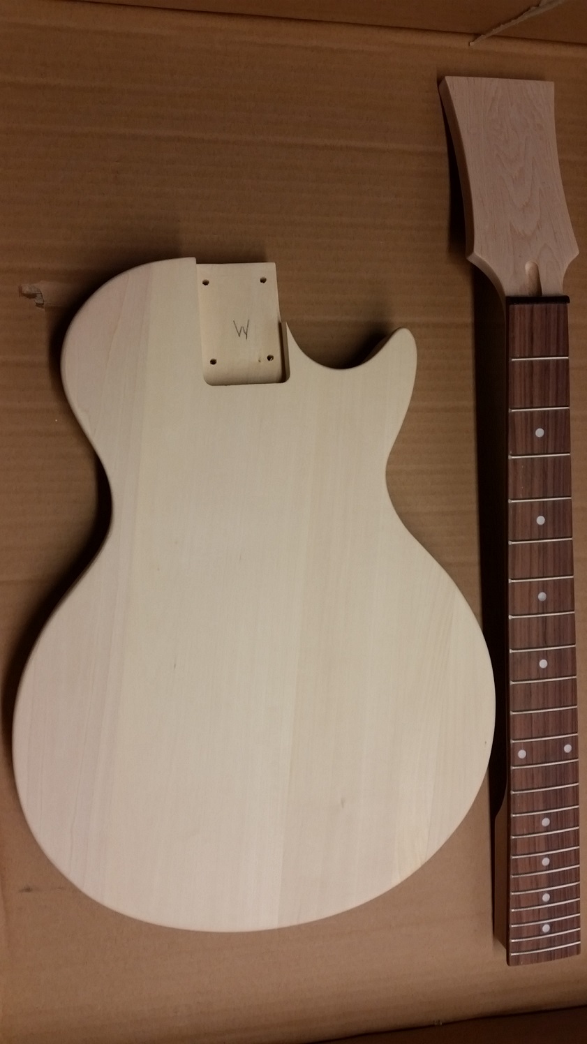

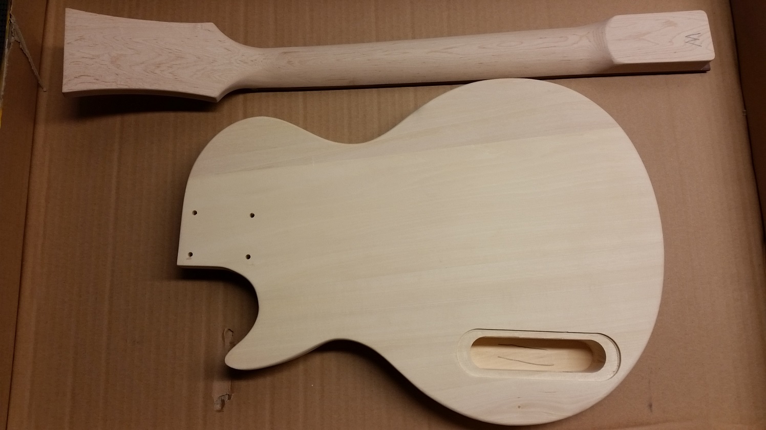

    Custom ordered a JR-1 as just the neck and body with the neck pocket routed, the rest left blank to rout and do with as I wanted (working up to a proper scratch build).
ID:	13412Click image for larger version.

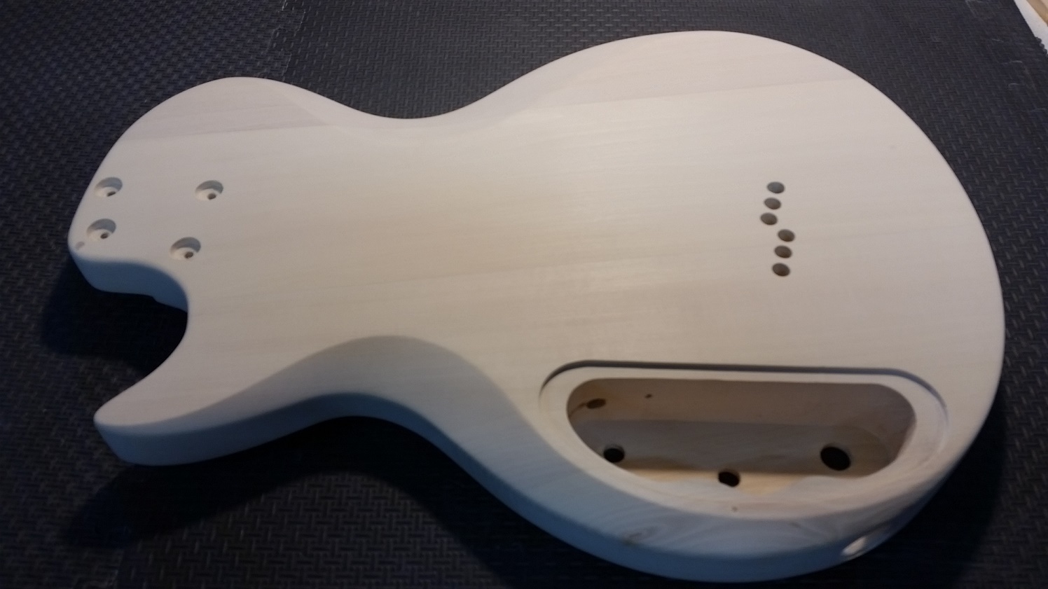

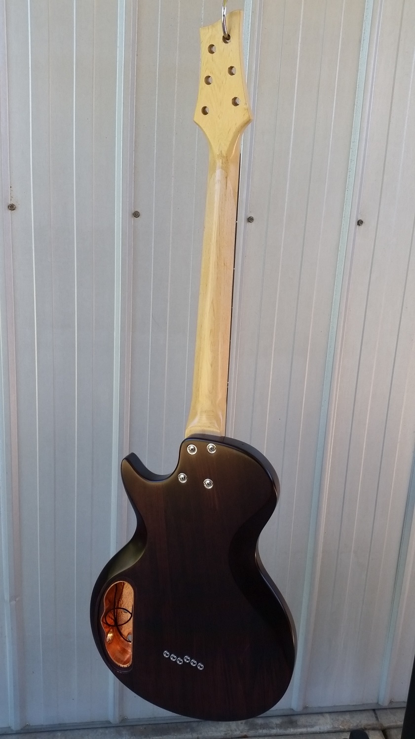

    As you can see, the factory decided to rout the control cavity from the back. I wanted to do my own from the front as the plan was to do something similar to this with a large shaped pickguard.
Name:	PRS S2 single cut.png
    Not a drama, just means there wont be a pickguard on this one and Adam looked after me, so no complaints, only an adjustment to my plans (which weren't set in stone anyway).

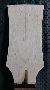

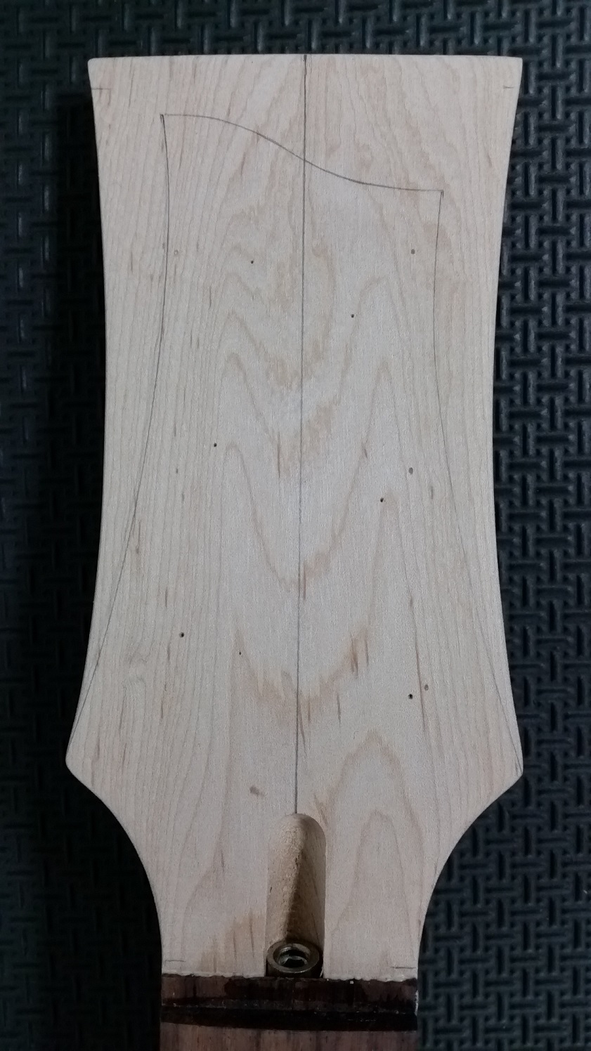

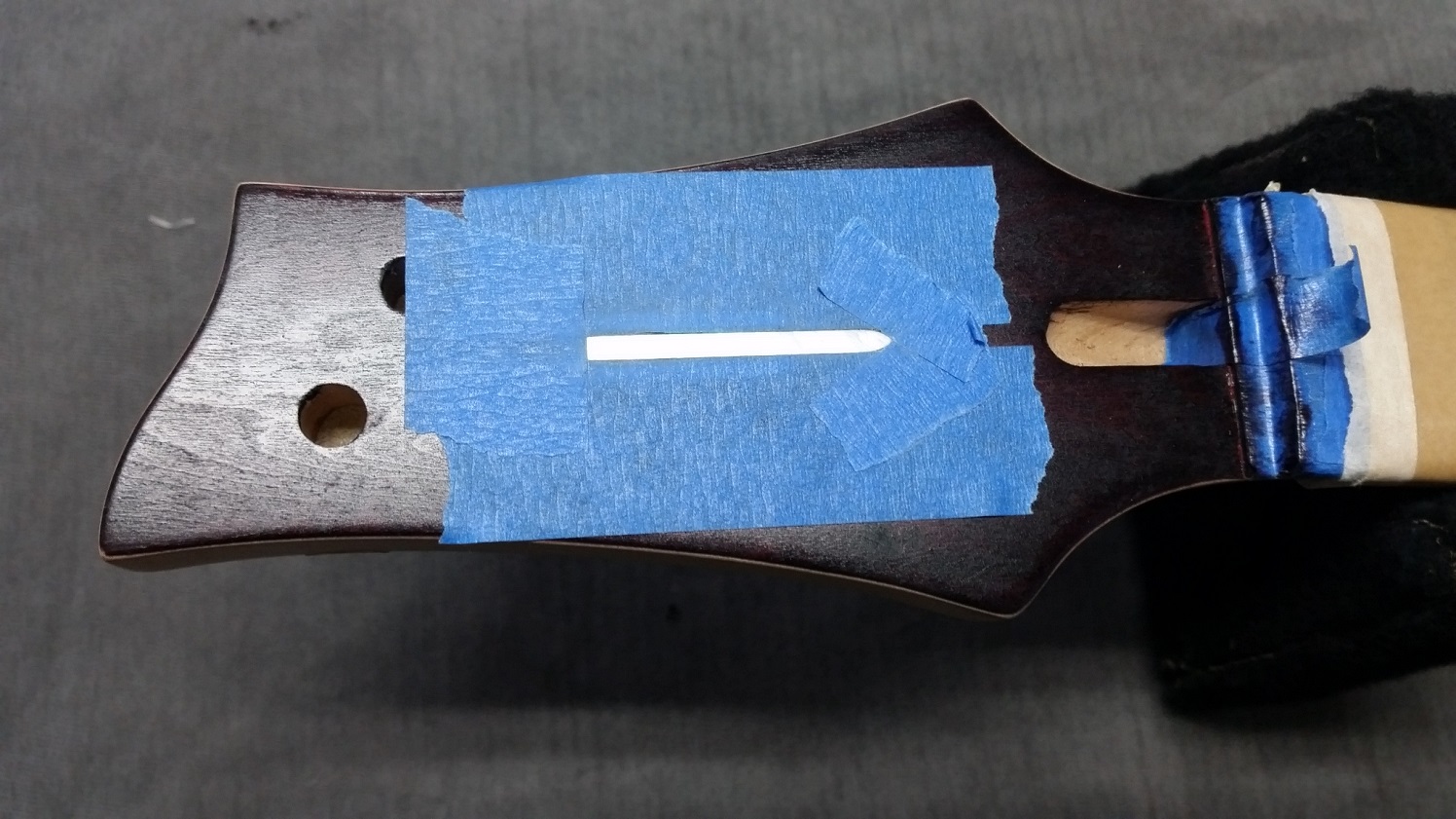

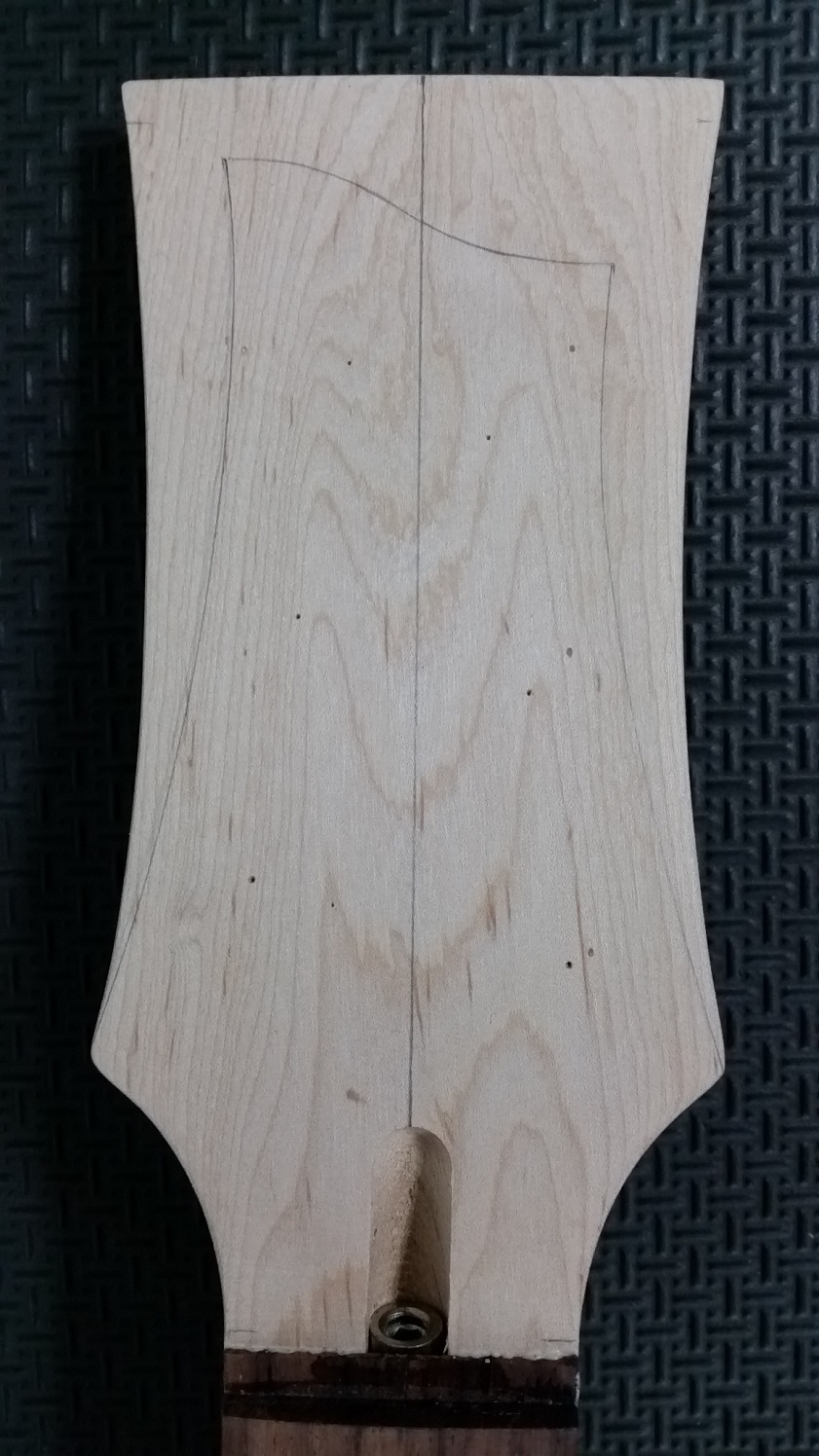

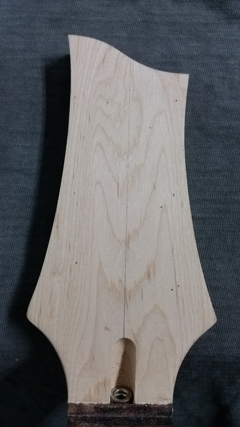

    The grain on the head stock seemed to be calling for a PRS style shape and I obliged but with a different profile across the top.
ID:	13415Click image for larger version.

    Nice headstock shape Neverwas!! You going to be doing similar shaping to the top as the photo you supplied?

    Thanks Zandit. Yeah, going to do some shaping on front and back of the body very similar to that pic.

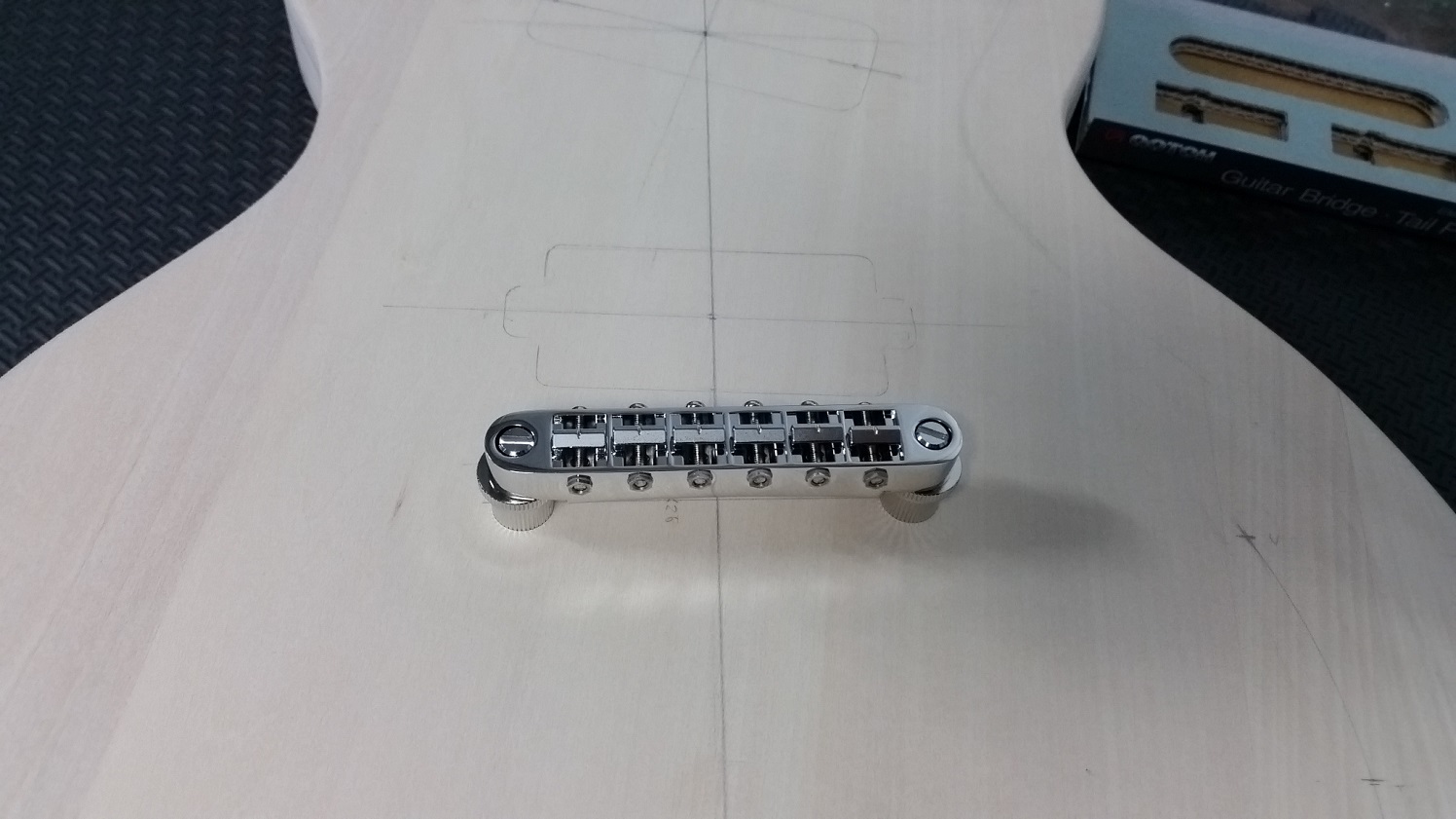

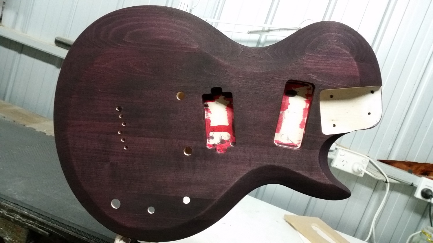

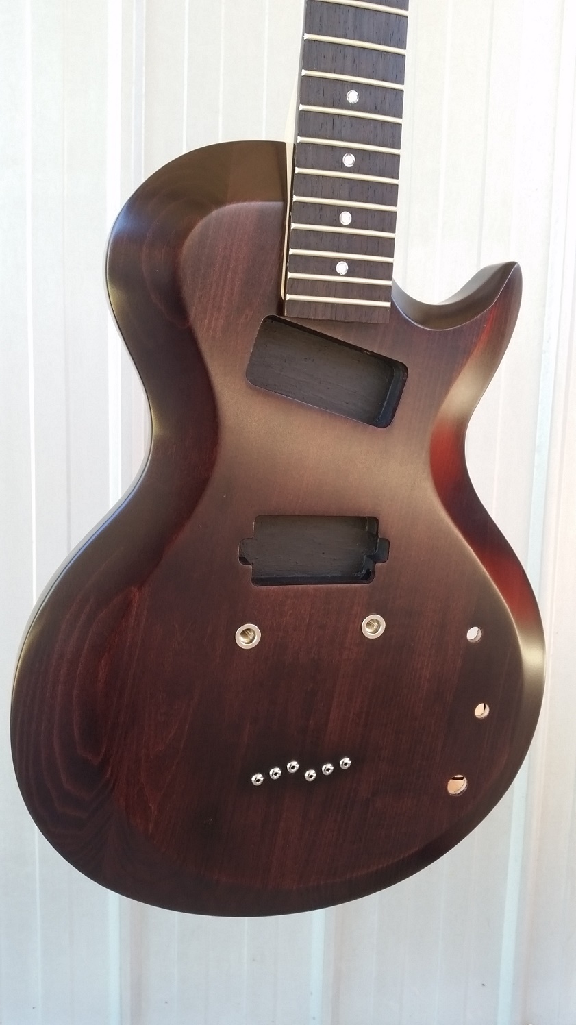

    A bit more of where I'm up to;

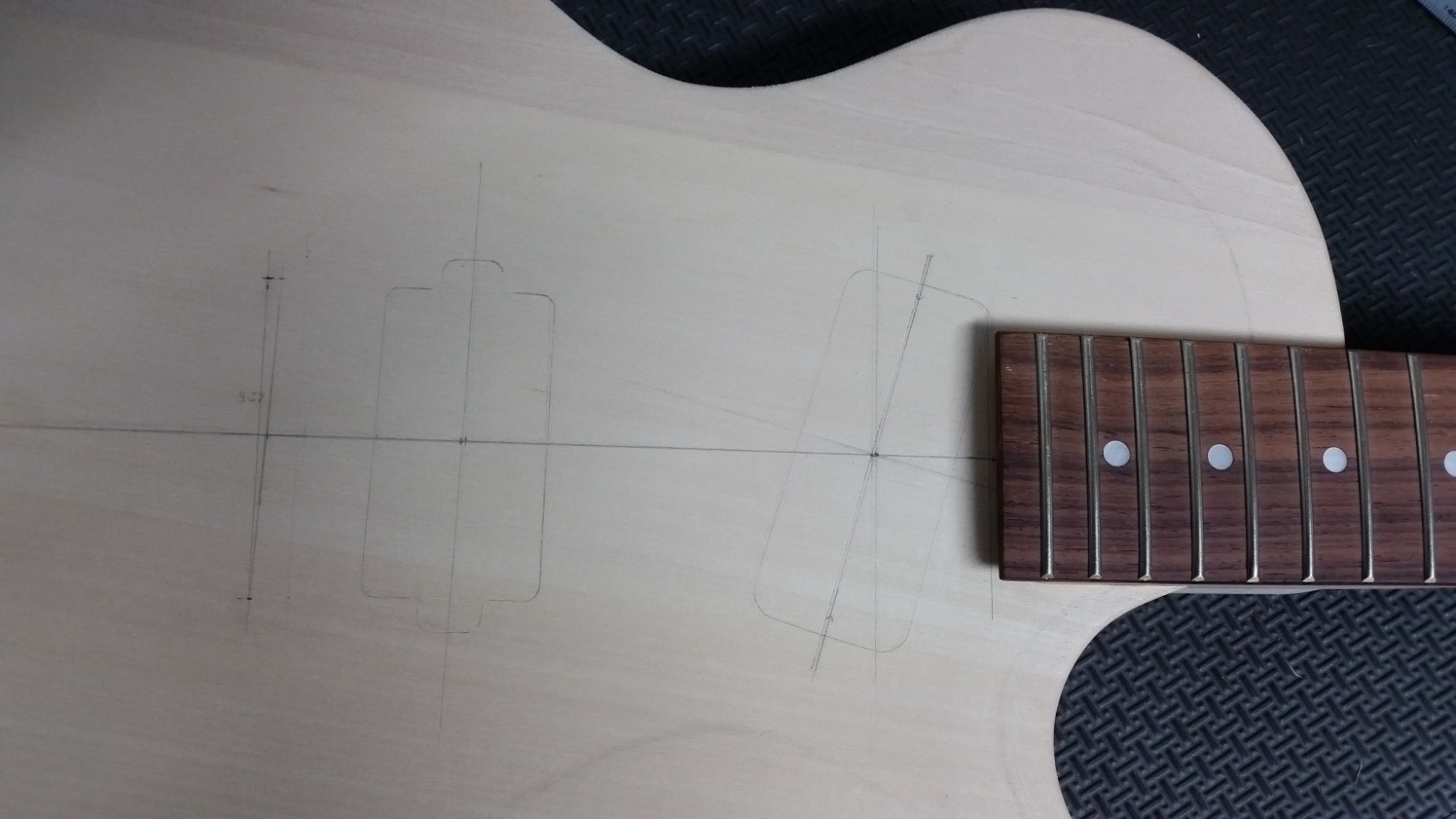

    Marked the centre line on the body and worked out where the bridge and pups were to be placed.

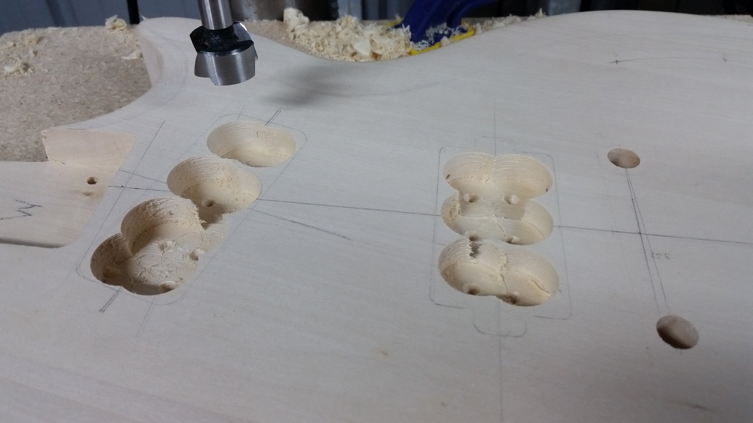

    I figured that while I was having a go at routing the pup cavities, might as well do something a little unusual and put the neck P90 at an angle, just coz I could.

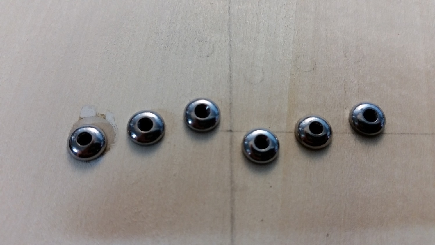

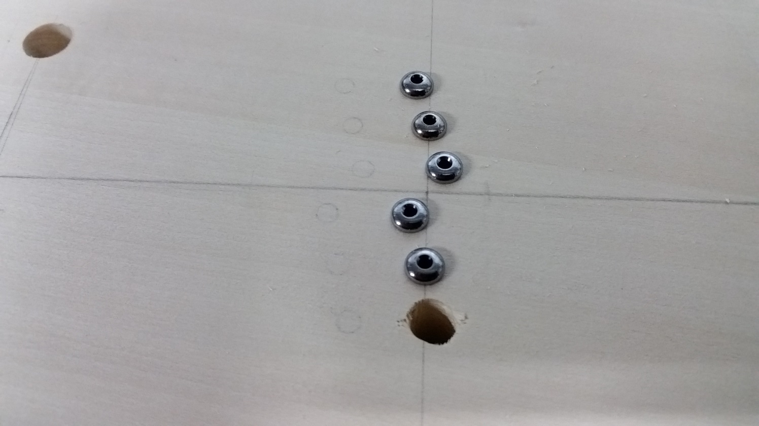

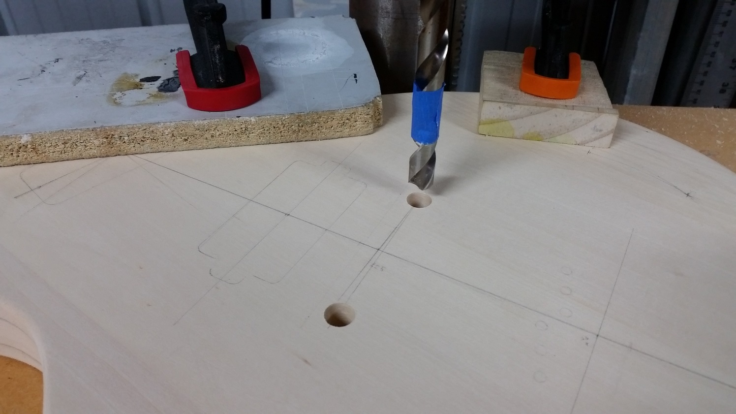

    Drilled the bridge bushing holes on the drill press. Original plan was to use a wrap around bridge but they were out of stock when I went to order, which led to another change of plan and went for a Gotoh tuneomatic bridge and string through ferrules. With the fine knurling on the post bushes, found that a 7/16 drill bit gave the right size hole for the smooth part of the bush to slide in and tight enough for the knurls to grab.
ID:	13420Click image for larger version.

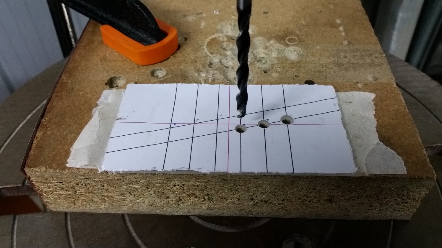

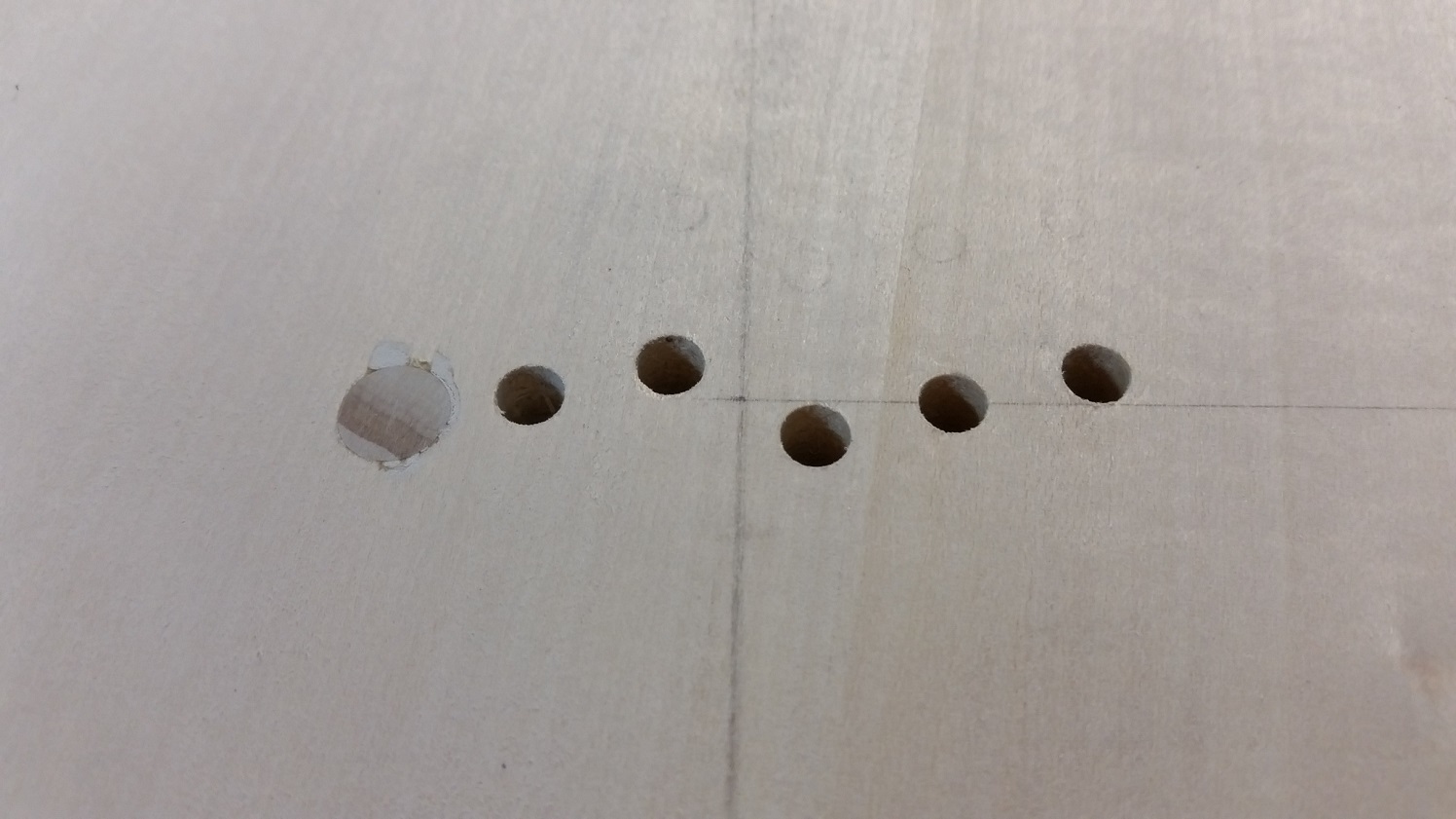

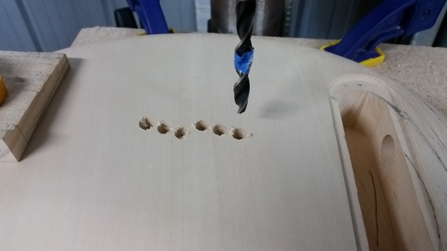

    Then went about making a template from 2mm acrylic sheet for the string through holes.

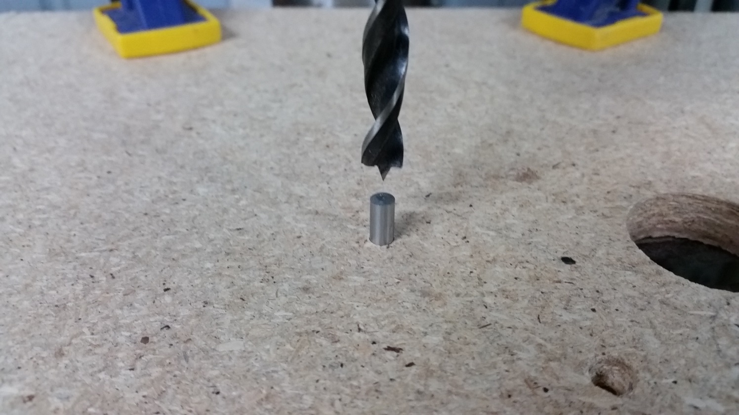

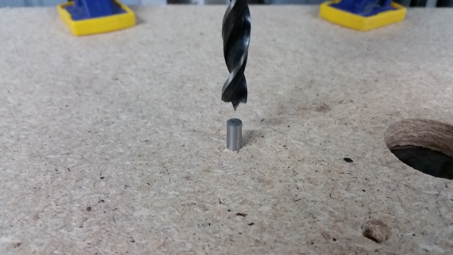

    Found a couple of YT vids that showed to drill (on a drill press) from the front, part way through and flip the body over, use the shank of the same size bit to locate the holes and line up the larger bit to finish drilling through. In this case the front holes are 5mm and the back 8mm.
    The pic explains it better than I can.

    Well, it works well as long as you remember to tighten the clamps holding the body down. Can anyone see a problem here?
    After the red mist cleared and the swearing stopped, I doweled up my mistake and redrilled.
ID:	13430Click image for larger version.
