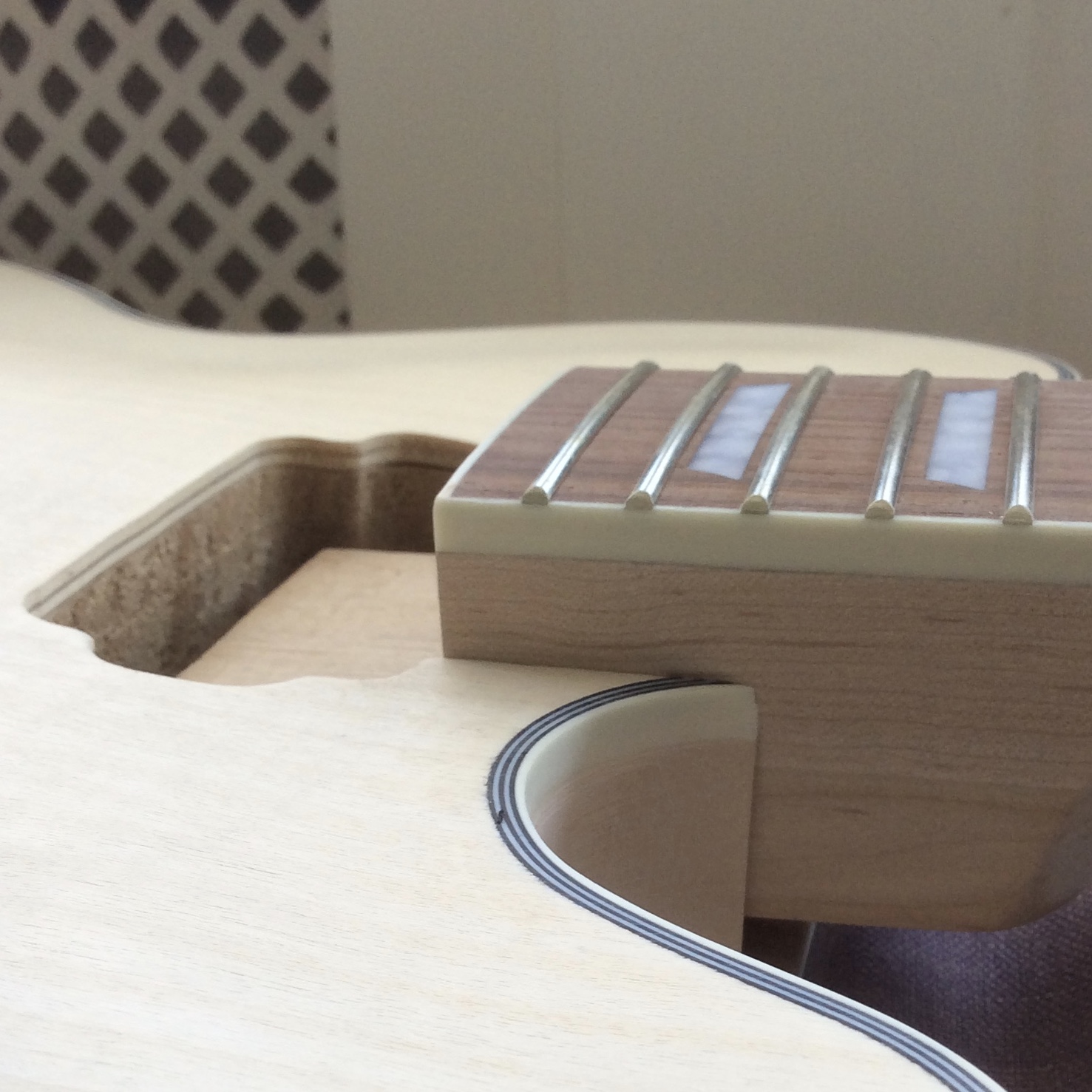

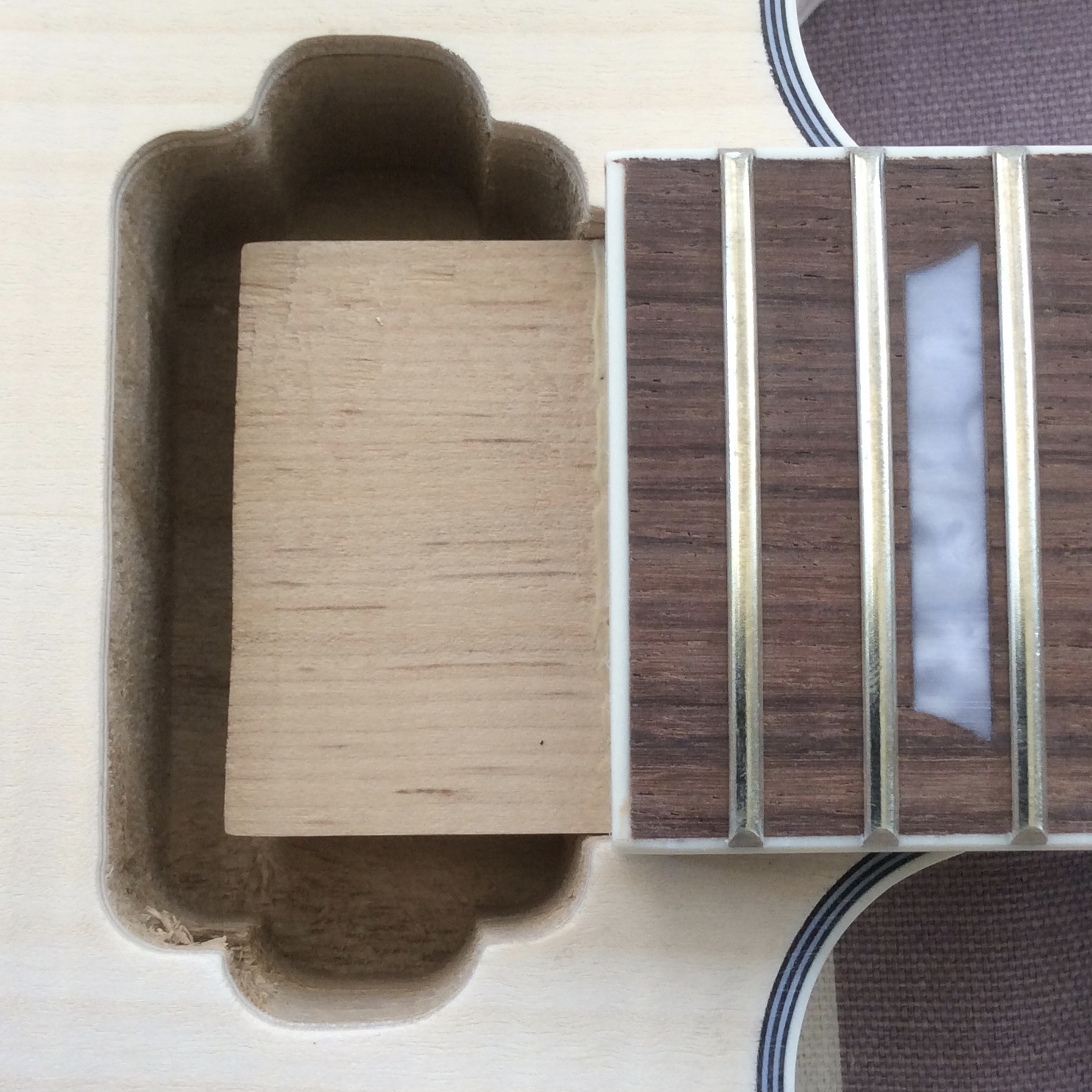

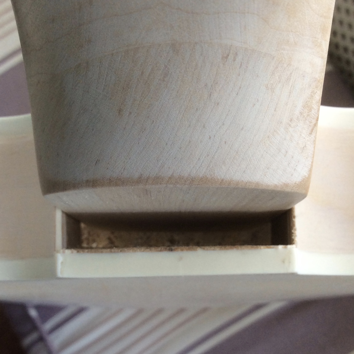

    Okay, so i mentioned the neck...
    During the mock build I've noticed that the neck is slightly too big for the neck hole at the top. see the photos below/attached.
    reading the forum it is clear that the alignment and fit of the next is essential so what is the best solution to get best fit?
    I figure I need to have this sorted before I embark on any sanding and finishing of the body and neck...It may be a simple sanding job to get it all snug but I wanted to check to avoid mistakes so early on.
    Thx

    Hi Friend,
    You will need chisel/sand the neck pocket , NOT THE neck heel,tiny amounts, hammer in the neck with a Rubber Mallet to protect the fret board, a glue in neck can be a challege take of too much will wriggle, it should be a very tight fit, go very slow and be patient, even using a sharp razer blade to cut away a little at a time.
    Hi Sportbilly, I've just seen your question, don't use a chisel, I'd carefully sand the sides of the neck pocket, checking the fit regularly. You should be able to push the neck heel in by hand, don't use a mallet as you may break/split/chip the neck pocket surrounding timber.
    As Honeybadger said try and get a nice snug tight fit.
    Sand both sides of the neck pocket so the neck remains centred
    yep sand the neck pocket.
    also, use a sanding block, not just your fingers - or you will get a wavy result - much flatter with a block.
    ideally the neck should be a firm press by hand fit and you should be able to hold the neck only and have the body stay on.
    if you did it so tight it was a hammer fit, you risk splitting the neck pocket - also way too tight causes too much glue to be forced out of the joint, resulting in having not enough of it holding your neck on
