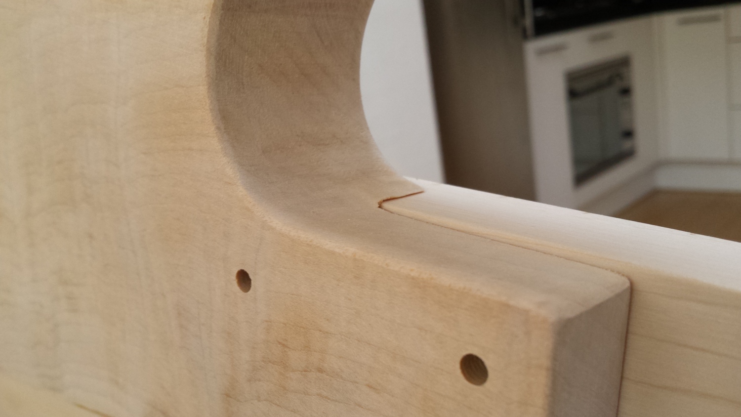

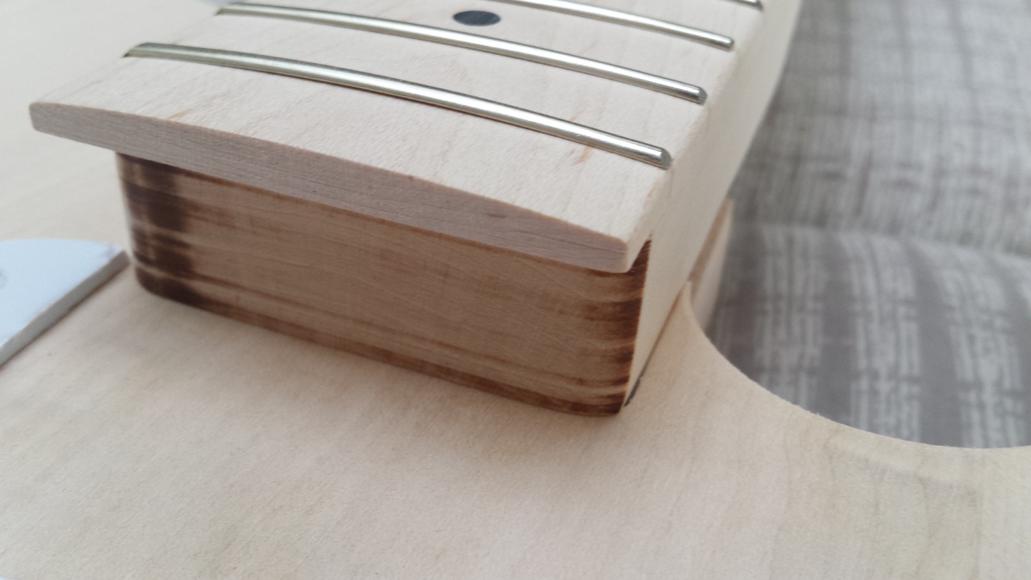

    Mock-up build #1 fitting the neck
    Straight out of the box, the neck just fitted (not) in the pocket: fraction too wide and can't get it all the way in:
    wood at the lower corner pocket seriously stretched after some force. Also the the corner radius of the neck and pocket don't match.

    As this body has no holes for the bridge yet (I checked the 4 point neck alignment tutorial), I decided to sand down the neck at the lower end a little for a comfortable fit and aligned along the long pocket edge. Tried to get is as far in as possible, now at a gap of ~0.5mm.
Name:	2016-07-23 22.15.20.jpg
ID:	12750Click image for larger version.
Name:	2016-07-23 22.15.41.jpg
    Should I continue to get a 100% fit or is a little gap at neck edge OK tonewise? I mean, 90%+ of the contact area is at the bottom anyway and I don't want to risk sanding it too much making it loose...

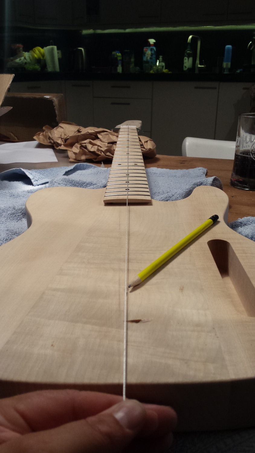

    For alignment, I measured the body width at the widest part, put a little pencil marker half way. A thin wire in the dead center of the neck across all dots nicely lines up with the mark with the neck fully in and pushed towards the long/top side of the pocket. So, time to start drilling the holes in the neck and use this midpoint as the center for the bridge and pickups.

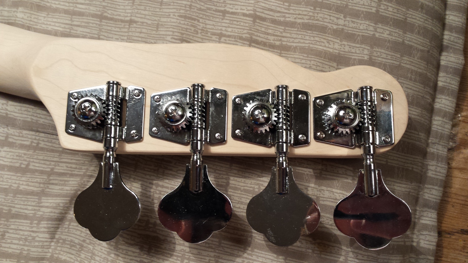

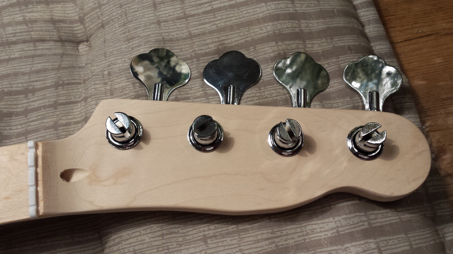

    Mockup build #2: install tuners and attach the neck
    Tonight got the tuners on, aligned them 1 by one, predrilled 1.0mm and later up to 1.5mm.
    Fit will although lining them up was a little tricky as the bushings are about 1mm wide so centering needs to be done by gut feel. Worked out good enough and no screws broke off..
Name:	2016-07-26 21.58.53.jpg
ID:	12786Click image for larger version.
Name:	2016-07-26 21.59.09.jpg
    Then sanded the neck a little at the sides, got a comfortable fit, not too much friction.

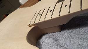

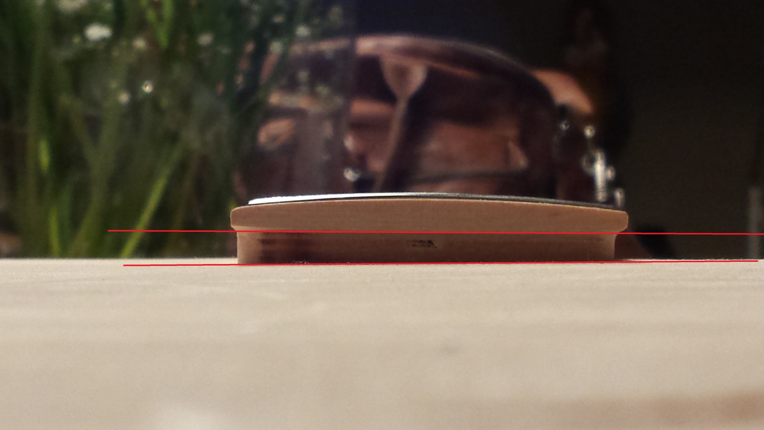

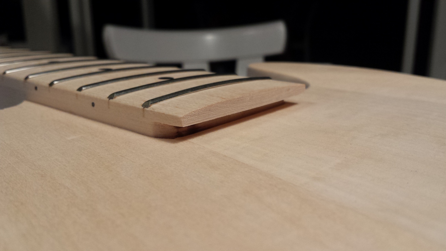

    Start to look like a bass, BUT...

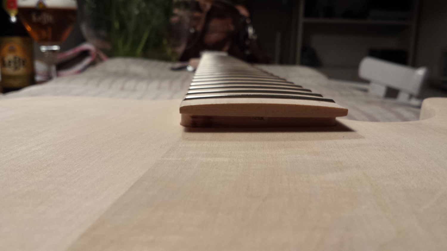

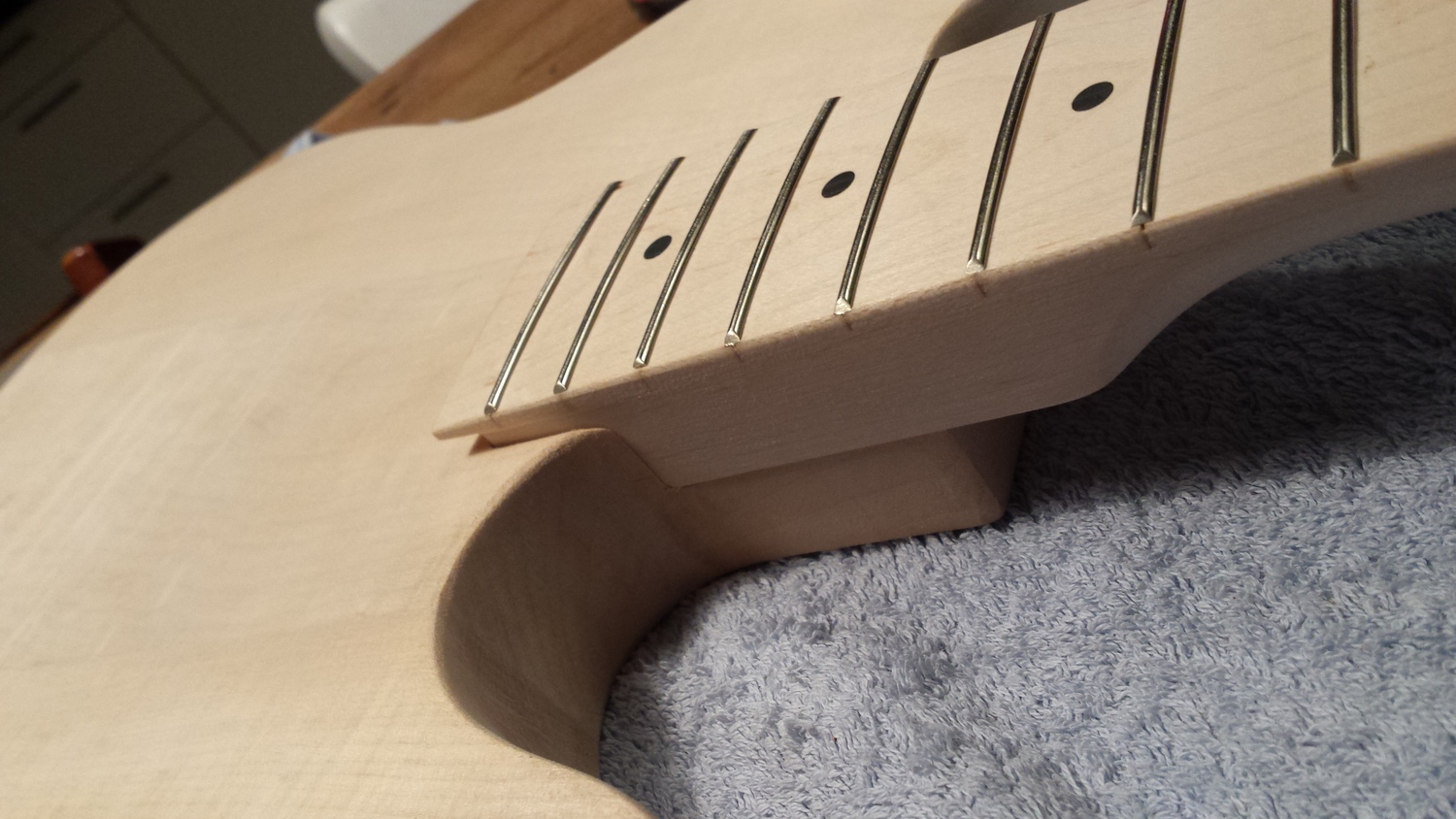

    Closer look from the front show a slight angle on the neck across the body. It's in the neck pocket, saw it earlier.
    I know I sanded the fret board a little at the edges but it's still there...
    I think I need to sand down the pocket towards the side a little to level it. Or I can leave it as is and compensate for it by adjusting the saddles and pickups, but sounds like a compromise to early.
Name:	2016-07-26 22.00.45.jpg
    Any thoughts on this?
