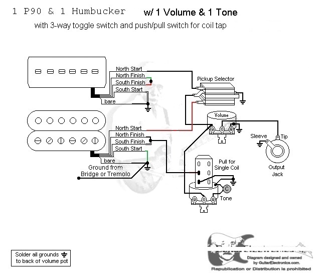

    For my next build, considering using a P90 in neck position and a humbucker at bridge.
    Thinking of Kent Armstrong noiseless P90 (4 wire) and maybe Tonerider AC2, also 4 wire, one vol, one tone, 3 way switch, with a push-pull to split humbucker to slug coil.
    Haven't found a wiring diagram for that combo, so have edited a 2 HB diagram to suit, I think.
    Will this layout work, or is there a better way?
    Any advice greatly appreciated.
