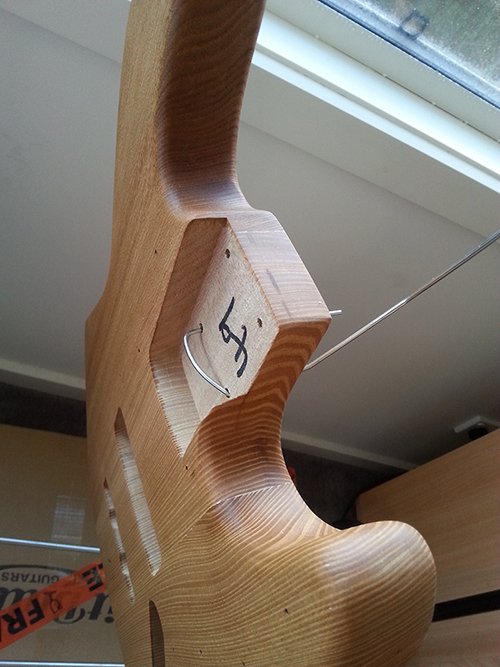

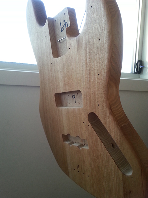

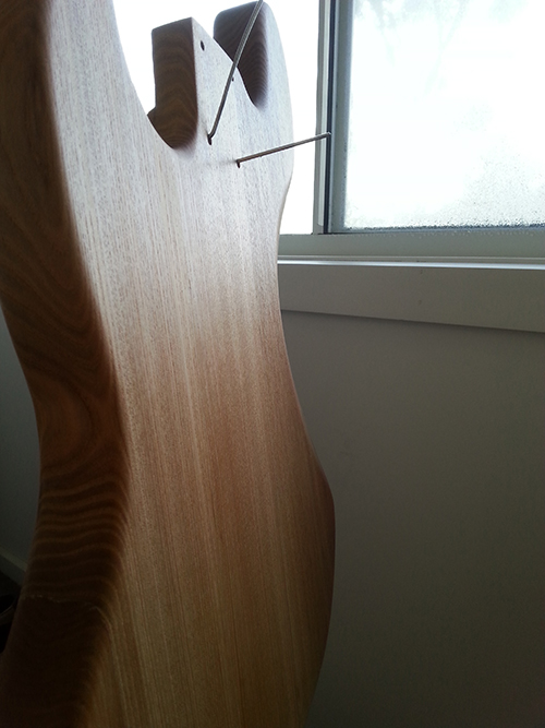

    I have an ash wood body too, sanded again last night and applied the first coat of the colourless kit. I'm really happy with the result, if the intensifying coat adds a little more depth it'll be right where I want it. Will apply the first coat to the neck tonight, I have a maple neck with rosewood fretboard. Should I avoid all contact with the rosewood with the colourless kit ? Is there any finish / process you guys would recommend for a rosewood fretboard ? Removing / replacing frets is a bit advanced for me at this point. Are there finishes I can apply with frets ?
ID:	11510   Click image for larger version.
ID:	11512   Click image for larger version.
    Dude that looks sweet, coming up very nice.
    Hi Rob, that natural ash is looking excellent, I forgot how good ash looks in natural colour.
    Don't put any neck clear coats on the rosewood fingerboard, give it a rub with some super fine steel wool (from headstock to heel with the grain) and get some Dingowax, Dr Axe Wax or some natural oils like lemon or orange oil and rag that on.
    All the maple on the neck apply the neck coats
