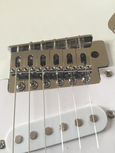

    Hi Im a lefty and Im finish one of my builds. Im not an experience guitar player im just starting out for fun
    i notice that my st doesnt stay in tune mostly g cord low e.
    so I took a closer look at my bridge I think its a right handed bridge can anyone Confirm a right handed bridge and a left handed bridge i think its right handed but i can be wrong
    grooves on the high e seem deeper then the groove on low e i dont know just a question the whamy bar is at the right place so it must be ok

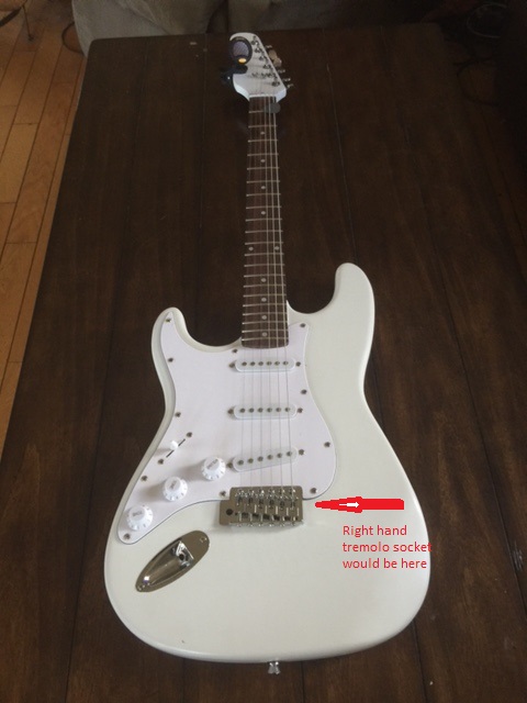

    Hi Canada,
    I think your instincts serve you well regarding the saddle channels. I had to have a look at your larger piccy first.
    That is a left handed bridge (you have the correct one) if it was right handed the tremolo arm socket would be on the other side.

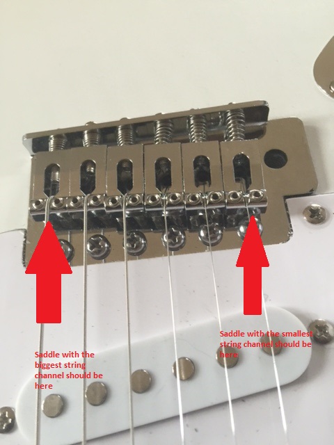

    That being said, I think your saddles are the wrong way around....
    Easy fix, de-string the guitar, unscrew each saddle and swap them around so the saddle with the biggest string channel is for the big E string, second biggest is for the A string, then D...you get the idea.
    Lastly, I can tell by the position of your saddles that the reason why your guitar wont stay in tune is because I don't think the saddles have not been positioned correctly for proper intonation. Which is cool because I think you may need to swap the saddles around anyway.

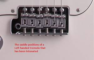

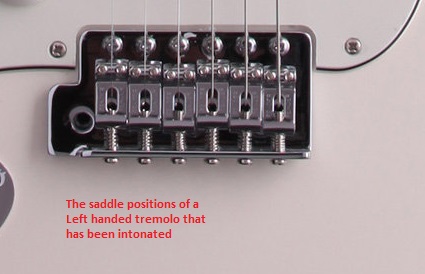

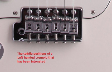

    This is what the saddle position will look like once intoned.
Name:	left inton.jpg
    Have a good read of Gav's tutorial on "Setting up your intonation" http://www.buildyourownguitar.com.au...ead.php?t=2303
    Especially.... "Step Four: Set the approximate positions of the string saddles on the bridge."
