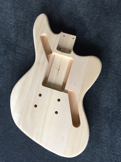

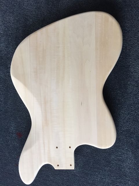

    I specified the JMA body, so I'm assuming that this is ash rather than basswood. I understand from the build blogs that you treat these slightly differently, so let me know if you think it ain't ash! Custom order is drilled for tuneomatic and stop tail, so no rout for whammy / springs. Nice work!

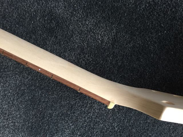

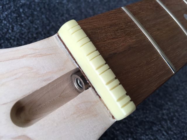

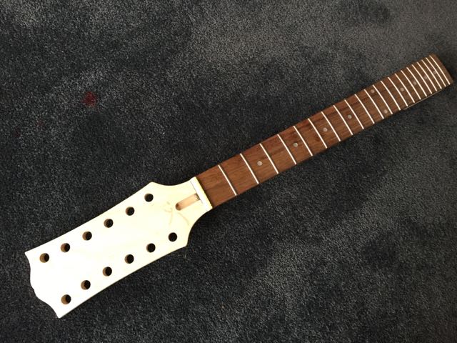

    The neck looks nice. I like the headstock profile and the scarf joint is almost invisible. The nut looks to be well prepared. There are some minor irregularities in the positioning of the holes for the machine heads, but nothing to make me want to plug and re-drill here. I doubt I could achieve even this level of precision...

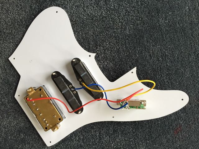

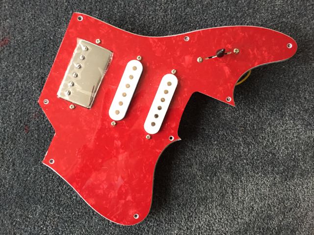

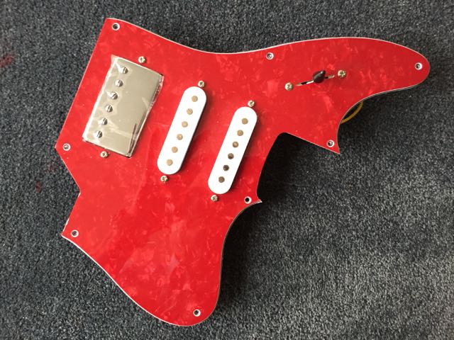

    The loaded pickguard and control panel are standard JM.
ID:	10916Click image for larger version.
    I have no idea of the quality of the pickups but am happy to save any swap outs for down the track. I am mildly dreading doing the shielding - I copper shielded my G&L ASAT many years ago and that wasn't much fun - hopefully I'm a bit more patient nowadays!
    The pickup selector is a 5 way. I've downloaded the Pit Bull wiring diagram but I haven't tried to analyse the combinations, so am assuming standard strat configuration. I put Kinmans in my G&L Legacy a few years ago. Kinman supplies a wiring diagram which configures the three pots as master volume / master tone / neck pickup blend, so you can get 1 + 3 (which I like) and 1 + 2 + 3 (which I seldom use) as well as the regular 5 position options.

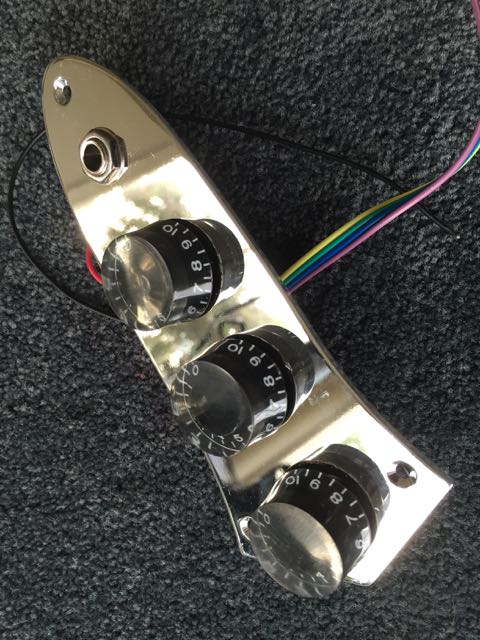

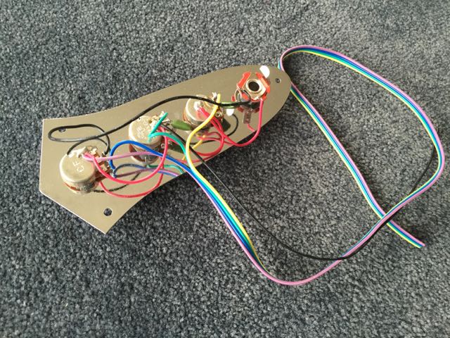

    Here's the JM pot plate:
ID:	10918Click image for larger version.
    Any wiring / rewiring is obviously some time away, but happy to hear any comments or tips.

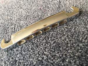

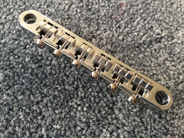

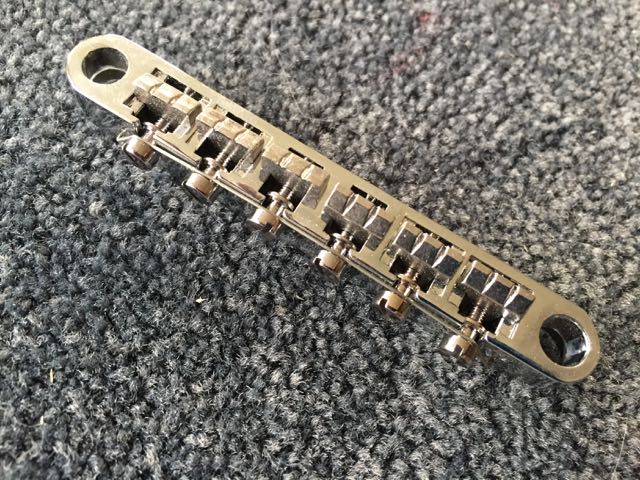

    Here's the stop tail and tune-o-matic.
ID:	10920Click image for larger version.
    They both appear to be chunky and well made. There's no individual compensation on the 12-string bridge, but I figure a) that would probably cost as much as the rest of the guitar and b) I'm probably not going to head up to the dusty end on the wound strings anyway, so my attempts at 8 Miles High are unlikely to be thwarted by this particular feature!

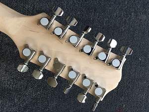

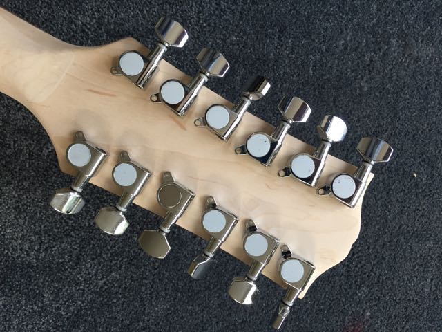

    Acting on advice to a newbie, I checked the machine heads as shipped and - we have six of one and half a dozen of the other! Haven't tested them yet - am confident they will be fine...

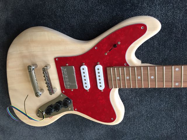

    I laid out the components to get a feel for how the ensemble will work together.
    Having watched a couple of videos on finishing, I'm inclining to go with the DingoTone, but haven't decided between clear natural or possibly the Coolangatta yellow. Natural is ahead by a nose at this point.
    No rush with this... happy to take 6 - 8 weeks. Will keep y'all posted with my progress and / or procrastination.

    Looks like a great kit RJ. I have never considered this combination before, but I like it! I do love a 12 string in any configuration and a JM is as cool as it gets. The body wood does look like basswodd to me ata glance, but I could be wrong. Will be following your build with interest!

    Yep, as Gav said, the body is Basswood. It is a lot softer than Ash but can still come up with some surprisingly nice grain at times. The standard wiring for the JM is set up as a master volume with two tones, but it can be easily modded to master volume, master tone and blend with the stock parts if you want.

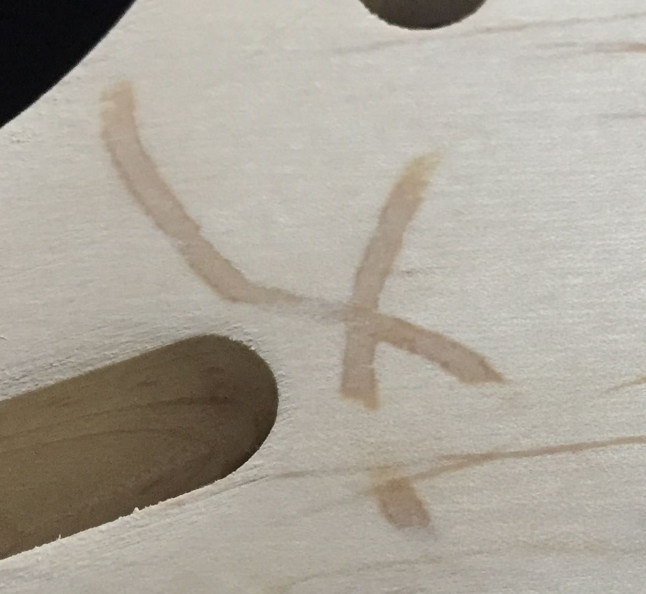

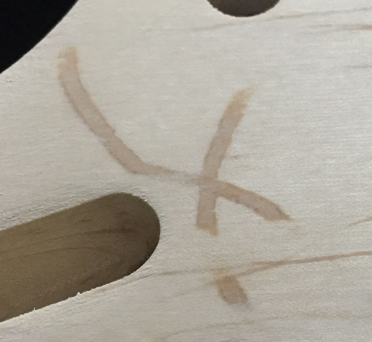

    I've been dutifully sanding away - I'm sure there's more to come - and am wondering what to do about this mark on the headstock.
    Some of it has come out with 180-grit sanding - do I just keep going?
    Is there any real risk of taking off too much wood with a 180 grade assault?
    Or should I be trying some kind of bleach?
