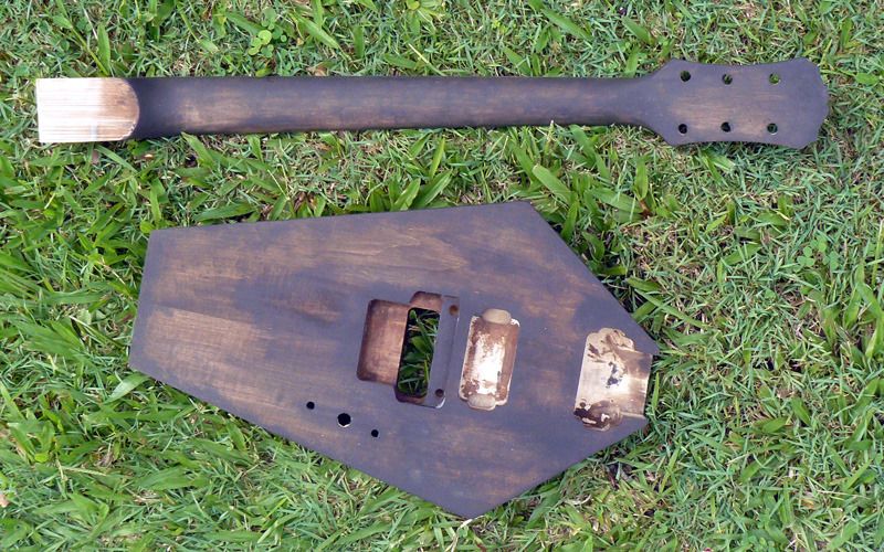

    My name is Ron and I have GAS
    But I don't care!
    Hmm, looky what post bought today direct from the factory
    Neck fits SO well, can't find a flaw anywhere on the kit.
    I have noticed the real Graveyard Disciples have a switch on the top, there is neither rout nor switch in the kit. So I'll put one in between the pots I guess.
    Anyway, already have the black Grovers and Entwhistles here waiting.
    What's the finish going to be? Relic on a level not often seen. Think freshly dug .................
    Thematically appropriate?

    Can't wait to see this relic'd finish, I guess you will paint or stain it black, sand it back a bit then actually bury the guitar body for a few days ? haha
    EDIT I checked out the PBG model pics and there's no switch included. It's a pretty old model so looks like the factory forgot to add a switch. You could swap the tone pot for a blend pot and forget a switch ?

    I'm thinking of splitting the humbuckers so when the time gets closer I'll be asking for wiring ideas I guess. I'm sure there is room in there for a 5 way switch will double check when I get back in the workshop.

    looking at the size of the control plate the control cavity isn't huge, you may need to fill and modify the vol/tone pot holes to make room for a 5 way switch.
    You could put a 3 way switch in, much less space than a 5 way and have 2 push pull pots, volume to split the neck pup and tone pot to split the bridge pup
    as my lovely assistant shows, you maybe right. There isn't a lot of space in there.

    I think a 3 way switch may just fit but will be super tight
    there are plenty of other options just using 2 pots
    Concentric vol/tone and Freeway Ultra toggle switch... for the price of a soul.
    great suggestion Weirdy, what a cool switch - like a 6 speed gearbox
