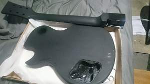

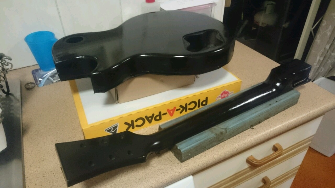

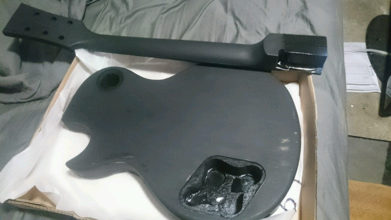

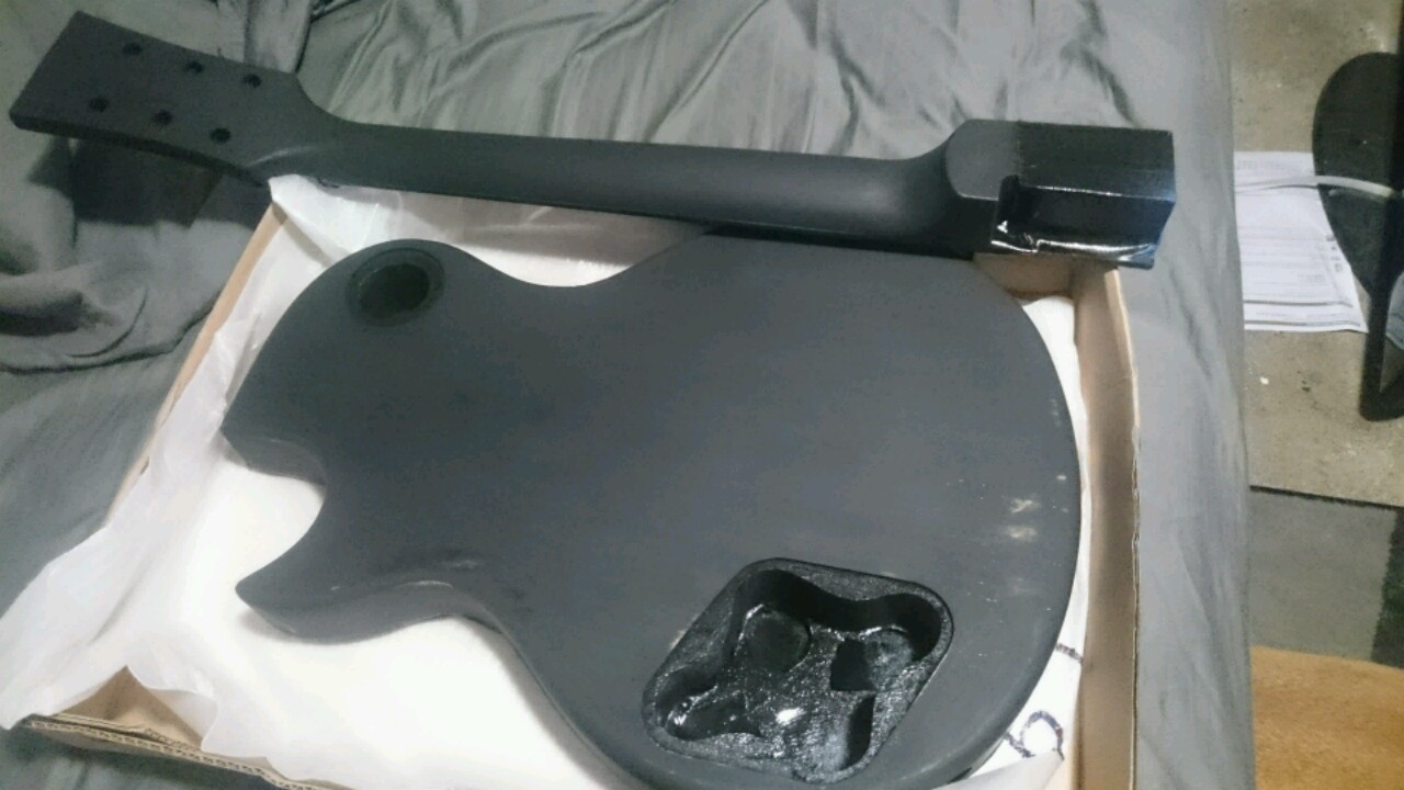

    After my surface prep I started by applying the colour to the back and neck.
ID:	10589Click image for larger version.

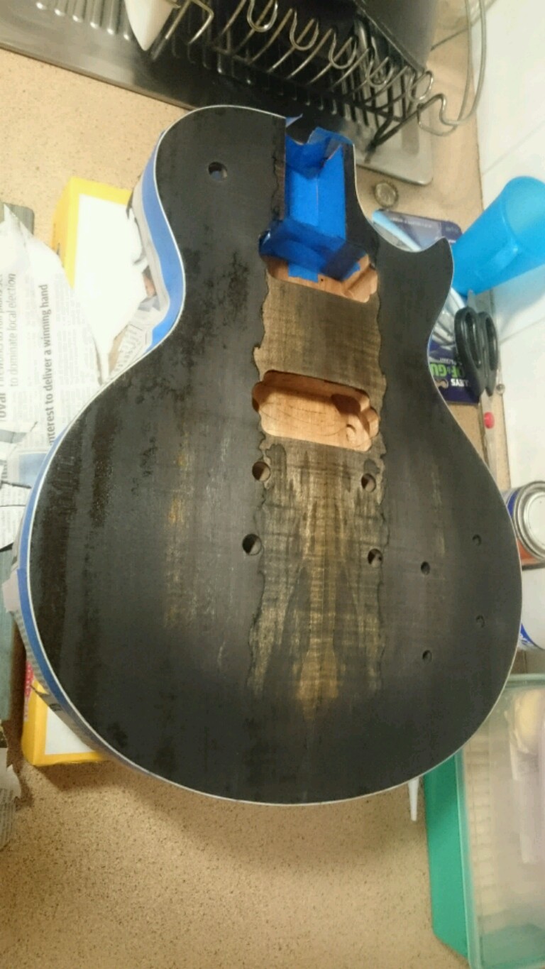

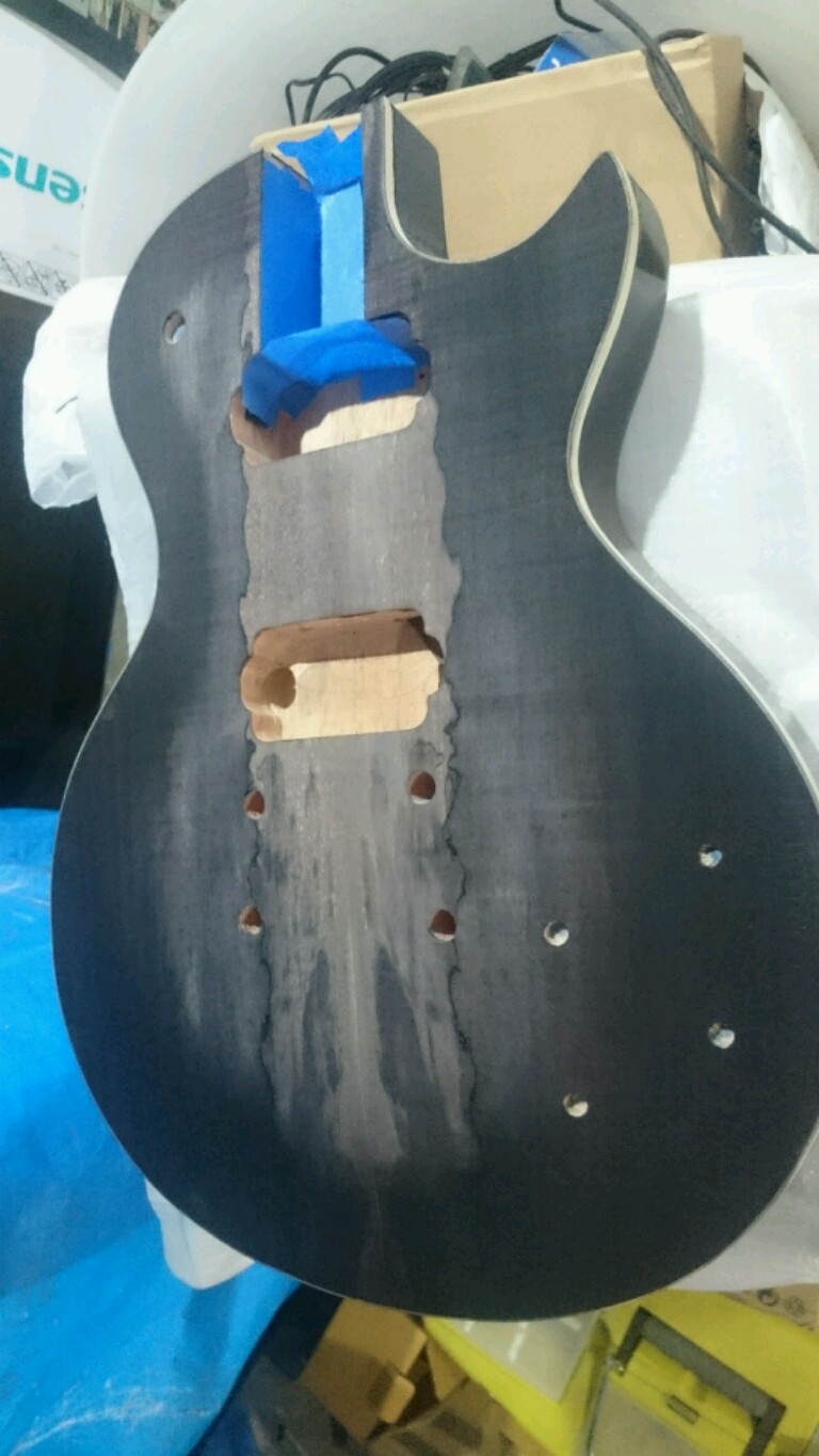

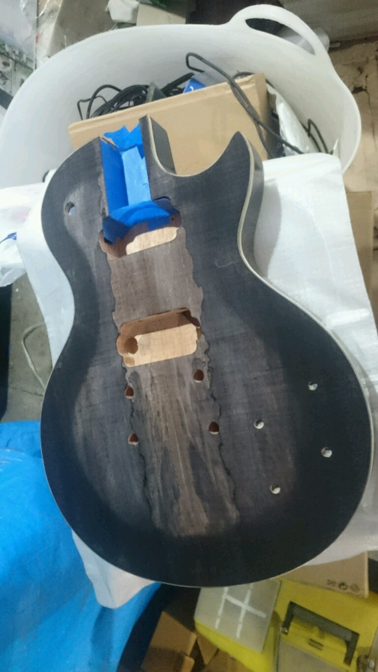

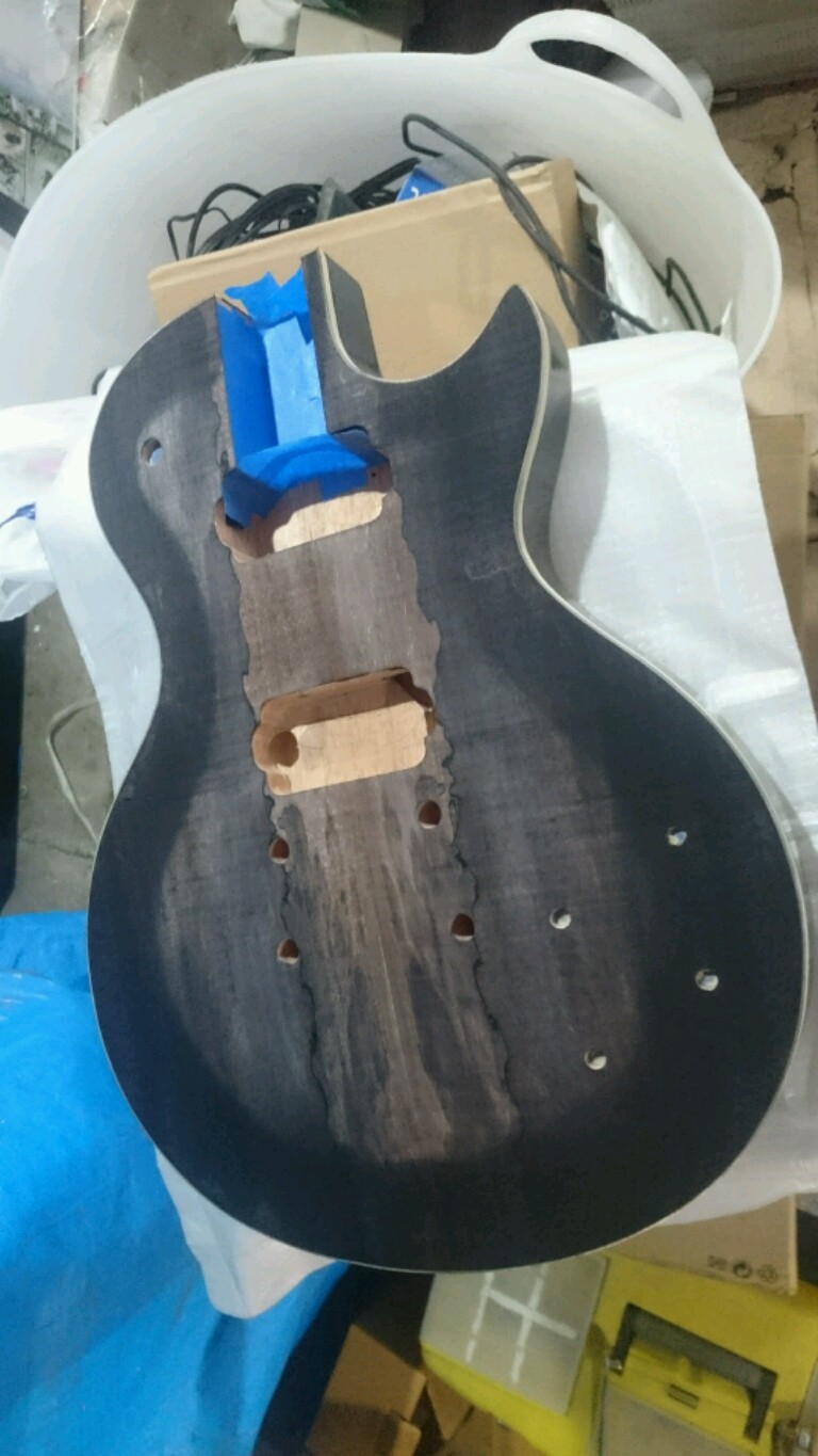

    After the colour I got started on the black burst on the top, first step was a light coat of black.

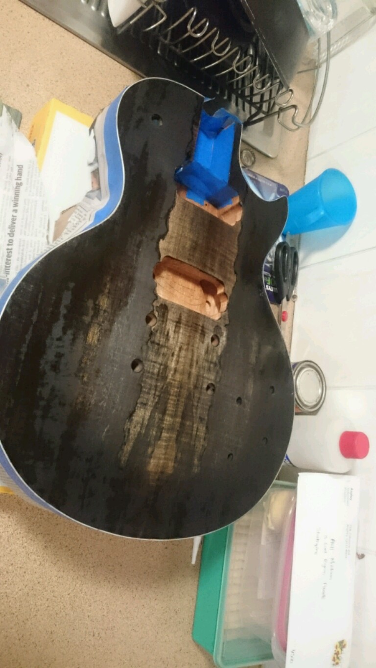

    After that had dried I darkened up the edges with a less diluted solution.

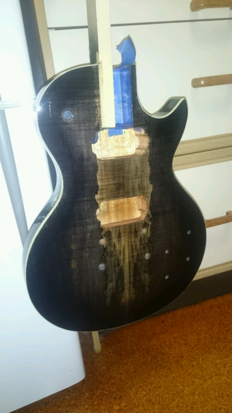

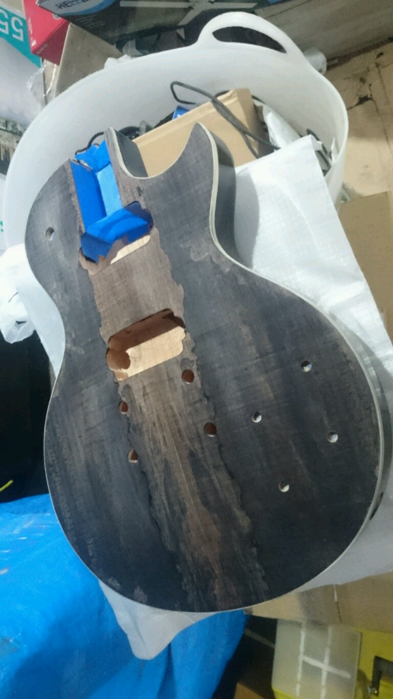

    Next up I started blending the fade with a solution diluted halfway between the first two.

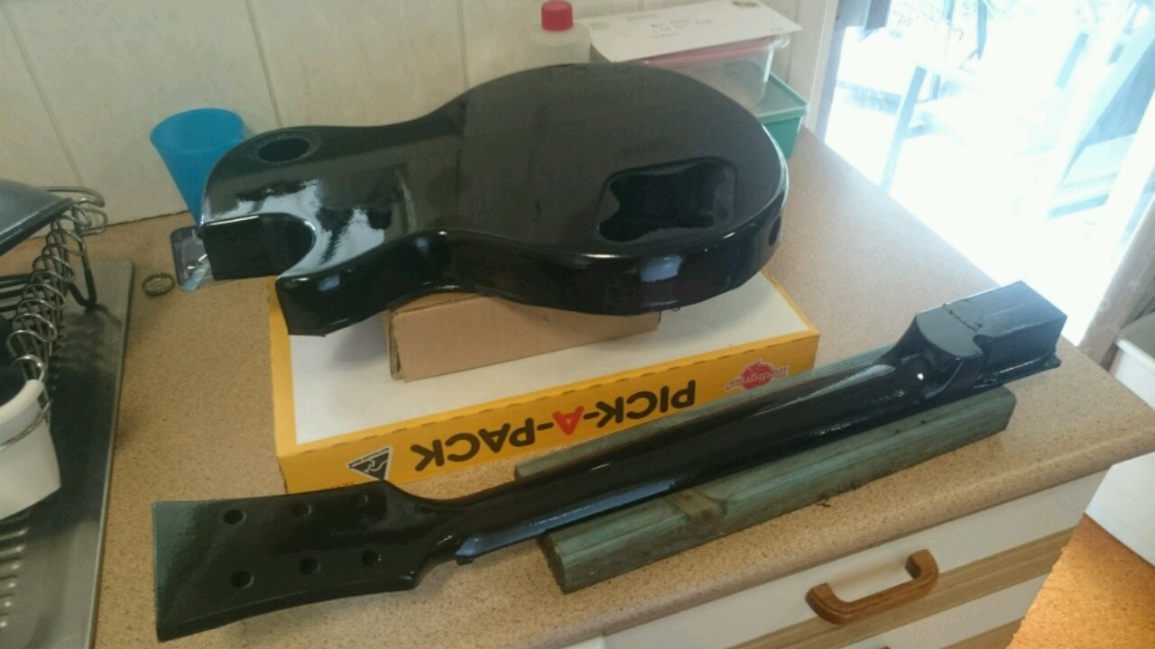

    After a bit of work with sandpaper to even it all out more I hit it with some sealer.Click image for larger version.
    And started building the clear coat.
ID:	10600Click image for larger version.

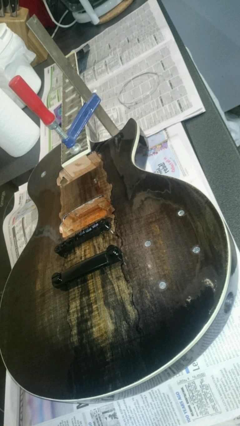

    Once that was all done it was time to attach the neck. This is a set neck so I glued it up got it in place and clamped 'er down.

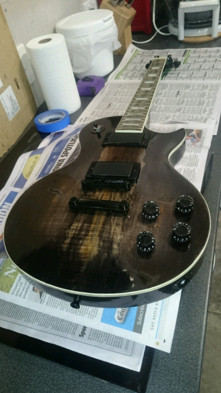

    After about 12 hours I threw some electricals at it and then left it another 12 hours before I strung it up.

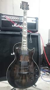

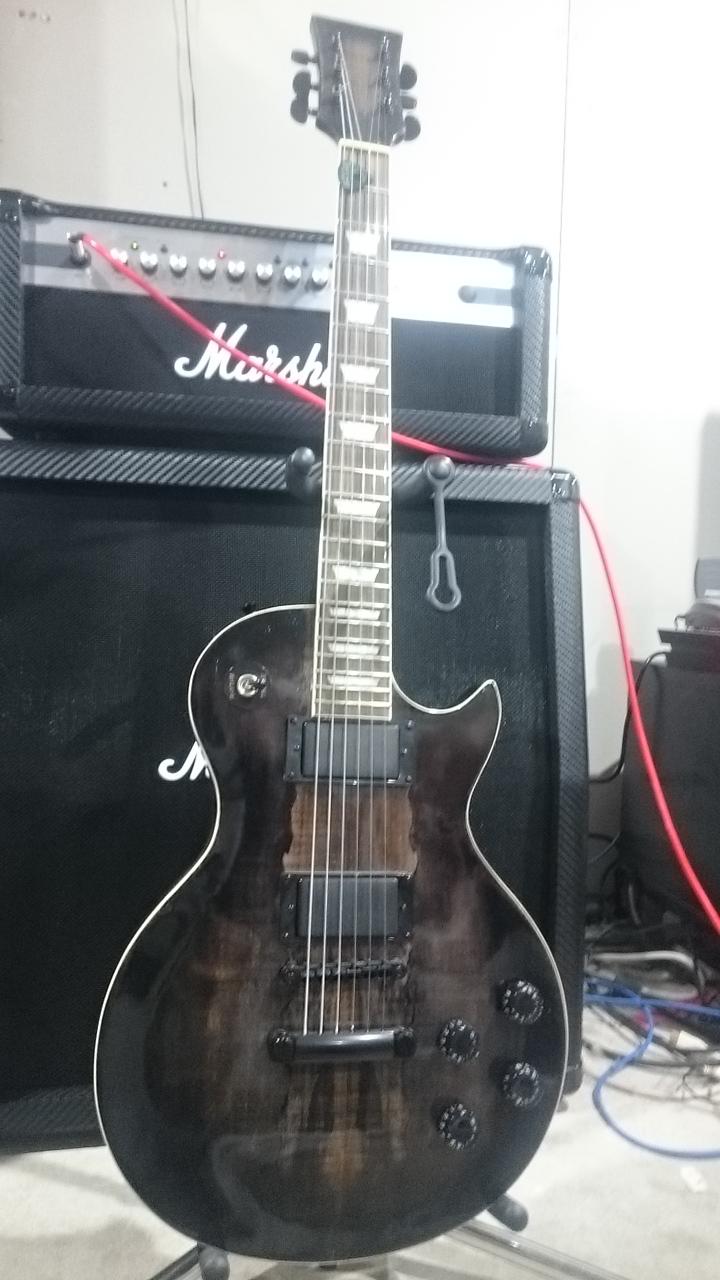

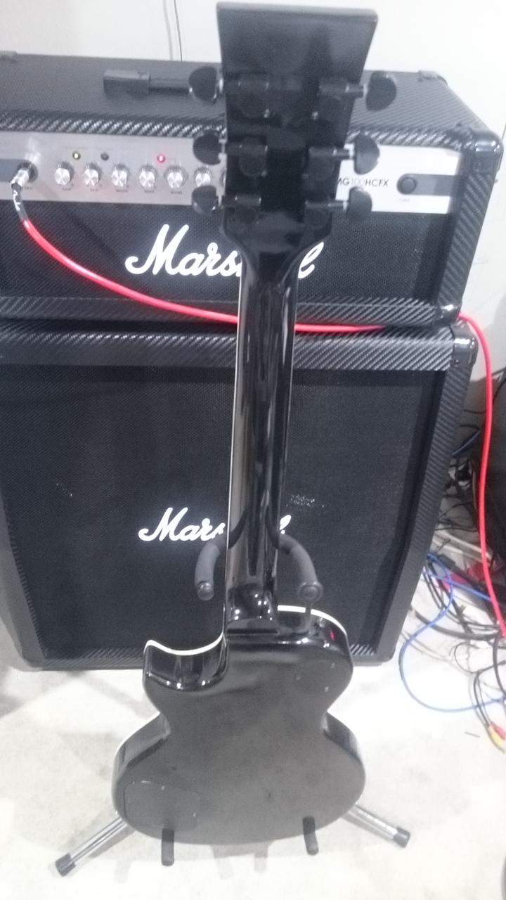

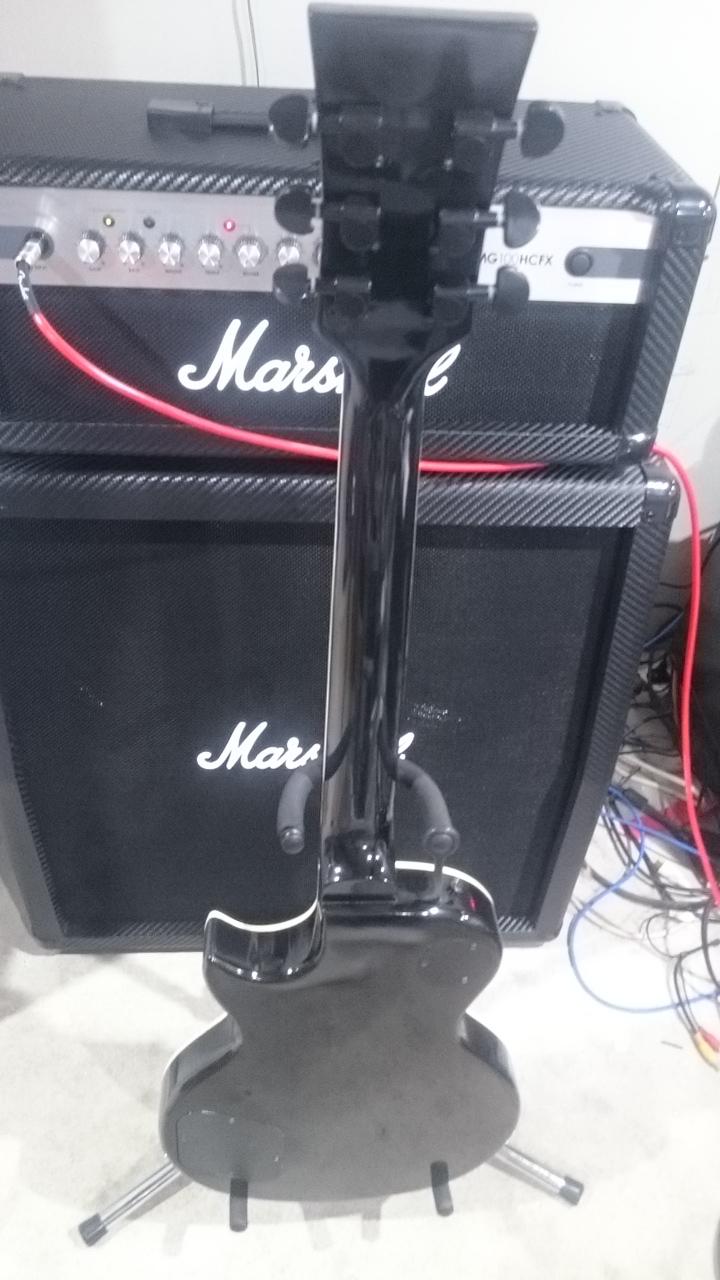

    And she was all done.
ID:	10604Click image for larger version.

    Thanks Mulldoe.
    If you don't mind me asking what stain/paint did you use and whats the finish?
    Its quite a nice combo
    Love the black burst Mulldoe - you really did a fantastic job! This is a beautiful looking LP man. The black really compliments the spalted veneer. Any chance of a sound demo?
    Thanks Mulldoe.
    Hi Andy, I used a Feast Watson black stain, Rustoleum gloss black rattle can and cabothane gloss polyurethane rattle can.
    Hey thanks Gav, I'm really happy with how this turned out. I actually have a condenser mic on the way from China, once it arrives I will look at doing a sound demo for this and my IB-1. It'll probably be in about 2-3 weeks.
