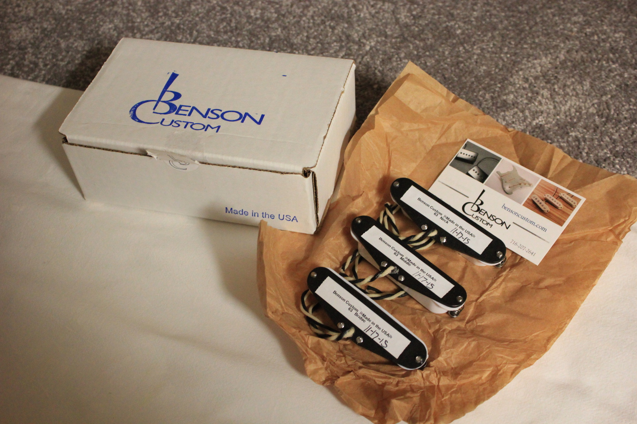

    The pickups came nicely boxed, with each pickup individually wrapped in brown paper and twine - a nice touch that added to the overall sense that this was a 'vintage' product. Nice.

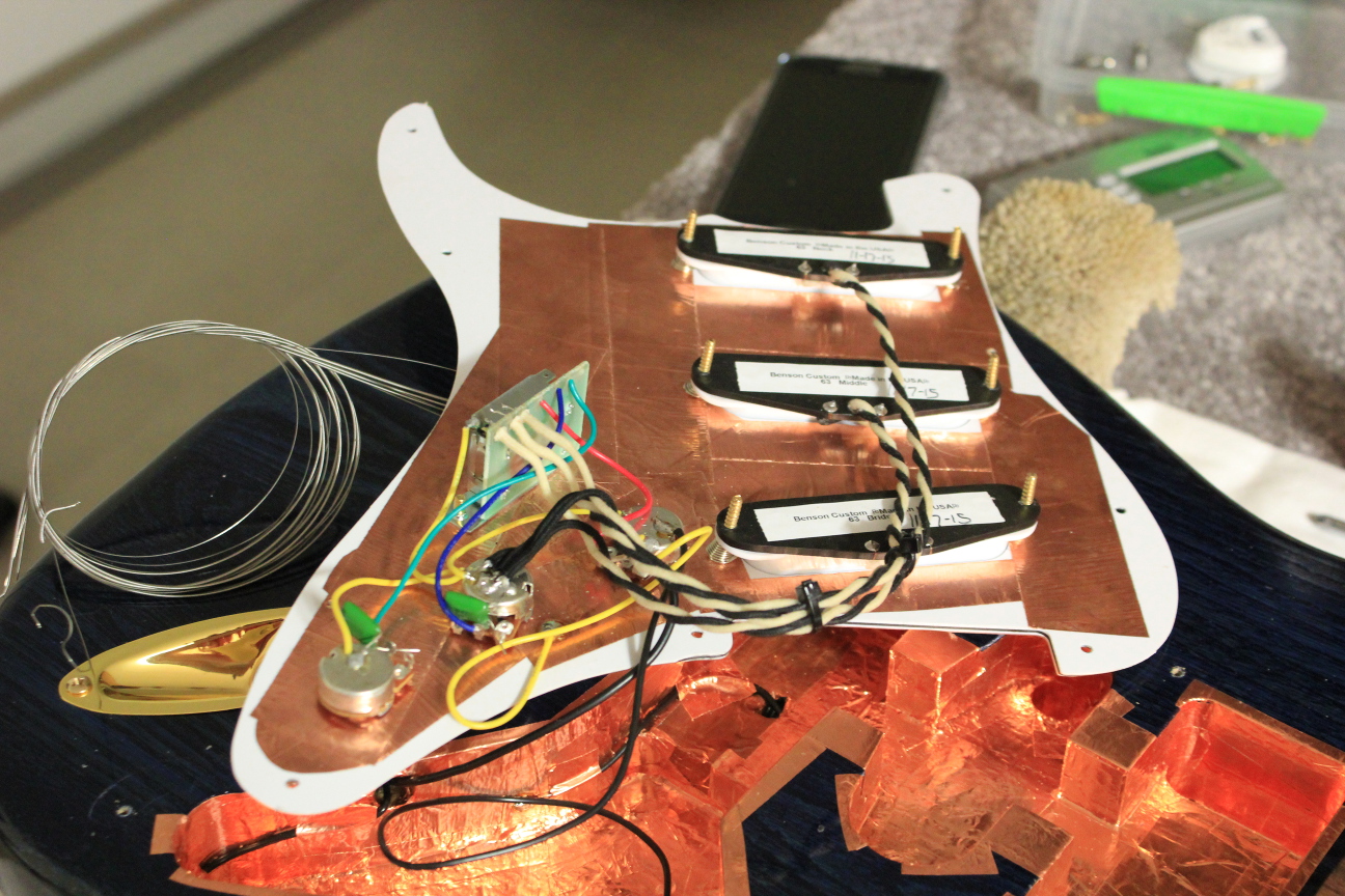

    Each pickup also comes with vintage, push-back cloth wire that is really stiff. It's solid, high-quality stuff and made working with the pickups very easy indeed. My biggest concern about the pickup swap was that I would lose my nice gold pickup mounting screws, but I should not have worried. The Benson pickups went straight into the pickguard using the standard Pitbull screws. Magic!

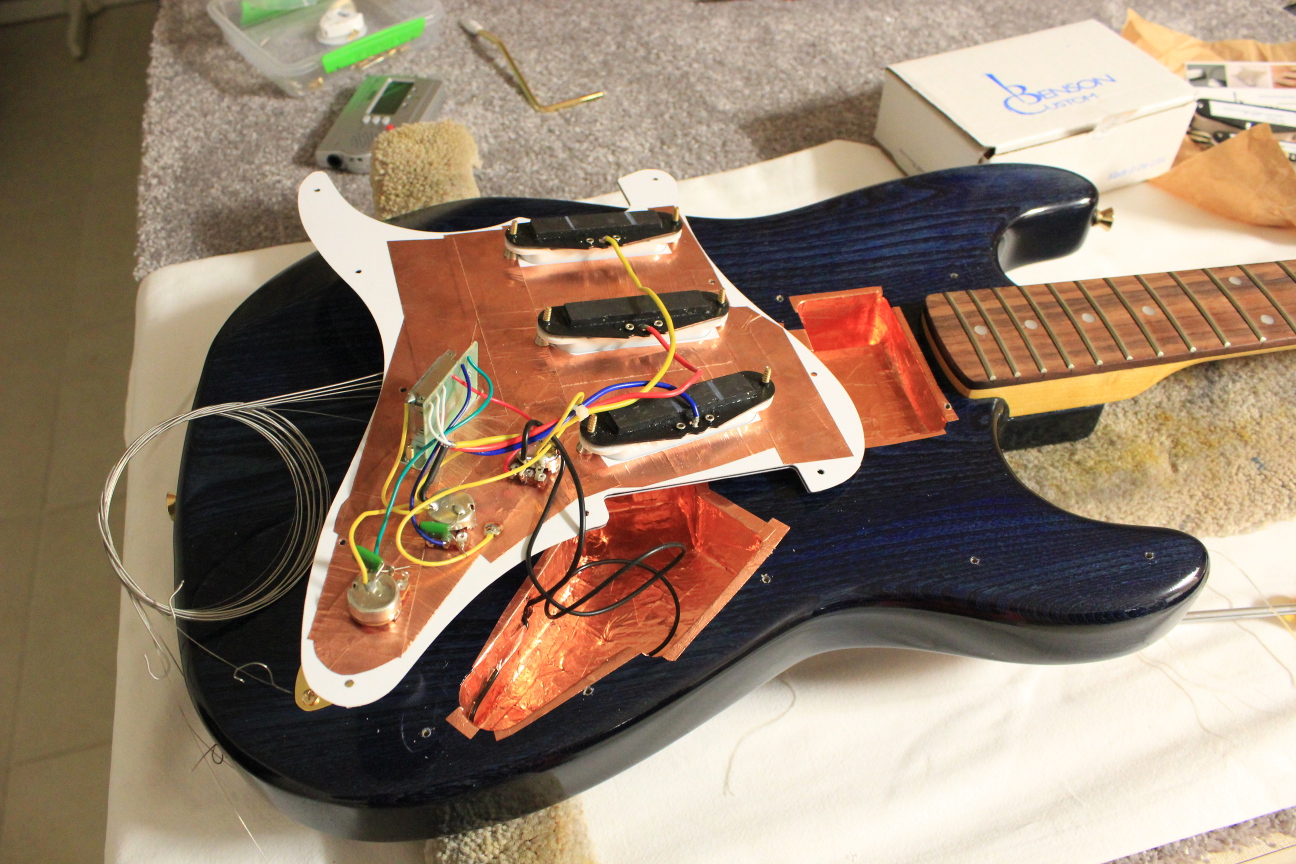

    Fortunately, strat wiring is very straight forward; especially with these import 5-way switches. With just the 3 hot wires to take from the switch motherboard, and a common earth to remove from the back of the first tone pot, the stock pickups were quickly removed and replaced.

    The push-back vintage wire made soldering a dream, with no risk of shorts in both the hot and earth wires. The stiffness of the wire meant that I could easily run all three wires down the centre of the pickguard to easily match the control route in the body. No messing around pushing wires back under the pickguard while I tried to fit it this time! I used a couple of zip ties to keep everything nice and neat, and trimmed the length of the middle and bridge pickup wires to keep them all the same length. A pretty neat job all up, and I am very impressed at how easy the Benson wiring made it.

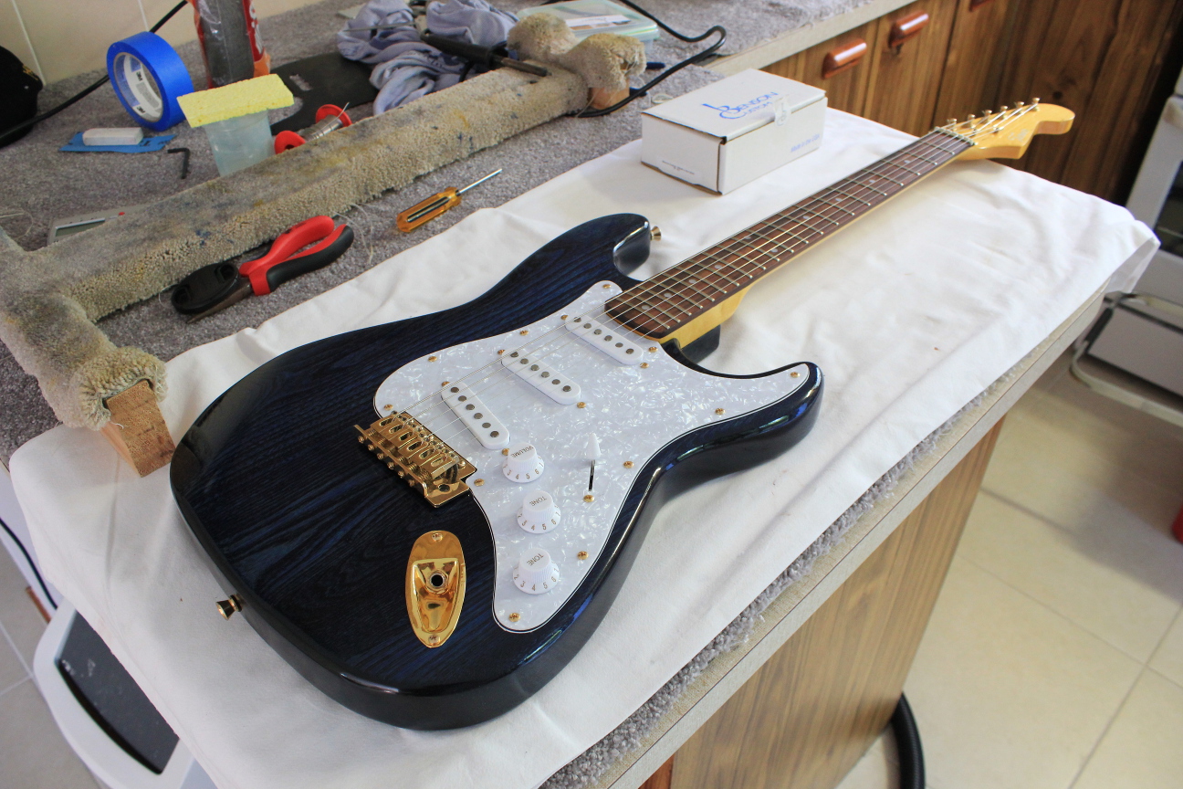

    With the wiring done and tap-tested to make sure everything was good, the pickguard was screwed back into place and she was ready to rock again.
