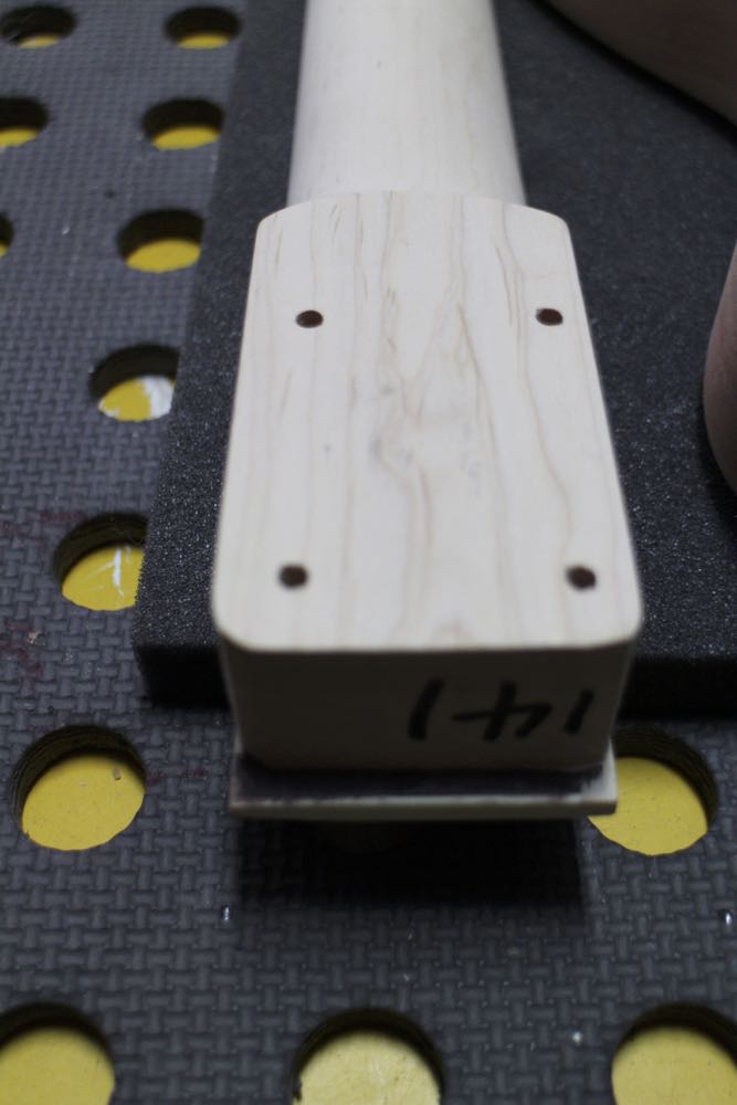

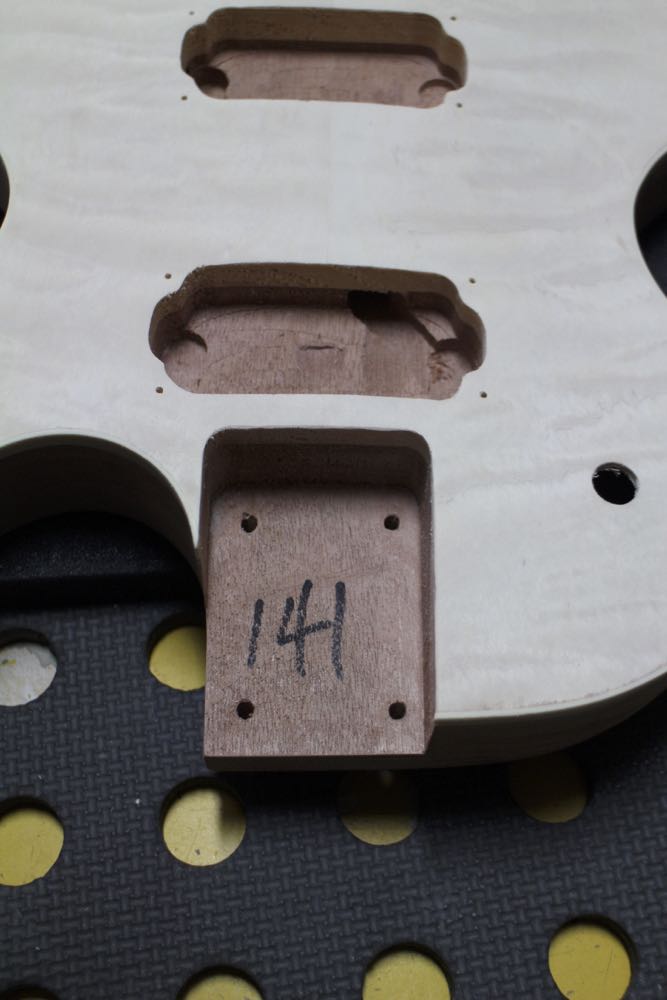

    Opened the kit and a looks good......and then......whats this Bolt On neck !!! check order form.....Yep ordered a glue in....
    So Question......Preference....Bolt on or Glue in......your opinions.....especially sustain....etc....
    will post some pictures.....
    plus need to add some photos of the latest stage of Ben's (my 13 year old) SG build......
    hey Bluesy, depends if you want to wait for the kit to be returned for a set neck kit.
    I think bolt on kit will sound about the same as a set neck kit and you have the option of removing the neck if you ever have to re-finish the guitar

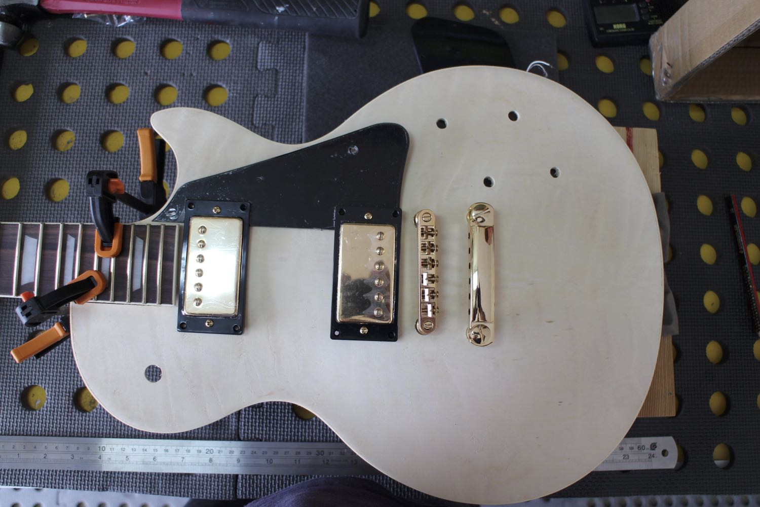

    Have done a quick mock build and like the action so will probably have to get some screws and a back plate as they are missing from the kit.....

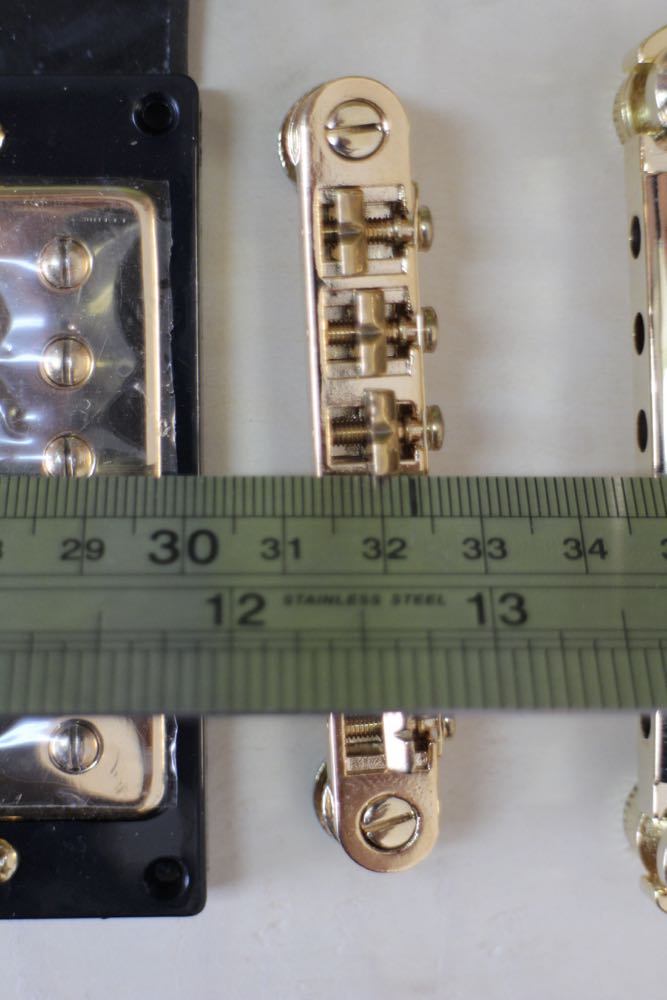

    1 question i have is the intonation.....i measured nut to 12th and got 313mm and yet 12th to bridge saddles was about 318 mm (See attached picture)...do you reckon i will be okay with this length given the string compensation required ????

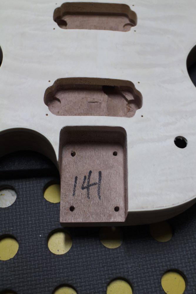

    anyway photos including the mysterious bolt on neck......I guess number 141 is gonna feel the wrath of god.....Click image for larger version.

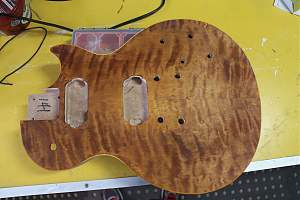

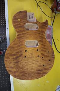

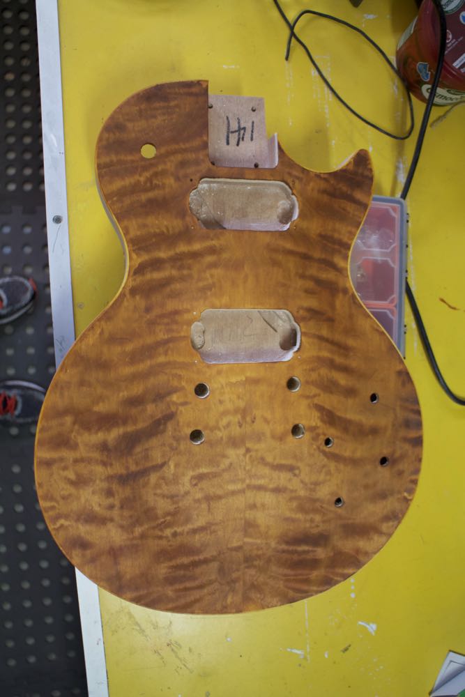

    So it turns out that i accidentally received a quilted maple LP not a flamed......Happy and thank you Adam for your help so far.....
    So got stuck into a little bit of light sanding and then thought....what the hell....time to try a nice golden teak stain with just a small drop of Jarrah thrown into the mix.....
    Pics to follow....
    Good stuff Bluesy, with your intonation the saddles have some forward movement so think you should be ok for intonation.
    This kit has pre-drilled holes so must have come from the 'other' factory.
    Golden teak on the quilt with jarrah should look excellent, look forward to pics !

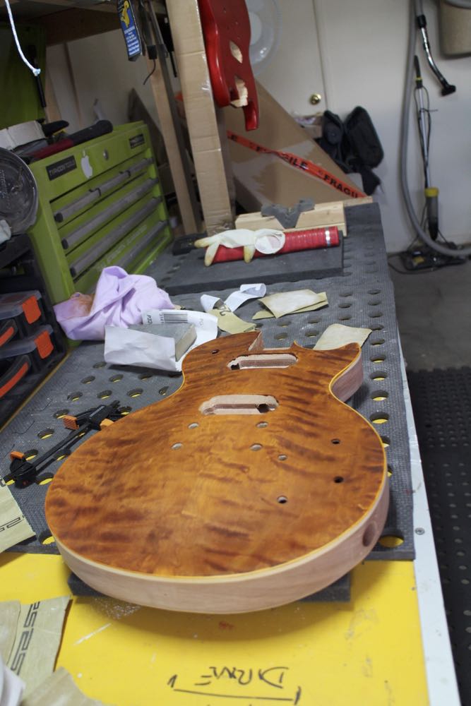

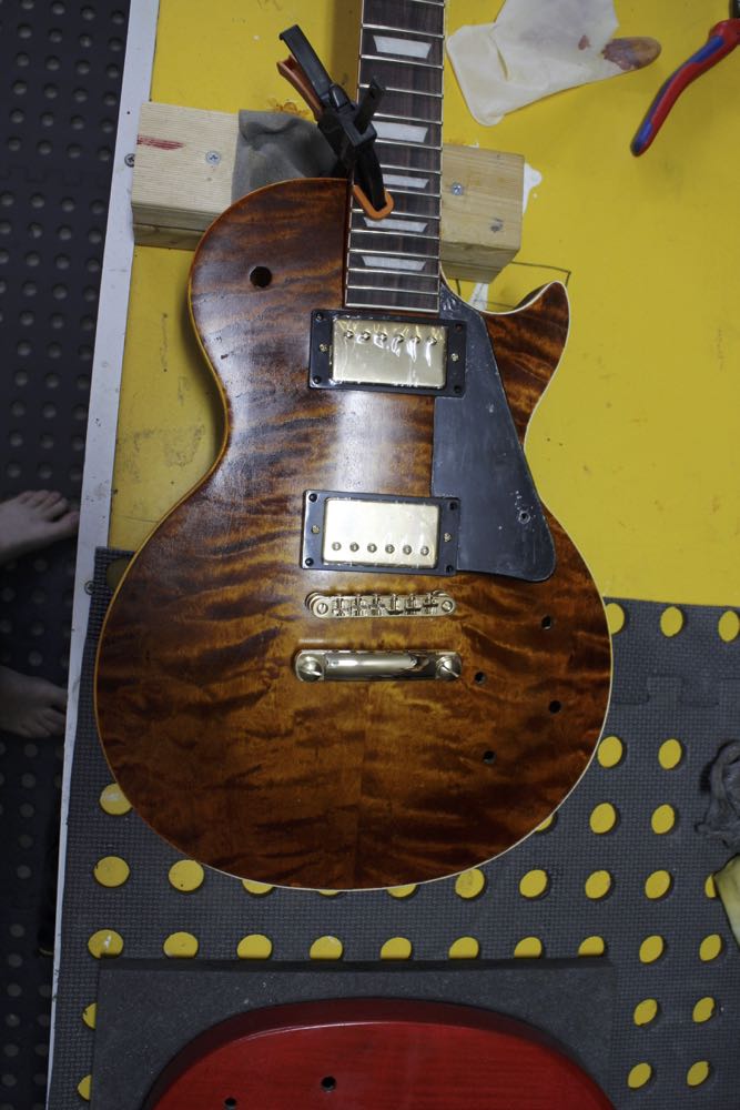

    Pics after following your advice WB.....fine sand with 320 grit....then 1 coat of F&W Golden Teak with a Splash of Jarrah for the top....and wow it sings to me.....Click image for larger version.

    wow that looks unreal Bluesy, wait till you get some TO over that will pop like mad !
    Member Fuzzbeard's Avatar
    Sep 2015
    Chinchilla, Qld
    220
    Wow that looks great! you've gotta be happy with that.
    Banned
    Dec 2015
    1,171
    Looks very very nice mate
    That will come up awesome after plenty of top coats.
