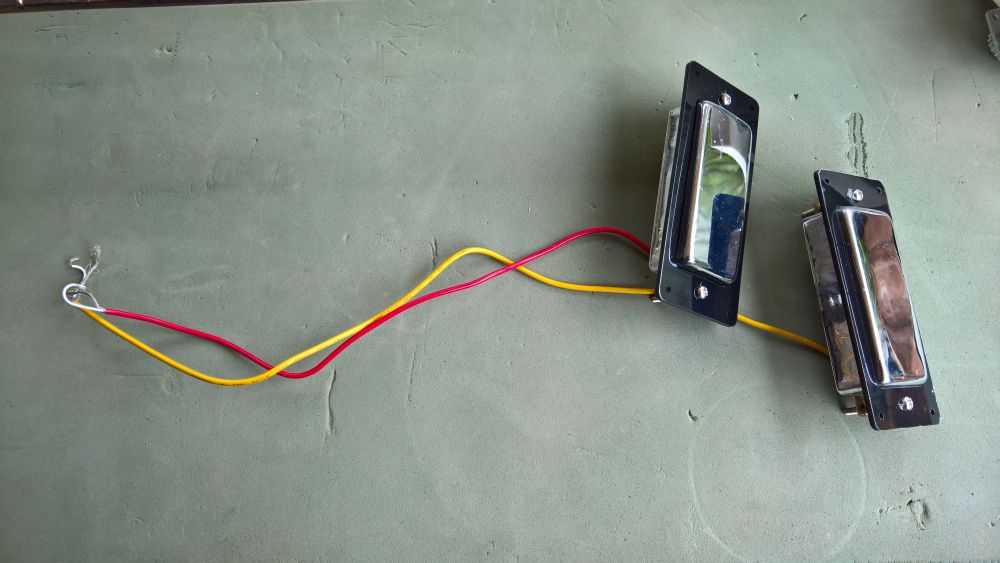

    Quick post - we've had the odd question about which is the bridge / neck pickup. For most kits, the easiest way to work out which is which is the length of the wires. Given the extra length that the wire needs to run to get to the cavity from the neck, the neck pickup generally has a longer wire. Here the pickups from my SGB-34, the one with the yellow wire is the neck, red bridge.

    good method Bman, most kits the neck pup wire is yellow and bridge pup red but don't rely on this, I've seen the colours reversed. Generally work on longest wire for neck pup as Bman points out.

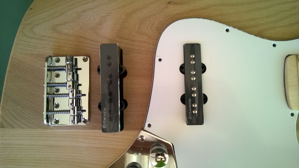

    The exception to this is the Jazz bass - the neck pickup is slightly smaller than the bridge - a couple of mm difference between them both.

    nice looking JB Bman ! Entwistle upgrades. This model you can see the control plate is between the pups hence wire lengths being similar
