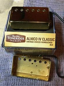

    I've got some upgraded Humbuckers that look like this...

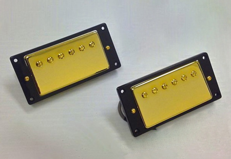

    And I've got some el-cheapo kit pups that look like this...

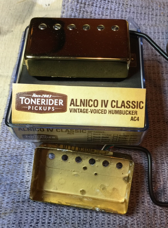

    Well, well, well...
    I couldn't de-solder them as my soldering iron couldn't get hot enough, so I just snipped the 2 soldered bits with side cutters and they slid off with a minimum of fuss.
    The poles on the Wilkinson were too far apart, but the Toneriders seemed to line up pretty well. In fact, they fit perfectly!
    The cover in front shows the tiny dobs of solder. I'll have to find my 40watt iron to re-solder them on. The 25 watter just doesn't cut it.
