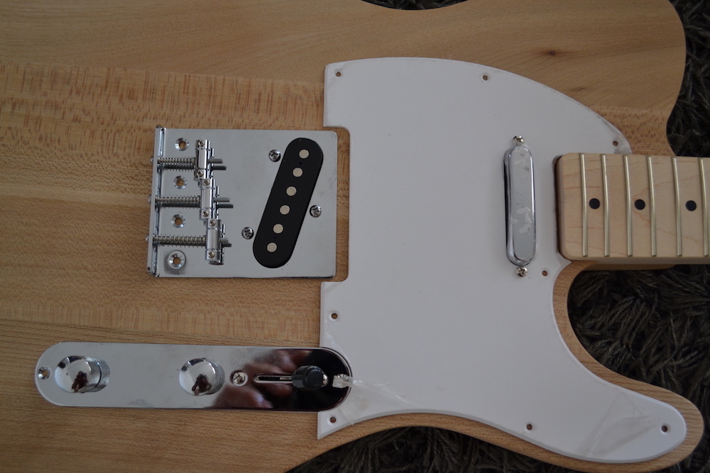

    hi my name is Derek, i have been playing guitars on and off for a long time. Really wanted to build one and after lots of you tube vids and reading on this forum and the pitbull website, i ordered a guitar.
    I ordered a TLA-1, my reason behind this was being my first guitar build i thought i'd start off with what seemed like the easiest.
    So it arrived and i got stuck into opening the box. my first thoughts were... i like it. The neck seem to fit ok.
    but i do have some concerns that i would like to ask you about.

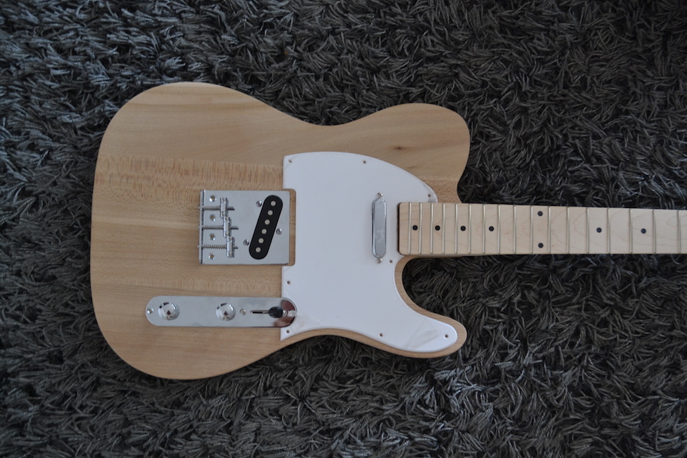

    the measurement from the nut to the 12 fret is 322mm, and the distance from the 12 fret to the bridge is 331 ( i know that the bridge is adjustable ) but if you see in the photo i would like to make up the 9mm were the gap is between the scratch plate and the bridge so its fits snug.
    Now here is where i want some advice... the bridge pick up is hard up against the neck side of the router hole. for me to make up the 9mm close the gap with the scratch plate and set the intonation i would need to router the hole more.

    Great first kit Derek. I have a build diary going for a TLA-1R and went into this issue a bit. I was considering routing the bridge pup cavity to move the whole bridge closer to the neck for intonation. In the end I changed/upgraded to a Wilkinson compensated bridge, which is shorter and used the Pit bull saddle screws, which are longer. That closed the over all gap for intonation and I didn't need to re-rout the bridge pup cavity. The Wilkinson allowed me to drill a string through as well.
    However, I did need to plug the old bridge mount holes and re-drill those for the Wilkinson.
    I am a complete novice when it comes to wood working and it took a lot of time, practice on scrap and measuring and re-measuring but it was worth it.

    in regards to the bridge, being the first build i think I'm going to just use what I've got in the kit and try to make it work.
    i will probably router the hole forward about 7mm and leave just a smaller gap.

    7mm seems a bit long? I thought it was about 5mm from memory. Maybe ask Wokkaboy (hes done a few) as I didn't end up doing it, in the end.
