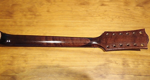

    Yep thin coats, a light wet sand 600 between coats, i put a tiny little bit of detergent in with the water and leave the paper in a jar, then go again, just using white cotton swabs and straight from the tin.
    I was hoping to get more done today but its too humid, i have 3 coats on the top and 1 on the sides and back, the neck is just about done, needs just a little more work

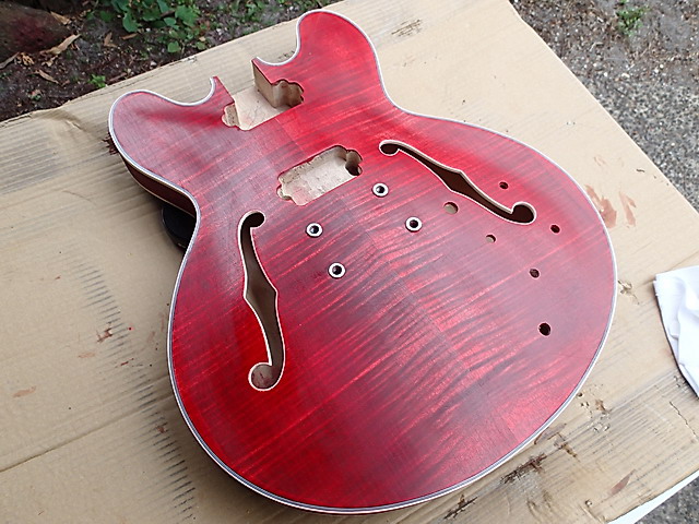

    And the body left to dry after its second coat, its looking real good after 3 coats, i am aiming for 5 then i will check it over again.

    looking good Tony, the body looks much more satin than the neck looks much glossier ?
    Banned
    Dec 2015
    1,171
    Body was wet there Wok, i used a gloss, being a satin man i thought why not change. Hopfully i can get some more done tomorrow andsome pics ,before i head of into the bush for the long weekend.
