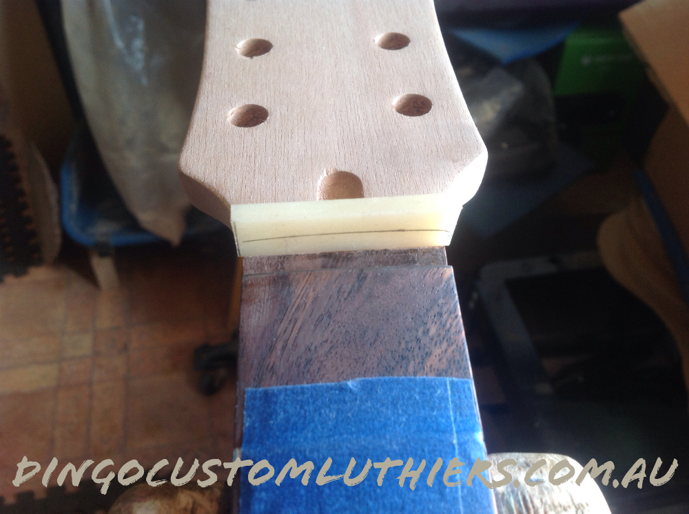

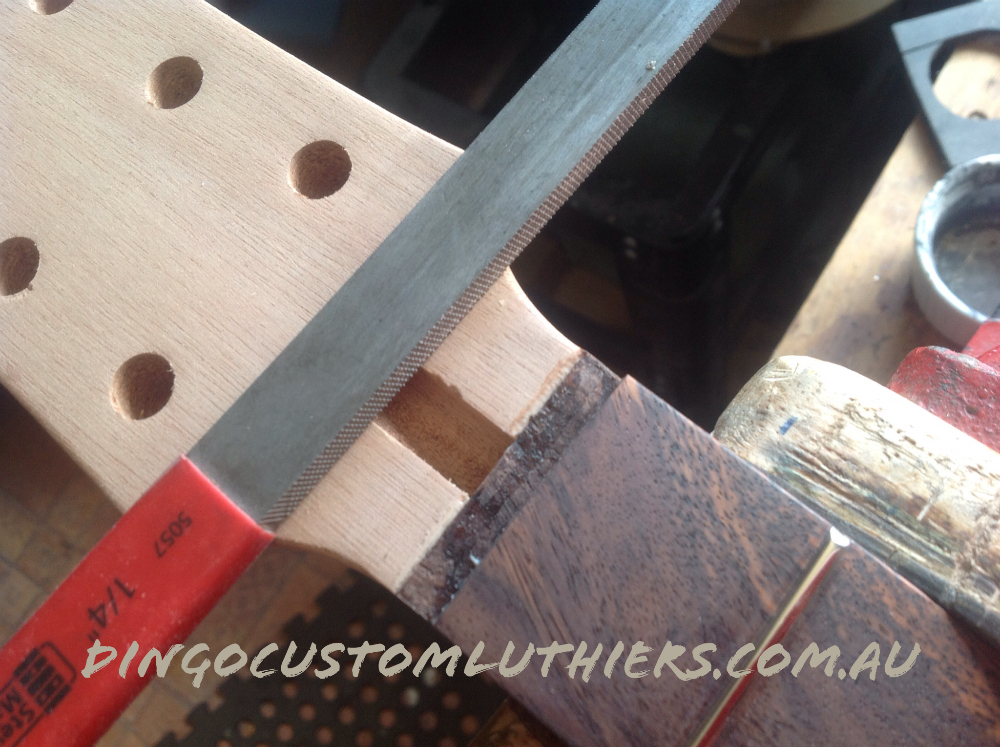

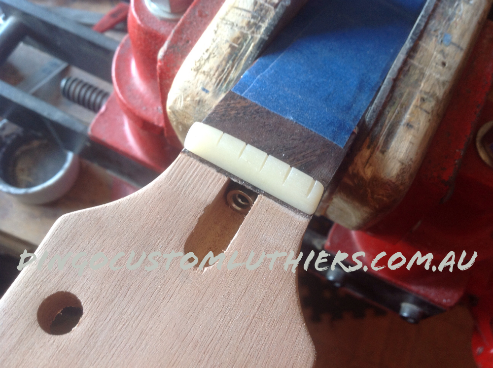

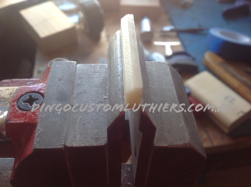

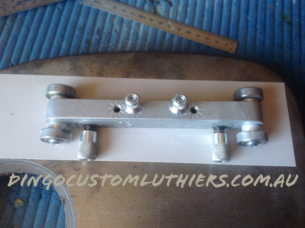

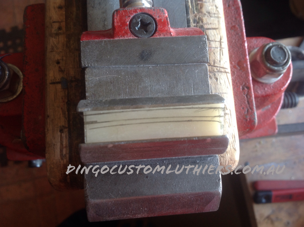

    This is what is involved in cutting a custom nut..
    1. Clean nut slot/ groove.
    Make sure you keep it square!
    2. Select nut blank, cut slightly longer than finished size.
    3. Break out favourite new toy... Ummmmm... Tool and mill bottom edge square.
    4. Mark fretboard height on nut
    5. Then mark fret height then string height.
    6. Begin cutting bevel on back edge before radius sanding the top profile.

    Moderator dingobass's Avatar
    4,491

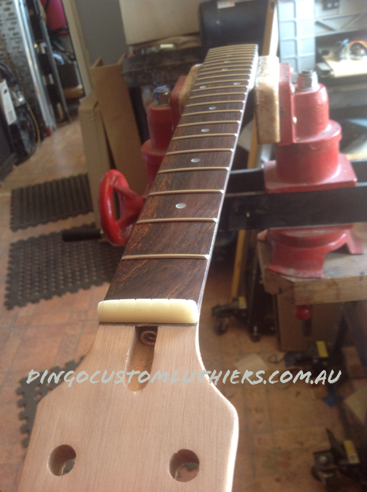

    7. Sand top edge with radius beam and check.
    8. Mark slot depth and cut slots.
    9. Polish bone nut
    10. This is what a fret replacement and custom nut upgrade neck should look like.
ID:	9288   Click image for larger version.
ID:	9289   Click image for larger version.

    Very very nice job, there's more to doing a nut than people think.

    Only step not there is 11. If you have the complete Guitar, final set up.. Action, string height etc
